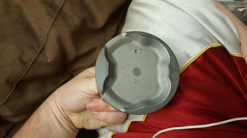

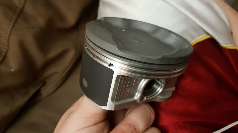

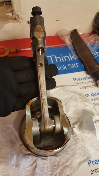

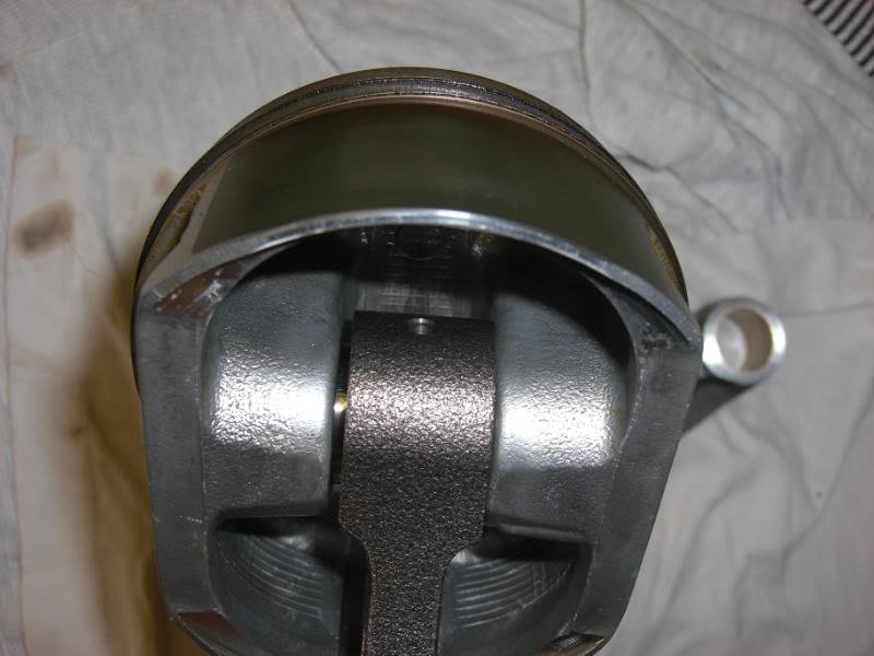

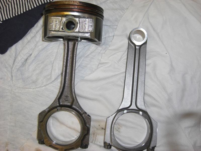

    Got a close up picture of the rods and pistons?

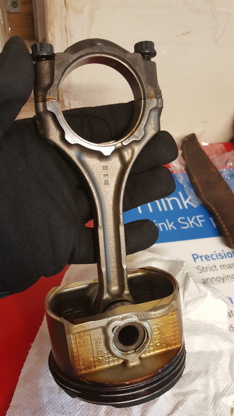

    Fresh pictures, just for you Tor
    Any specific shots you want?

    Pistons are of the same construction as the 1GR. Hypereutetic. The rods look much different in design.
    1GR OEM piston/rod next to Pauter.
    The surface texture of the oem rods is rough. Cast powder metal rods. Where as the forged Pauter rod is smooth.
    I do not know either way if the 2TR rods are cast or forged. I just want you to be certain that yours are. Before adding any significant power.
    Carry on good sir. :thumbsup:
