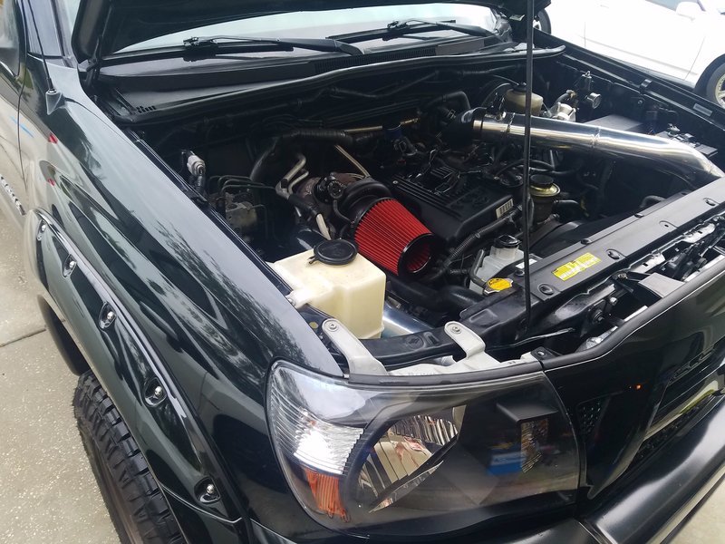

    Sneak peek at what I did today! It's probably not sized right because I'm posting from my phone but. . . Screw it.
    boostedka, ChadsPride, Torspd and 4 others like this.

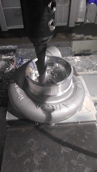

    Took a a knife to a brand new Garrett cover . The taco is now running a hybrid GT3071R because I thought the last turbo looked dumb. Modified the insert and now the truck sounds like a jet!

    If you don't mind Kirk, could you explain what you did exacltly, and its purpose? You've gotten my gears turning.

    It looks as if he machined a lot of meat out of the inducer inlet. Probably gaining a few MM as well as creating a straight shot to the inducer, rather than the 'velocity stack' type of shape that most turbos have.

    Attended the local tacoma world / Florida tacoma meet today, cleaned her up for the drive. I'll post note details on the compressor cover modification when I get on a computer

    That engine compartment looks way better with a turbo in it :thumbsup:
    Can't wait for mine!
    Any chance you are gonna figure solutions for a larger fuel rail/ high flow injectors?

    That sound is due to the compressor cover modification we made. It's much louder in my Subaru, I didn't want to make the truck as loud
