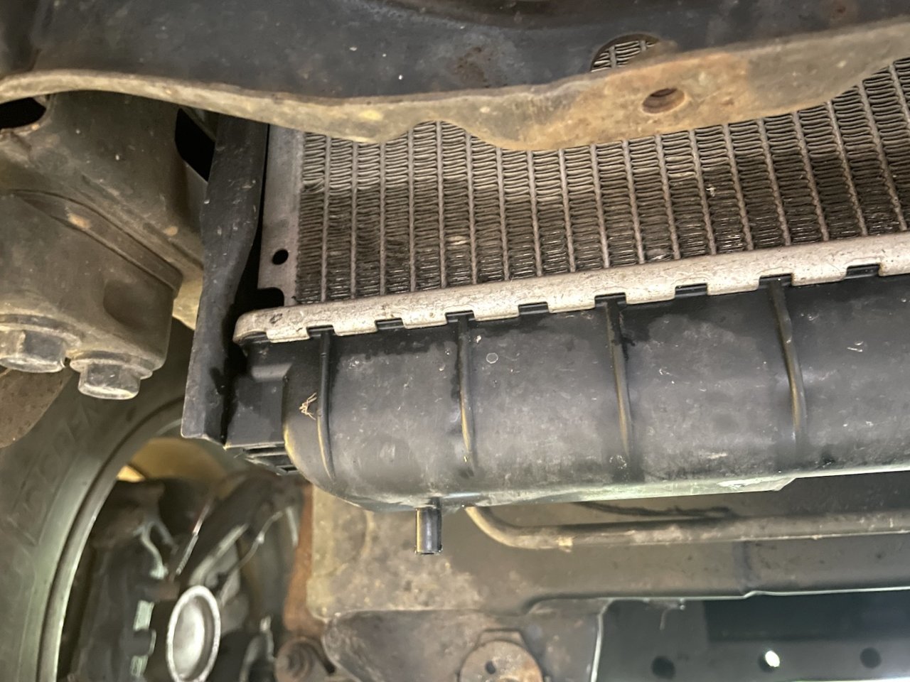

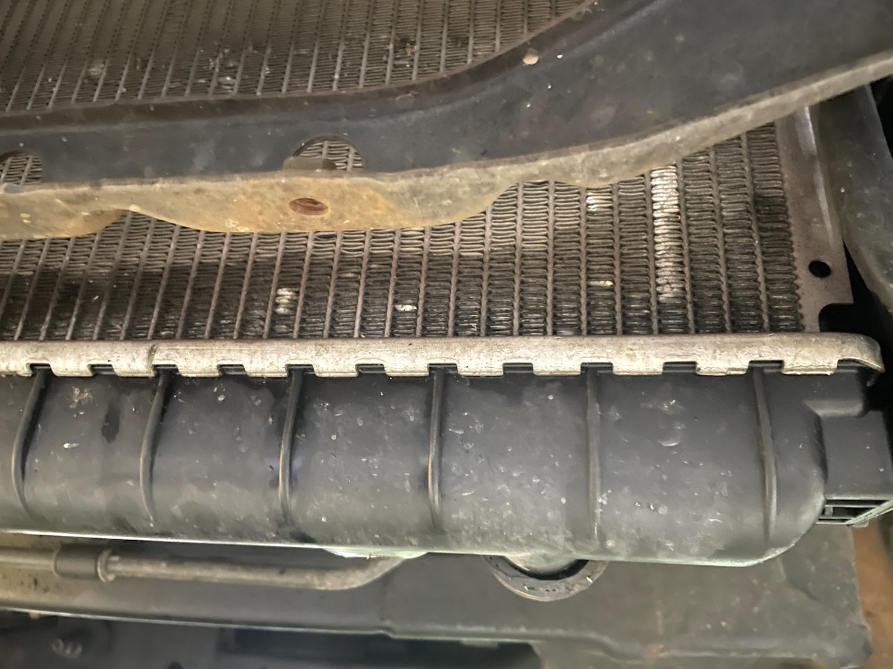

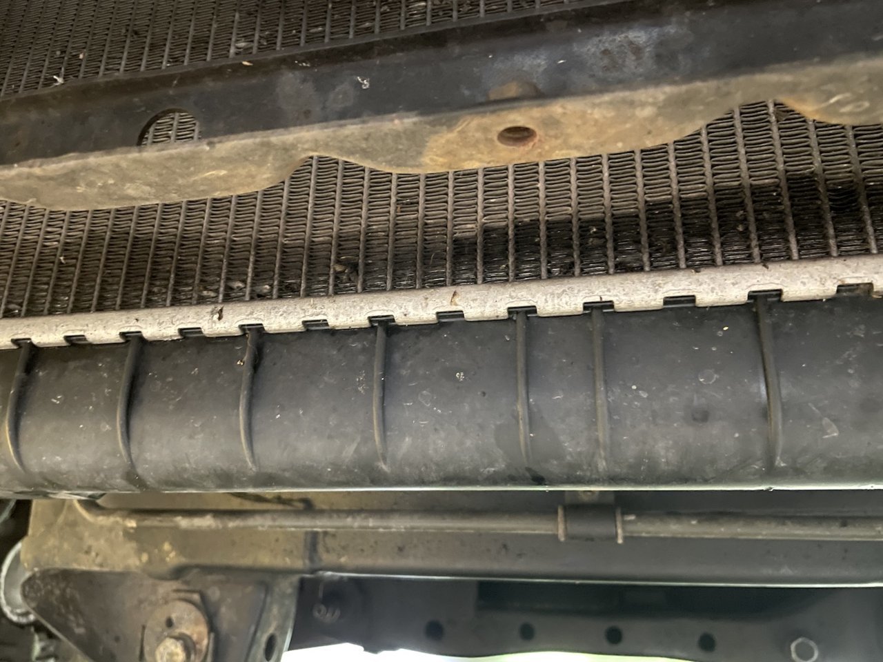

    While doing an oil change I noted the bottom plastic tank seemed ... moist. And so I started looking at what I could see of the fins. The bottom of the fins are all wet.

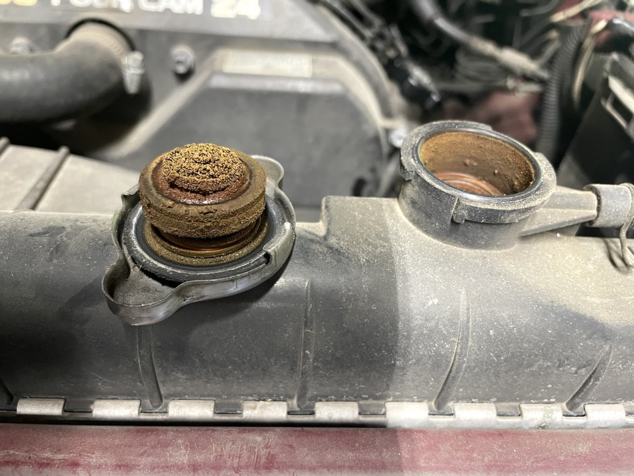

    And as an added bonus, I noticed the cap had begun to rust.

    That rust doesn't look good, might wanna block test it too

    I also think it's a safe bet that rust is only from the old cap. I likely ran it with too-high of a water mix since last time.

    X2 with this idea,
    You definitely have not been taking care of your cooling system with that much rust showing.
    You definitely need to get as much rust out of your system, draining it will get most of it but there will
    be plenty in the block and in the heater core.
    Maybe drain everything and refill with water a few times running it hard to get the water
    moving through before replacing the radiator.
    All that rust is made up of lots off metal particles coming off the block that are flowing in the system and actually act like sandpaper going through the aluminum heads wearing the aluminum down.
    I’ve seen photos of the aluminum heads of the water jackets area actually worn completely through the heads from rust in the antifreeze.
    Went rust is this bad from neglect it’s probably impossible to get it cleaned.
    I would say from here forward flush your system every year and expect or replace the radiator again at sometpoint because of the amount of rust that will continue grow and to haunt your system.
    Rust never sleeps and doesn’t just disappear once it’s set in
