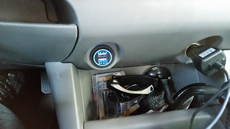

    Just completed my own USB swap out, I was tired of those little adapters not providing enough amp to charge everything, and I didn't need 2 cigarette lighters. Since the circuit was already there and the hole was already present. I pulled my dash apart, and removed a cigarette lighter. Reamed the hole a little with my dremel to fit the socket. Instead of rewiring the factory "L" plug, I used my dikes and simply cut the plug itself at the joint and plugged it onto my USB socket. In all took about an 2½hrs, and a $14, Cllena Dual USB charger socket power outlet from Amazon. I think it came out looking clean.
