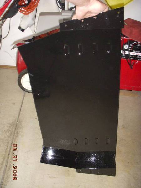

    I finally finished an armor plate for my catalytic converters (more of a theft prevention than skid plate).
    Here's the finished plate (unmounted) coated with POR-15. I added louvers so air could keep moving across the cats. The louvers point towards the front of the truck so they grab air . . . not suggested if you're going to offroad and hit rocks and such. It's made of 16GA CDS as that is the thickest material I could get louvers put in at work. I would have liked to make it out of thicker material but after the bolts are tightened, it's solid.

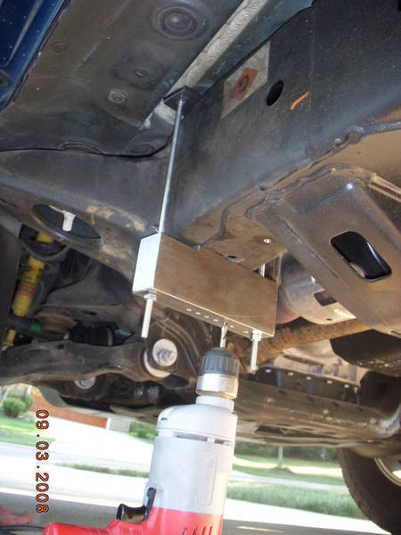

    Below is the drill jig I used to keep the tap drill perpendicular to the frame:

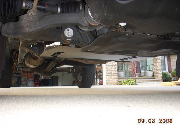

    Here's the stock location without the armor plate:
    Here it is mounted on the truck with 1/4-28 stainless steel screws:
    Here's a view of all the armor/skid plates under my Taco. Top right is the factory skid plates, followed by the cat armor plate, then in the back my fuel tank armor plate.

    I mounted it a week ago and have been testing it since. My main concern was heat. When the vehicle is moving, it cools very well. When the truck is sitting, it gets warm. I say warm because you can put your hand on it for about 5 seconds before it gets too warm for comfort. I estimate that that is about 150 to 180 degrees or so. I may put some temp dots on it to see what the temperature really is. It gets warm only in stop and go traffic or sitting at idle for a while. Once the truck moves, it cools quickly. The plate is about 3" away from the lowest cat (on the drivers side) and further on the passenger side cat. The drivers side cat is significantly closer to the frame and cross member than it is to my plate so they definitely get warmer than my plate does. I thought of putting some reflective material on the inside of the plate but I didn't want to reflect that heat up towards the cabin. Also, the plate is black which doesn't reflect anything. I guess I'm telling you all this because I want some feedback as to whether you all think this is detrimental to the cats or not. I placed the louvers directely under each cat so I think that I'm actually helping to cool them, but you tell me. I have a drawing of the plate if anyone wants that too.
    Thanks for reading all this and tell me what you think . . .

    Update: Well I ended up making a 1/2" spacer plate to move the plate farther from the cats and to move the louvers farther into the air stream. The plate is still not lower than the cross members on either side of it. I'm waiting for the coating to dry on the 1/2" spacers and then I'll mount them.

    The design is open in the back and shortening it between the plate and the cross member would allow any grass that enters to just be blown to the back of the plate and fall out the end of it.
