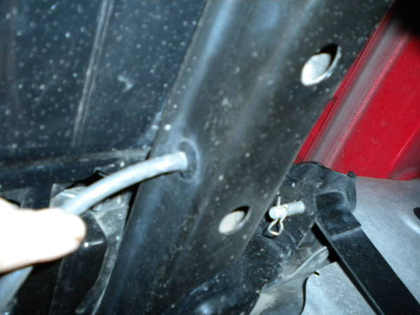

    Found this small mystery hose hanging in the vicinity of my fuel tank. Pic is taken from behind the rear axle looking forward. Anyone know where it belongs?

    well i know the wires right by it are for the abs if i remember correctly

    maybe a gas tank breather :notsure:

    looks like some type of breather.....
    maybe someone here with a 2nd gen can go look.
    like superx2 said it looks like a gastank breather, the length is about right

    My guess is a vent line for the fuel tank. Can't find where it fits though...

    The end of that hose goes into a hole just forward of there in the crossmember. I'm not positive but it might have something to do with the charcoal filter/cannister right above there.

    thought this might help....my finger is on the hose and as you can see it goes through a grommet on the crossmember.

    Can you see where the end connects?

    It looks like it goes into that hole about 3/4" and stops. I felt the end of it through the hole on the bottom of the cross member and it appears to be open...must be some sort of vent tube.

    That's for youdr e locker motor breather in the pictures above that grommet I mean. I don't believe you two are referring to the same hose

    Disregard my last. Trying to remember the routing didn't work. Hose comes from locker motor and connects to grommet at cross member
