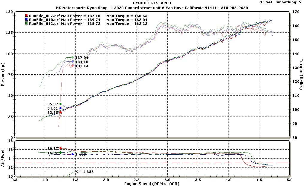

    These are my latest 2.7 dyno runs from the muffler shootout...
    RED: Stock
    BLUE: Magnaflow
    GREEN: Flowmaster
    One suprizing piece of new information is that a multi-chambered Flowmaster Series 50 Delta flow muffler outflowed a straight through 2.5" core Magnaflow muffler.
    This puts to rest the myth that straight through is always better than chambered.
    Flowmaster has incorporated some really clever precisely positioned accoustic tuning and anti reversion features that enhance the exhaust scavenging enough to outperform a straight through perforated core. This is totally counter-intuitive that exhaust gases taking complex indirect routes through chambers and around baffles could actually flow faster than freely flowing directly through a simple open tube.
    And I found out something else. The Flowmaster Series 50 Delta Flow also lowered the torque peak by 100 rpms. While this is not much, it was done just with a muffler, and assumes more significance in combination with the other bolt on mods which have lowered the torque peak by 1,000 rpms from the stock 3,800 rpms down to just 2,800 rpms. This is a 27% improvement.
    We've also been refining the dyno technique to get really good low end runs that begin recording as low as under 1,000 rpms by gently rolling on the throttle at idle in fourth gear instead of abruptively stabbing it at 1,500 rpms. My interest is only in low end torque so it doesn't matter that the speed limiter cuts off the tops of the runs.

    Next mod: some for of ecu to fix the lean AFR issue.

    What product will do that? And if it does, will it yield more low end torque? :)

    Any tuning device. Simplest being the MAF-Cal.

    Unfortunately, my engine remains in closed loop mode under 4,500 rpms regardless of engine load or throttle opening.

    You should speak with Gadget then. I know that the MAF-Cal can do some closed loop tuning. If it is possible, it would be good to get it down to the 12's at 100% load
