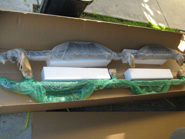

    They package it really good with bubblewrap and foam blocks

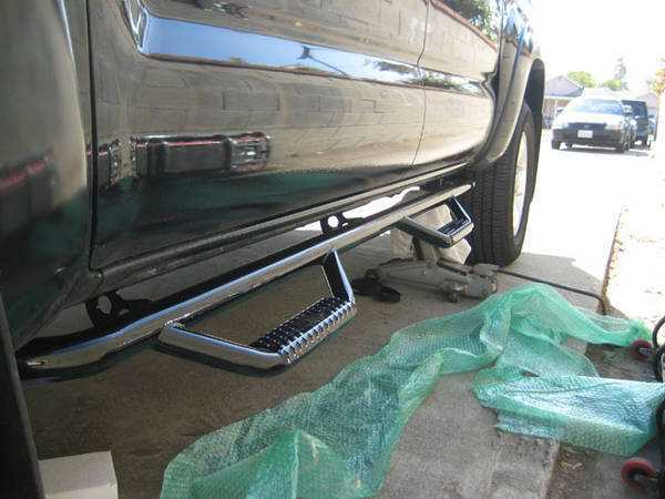

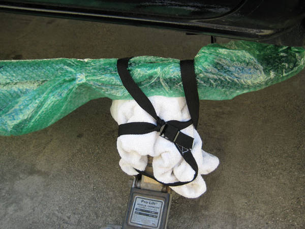

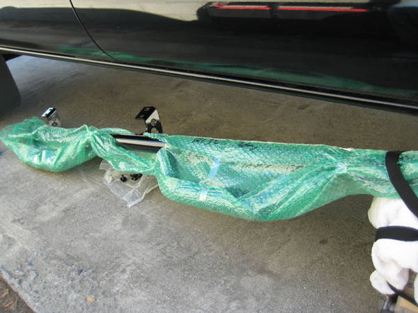

    Getting it set under where it will be mounted.
    Since i was working alone, i used a jack to help me.

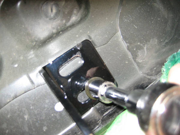

    each side of the n-fab has 6 holes. On the doublecab like mine, use only use 5 of the holes on each step. Thanks to Justin626 for pointing that out in a previous thread.

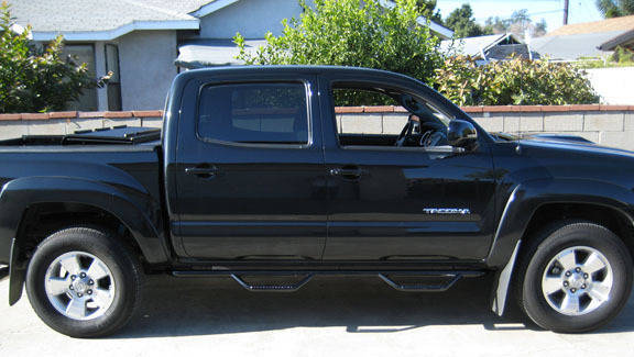

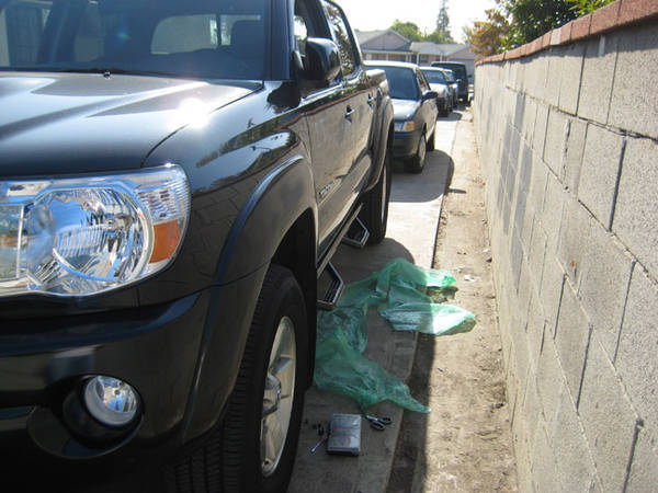

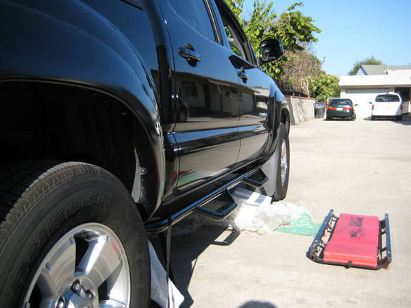

    Left side installed.
    as you can see there is a larger gab between the cab and step with the 2" maintube but still looks good. the very front end where the tube bends does fit up against the cab rather snug if not too snug where over time it will most likely chip the powdercoat.

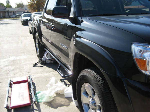

    Right side installed.
    Right side back view

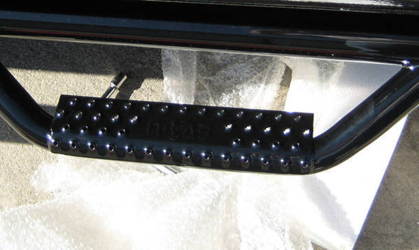

    As you can see the step pad does have the geniune "N-Fab" logo. trust me when i say the metal step pads on the nfab are way better than those plastic ones. and the grip is sturdy.
    Full side view
