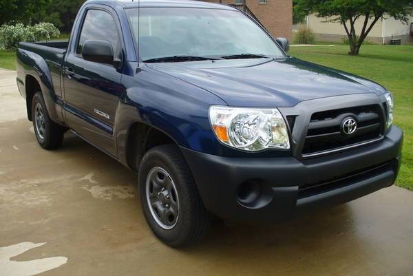

    Ok - here's the thing:
    When it comes time to get my Taco, it's probably going to be a 4x2. From what I've seen (online and in person), 4x2s aren't much higher than this (right off the lot):
    Now, all of the Pre-runners / 4x4's I see are a bit higher - like this:
    It may not seem like a big difference to some of you - but for some reason, I see that as a pretty big difference. The access cab above would be perfect, in my opinion.
    How would I go about getting a 4x2 (access cab) like that? Where would I take it? What would I need to get?

    I think the first one is a 5 lug Tacoma, and the second is a prerunner, all prerunners come like that....5 lug sits a lil bit lower..... please correct me if i am wrong....

    From what i know........the prerunner has the same suspension setup as the
    4x4. The 5 lug tacoma is/looks significantly lower than the prerunner and the
    4x4

    Suspension geometry is different on the *mini*
    They have a sprung-under rear suspension versus the spring-over on the Prerunner.
    Also - don't the *mini's* come with a 2.4L engine on the 4cyl? Versus 2.7L on the Pre-runner. You can't get a 4.0L in the mini.
    PhoenixCadet - definately get yourself a Pre-runner version (or 4x4). It'll cost a little bit more than the mini - but you'll be much happier.

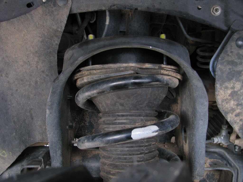

    Converting a "mini" to PreRunner suspension isn't difficult. You will nee to get taller spring OR blocks for the front, and "flip" the rear suspension as Janster pointed out. This means that the leaf springs (long metal springs shaped as an upside-down arc) have the axle (power from the engine to the wheels) mounted on the top (or inner side) of these arc'ed springs. Theoretically, all you have to do is disassemble the rear suspension system and remount the axle underneath the springs instead of on top. However, there are gas compression shocks underneath that will either require an extension, OR be replaced (~$50-$80 each). This is also true of the front suspension.
    One major thing to consider when "pumping up" a mini...
    Mini Tacoma are made to be small efficient trucks. Therefore they have a lower rear differential gear on the rear end. This allows them to spin the engine less to maintain a constant - usually highway - speed. This is especially true of the automatics. If you raise the truck, you will inevitably want to get larger tires. These tires increase more over the efficiency of the engine at highway speeds. HOWEVER - they will also GREATLY hurt your acceleration. This means that you are putting more load on the engine to move the vehicle without adding any weight to it.
    In my humble opinion , the only two reasons to raise a 'mini' to PreRunner height instead of just getting the PreRunner are to get the automatic transmission (which requires quite a bit of work when all is said-and-done), or to make you own PreRunner on a budget over time (which requires money and know-how). Honestly, I would just go with the PreRunner if that is what you like. If the Automatic is a must, then consider the V6. It doesn't sound like a complete remodel of a new truck is something that you are ready to dive head first in. ;)

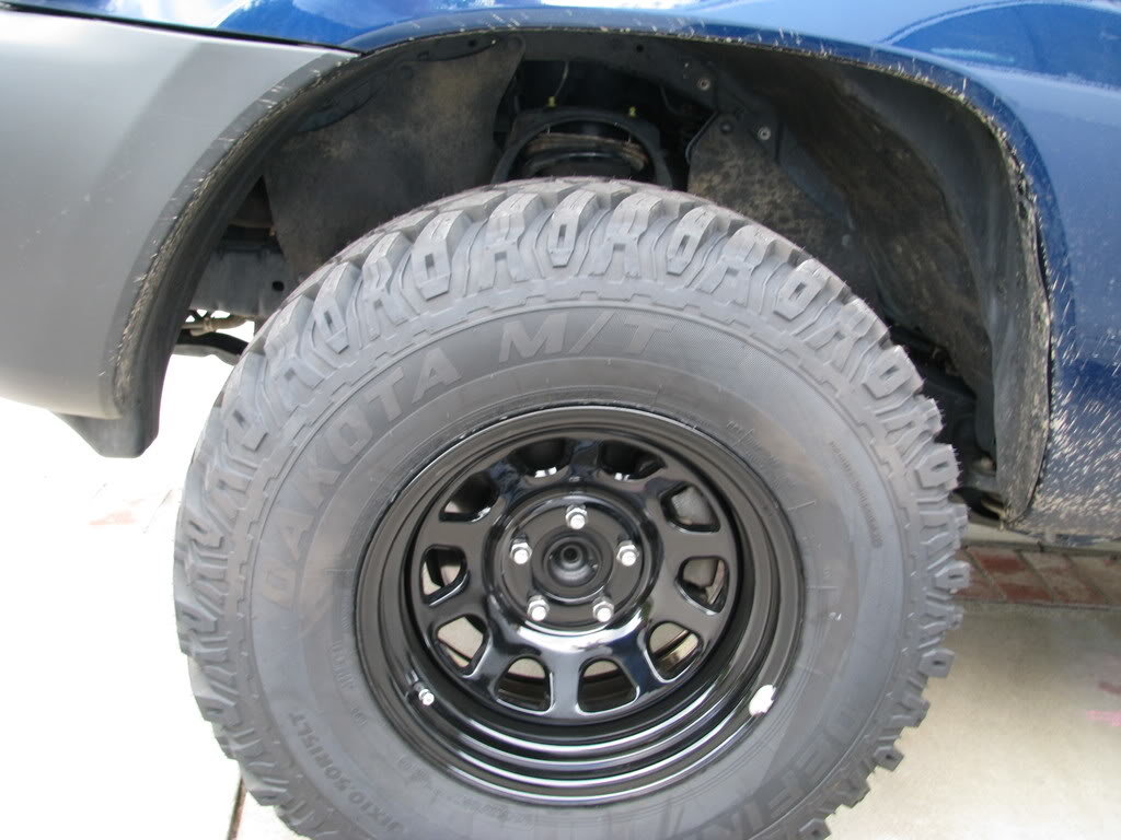

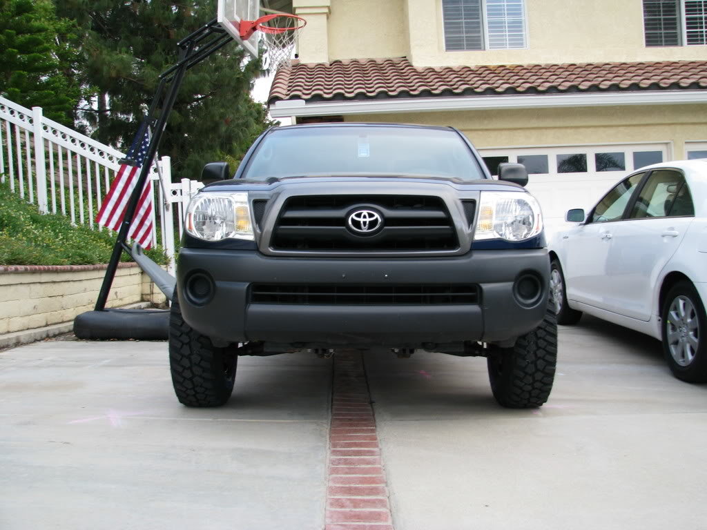

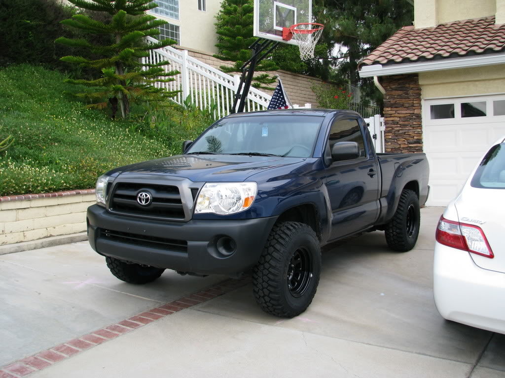

    Also, there are a number of people that have just changed the wheels/tires on the 'mini'/5-lugs to get the look they wanted, and walked away with awesome trucks. Check these out from some of our members...
    Synapse just painted the 5-lug wheels...
    gm3bow didn't go much bigger, but got new wheels and tires. It looks like a completely different truck...
    hammerdog got some Sienna/Camry wheels and slapped them on for the OEM look. This was sweet too...
    DrifterFreak210 went all out!!! Check it out here...
    Long story short - don't get discouraged, and DON'T settle! Get what you want and need, but most importantly get what you will want to drive for a long time. I made the mistake of settling on an 07 Access Cab. Turns out I really needed the Double Cab. So, 14 months into owning my 07' I had to trade it in - not fun.
