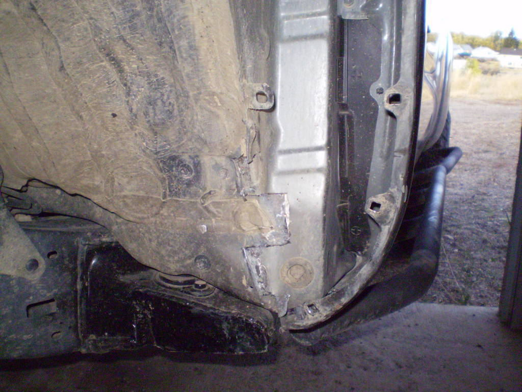

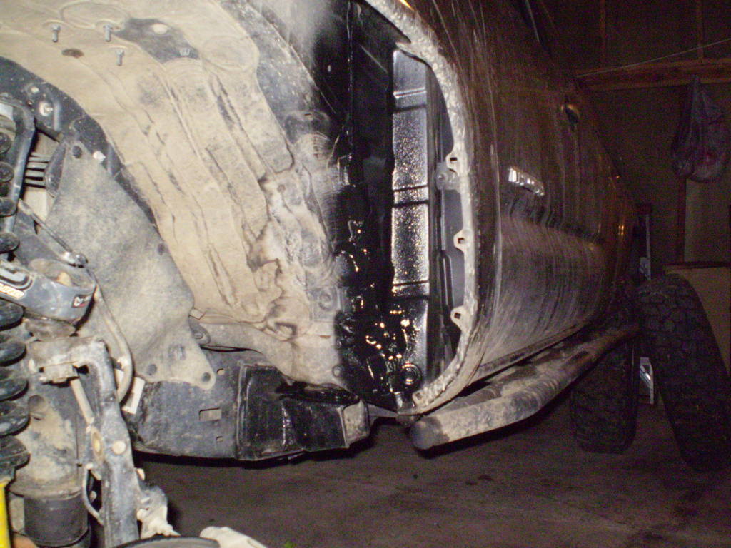

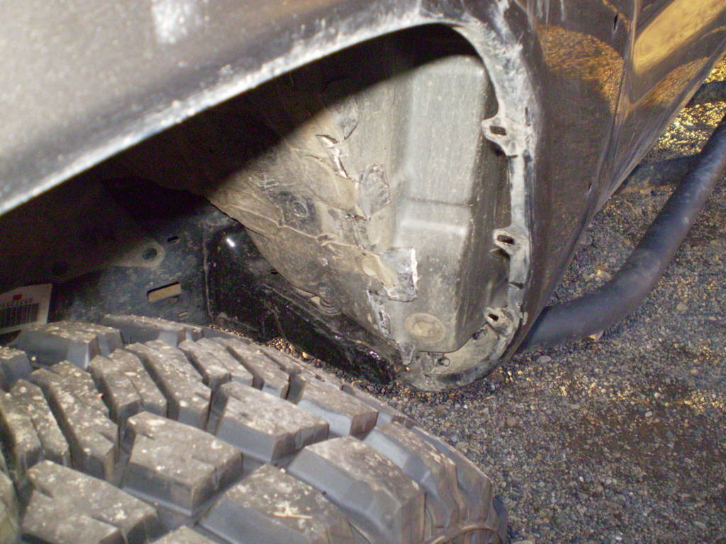

    On the pinch weld I used a cut off wheel and cut it approx. every 1" or so then folded the pieces alternating back and forth kind of like a zipper. It is a little tough to see but for every tab folded torward the fender there is one folded inboard.
    Hope the pics help they are hard to see but it seemed like the best way to do it the last pic I sprayed it with some bedliner to finish it off.
