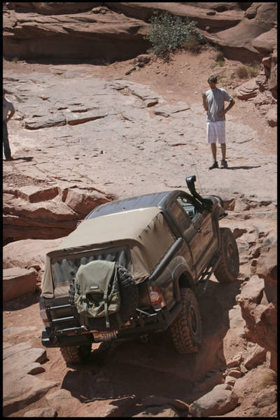

    Pictures of the truck from Operation Moab 2012.
    And the story of how it got there below.

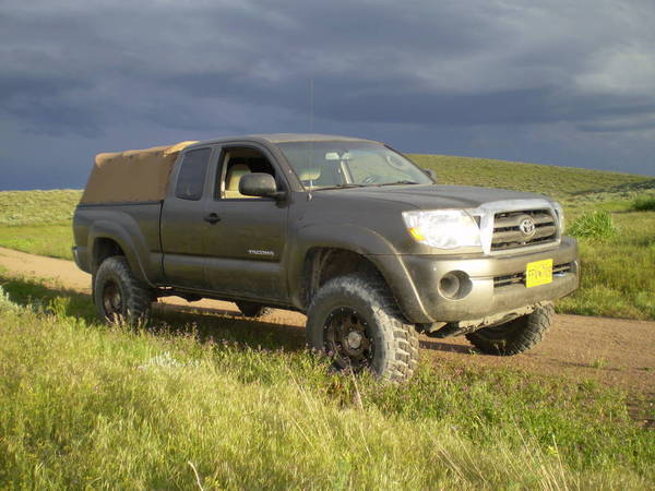

    This is my 2009 Tacoma Access cab SR5 2.7L 4wd. I purchased the truck new in Sept. 2008 in Fairbanks AK. Originally my plan was to just put better tires on it and call it good and get my 1972 Toyota FJ40 out of storage in New Mexico and focus on it again. That isn't how it worked out.....

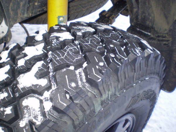

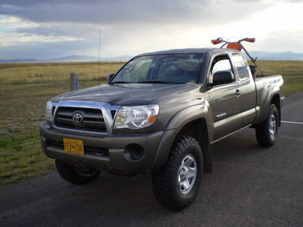

    I put a set of 245/75R16 studs that I got from a buddy for hauling his snow machine and rolled those through the winter in the spring I replaced them with a set of 235/85R16 BFG commercial traction for the summer on the stock suspension.
    I then ended up taking a detail to work in Montana for the summer. I drove the truck down planning to pick up a lift and some new tires. What I didn't plan on was a hailstorm that came through one afternoon and hammered the truck.

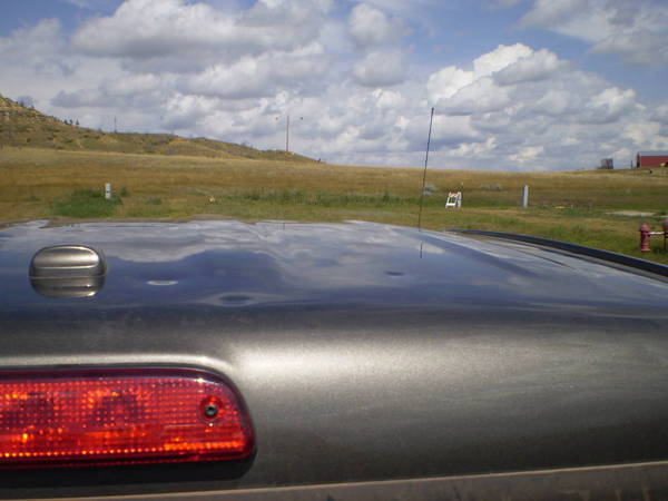

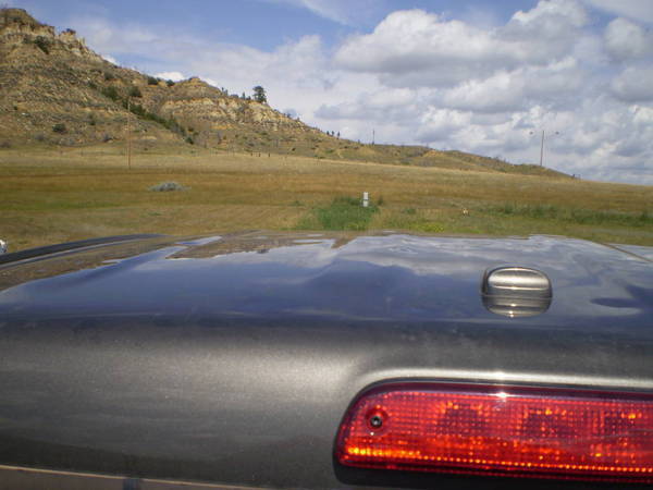

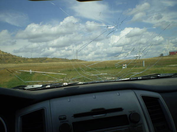

    So after the hailstorm I contacted insurance and got estimates replaced the windshield and then decided on putting the insurance check towards the principal on the loan and not repairing the dents. I then made a trip to the Denver area to ride bikes and get parts. I contacted toytec and ordered OME shocks N140S fronts N182 rears 886 coils and a top load spacer to get a full 3" and toytec add-a-leaf for the rear and picked it up. I did not have access to a shop or tools and had it installed at High Country 4x4 they do good work. Then a stop by 4 wheel parts to pick up some 255/85R16 BFG KM2's. A before shot and some after shots.
    So I'll end this post here and work on it some more later seems more like a story than a build at this point.

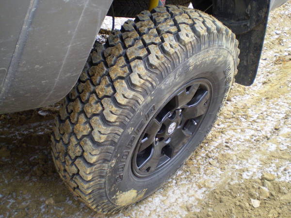

    So I made it back to Alaska from Montana in mid Sept. 2009 and the first snow hit in October. I knew that BFG KM2'S were going to suck in northern winter road conditions so I put together a winter set up some 255/85R16 Cooper Discoverer ST's with studs on a set of TRD off-road wheels that I picked up in Talkeetna AK on craigslist and rattle canned them black.

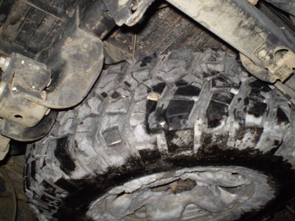

    After we got some thawing and then more snow I took the tires back in and had the center blocks siped for additional traction. Don't get me wrong the traction was good with studs but siping made them even better.

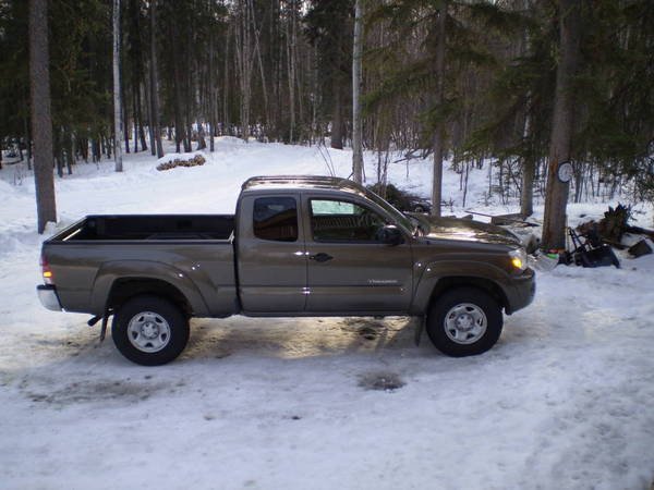

    So in late December I figured it was time to head south for awhile and needed to make bed space so we cut the ears for the spare tire holder to fit a 255/85R16 in there. A little cutting, grinding and some paint and it fit. I had to kick it into place between the spring perches and rails for the trailer hitch to clear the rear diff.

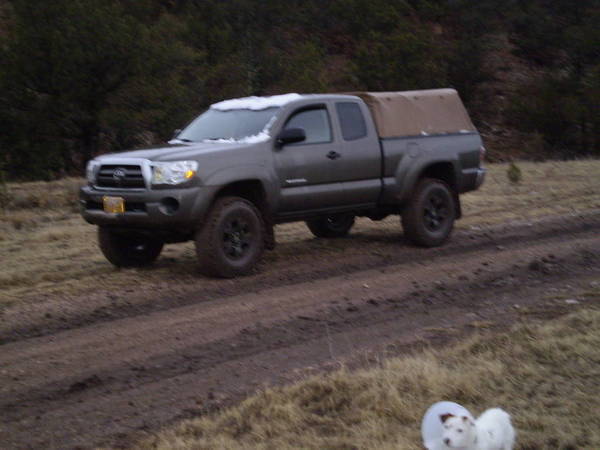

    So with bed space reclaimed I loaded up the truck, put in a call to get a tan softopper as a Xmas present for myself and left AK to pick up the topper and see my family and friends in New Mexico. Some pics of the topper in NM. I have to say that Softopper has great customer service and an out standing product.

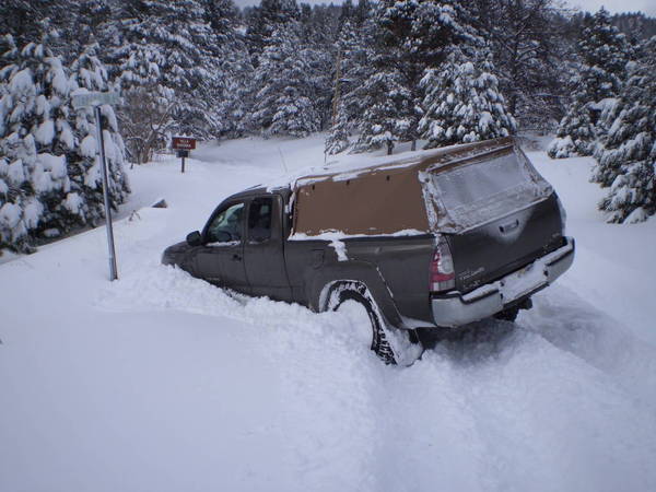

    My kick ass spray painted rims and tire set up are no match for 28" of snow and a ditch, a little shoveling and rocking got me out though.

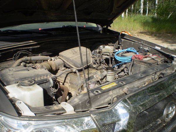

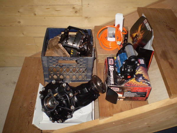

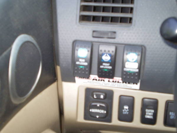

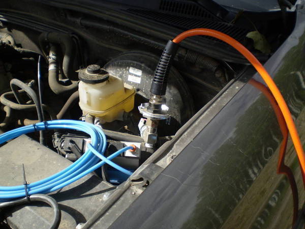

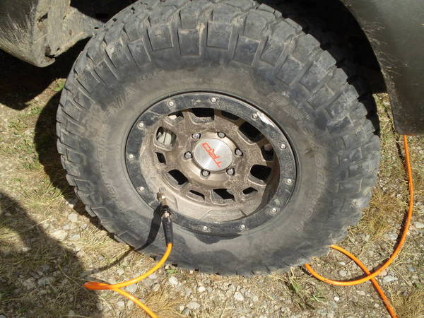

    In April of 2010 I decided it was time to look at gears, I settled on 4:88's and ARB lockers front and rear set up by ECGS (East coast gear supply). ARB was running a promo for two lockers they would throw in a large compressor and accessories kit. Chase at ECGS is awesome and the core exchange program is the way to go. The install was pretty simple and there are some great write ups on TTORA that I used for the install.
    Some pics of the compressor and switches

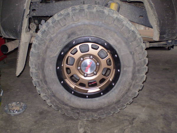

    I stopped by the Toyota dealer to get some parts and asked the parts guy about Bronze TRD off-road wheels that everyone on the web had said were on back order, turns out they had a set sitting in the backso I had to pick them up. I didn't like the aluminum rings so I rattle canned them black.
    This was my fix for the TPMS light since the sensors would not fit from my steel wheels in the new wheels. While we had the dash apart to wire the switches for the lockers I pulled the gauge cluster apart and cut a ARB sticker to fit over the TPMS light rather than black tape.

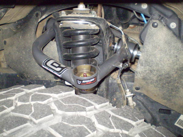

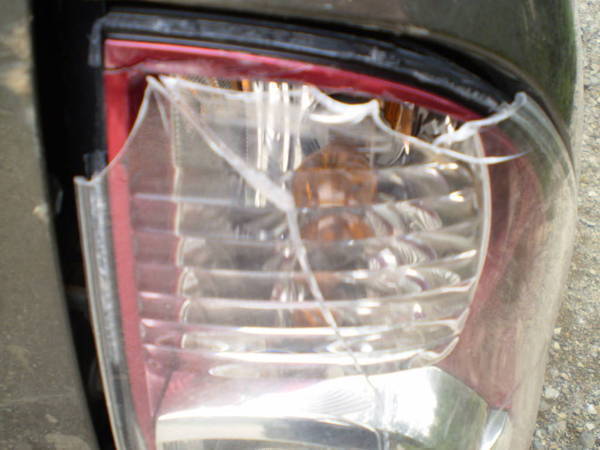

    Replaced the tail light and ordered some Camburg Ball-joint UCA's. I like that they don't squeak and are way cheaper than uni ball style.

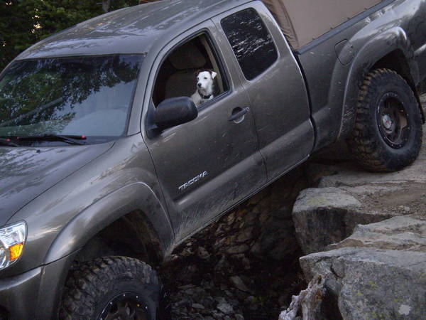

    Some wheeling pics my dog Norton and new plates not really build stuff but I really dig these photos. Build stuff that is coming up sliders are ready and bumpers are under construction, on order Budbuilt skids and parts piled in garage currently Warn M8000 winch, U-bolt flip w/ Timbren bump stops and OME Dakar rear springs. Plan will be to throw the new parts on with the bumpers, sliders and skids to support the extra weight.

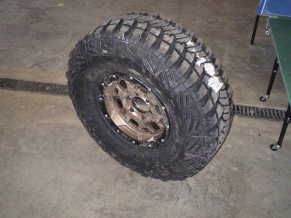

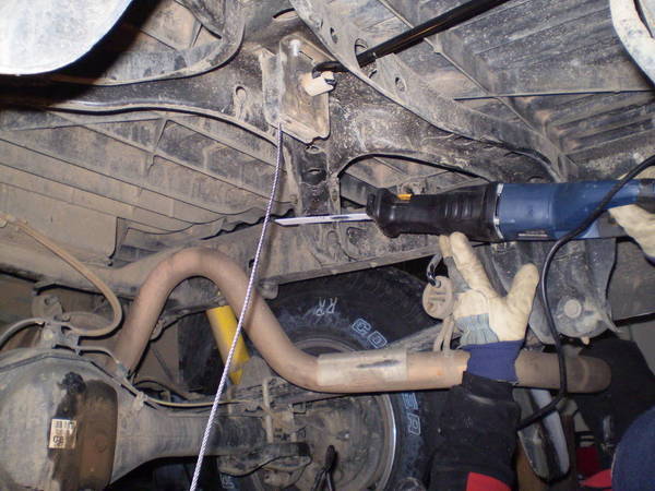

    So I was able to get some work done with the help of some friends and after hours shop time. We cut and plated the front body mounts and added some 1.25 Spidertrax wheel spacers to all four corners.

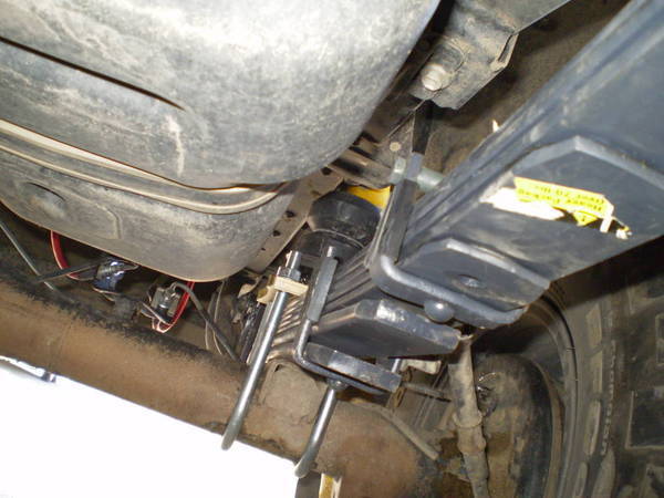

    We put on a set OME Dakar leafs with an All-Pro U-bolt flip with Timbren bumpstops, new brake lines and a carrier bearing drop kit.
    Then this morning a brown truck stopped by and dropped these off....
    315/75R16 Goodyear Wrangler MTR Kevlars so the plan will be to set up the spare TRD rim I have and start test fitting next week.

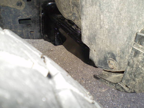

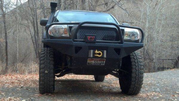

    I was able to get one of the Goodyear kevlars in a 315/75R16 mounted and did some test fitting on the front, it is going need a lot more trimming. Here are some pics :eek:
    I think it is going to look pretty good when I get it all together. I am headed to CBI tomorrow to pick up a set of sliders and the front bumper, they still have some work to finish on the rear bumper but it shouldn't be to far out.
