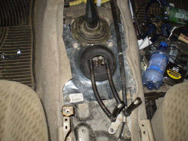

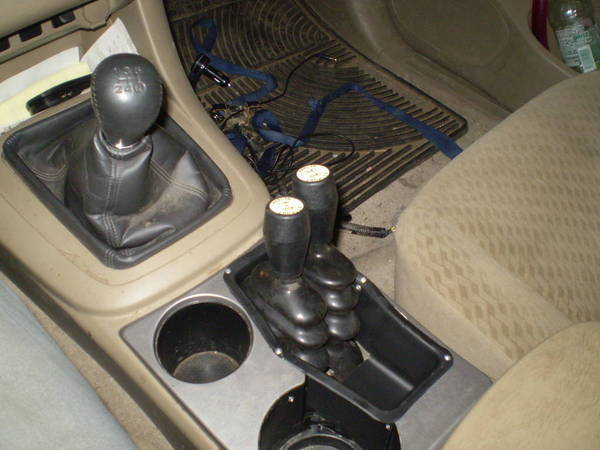

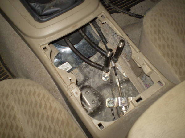

    On mounting the shifters I will have to see when the Tacobox gets here, I am hoping to just reverse (cut, weld and rebend) the current twin sticks since they will be moving back 8.5" and keep them near the current spot hopefully a little further back then where they are in center console. For the shifter on the Tacobox itself hopefully it will be a little forward of where the current twins are now since I hope to move them back and keep everything within the current area I cut out in the center console.
    So these would be more torwards the rear of the current location
    I would shorten and reverse these so that they come up through a new hole 8.5" back of the current hole. The Tacobox shifter will come up through the original hole for the twin sticks.
    Clear as mud I think I confused myself a little trying to put thought into words....

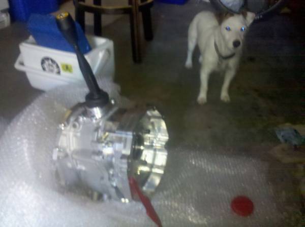

    I just got home this has been sitting in the garage for the the last 2 weeks.
