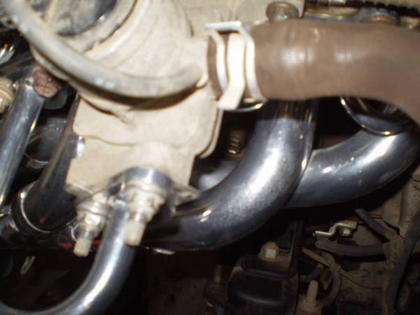

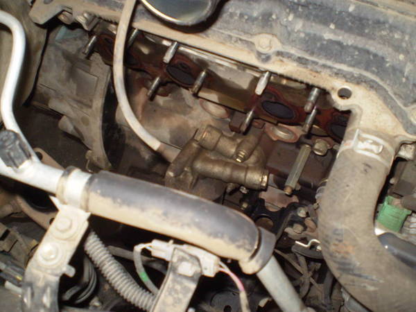

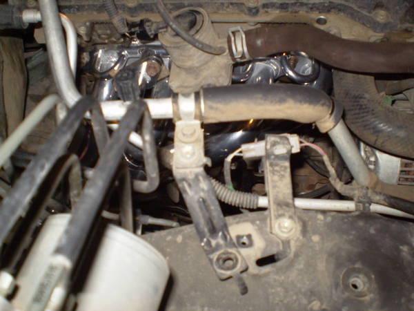

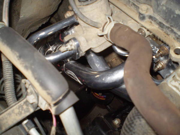

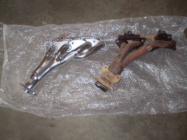

    I was able to get some work done this weekend, I started out on Friday with pulling the stock exhaust and putting on a Doug Thorley header and Jardine catback exhaust. Unfortunately my camera decided it was done about six pictures into the operation so I don't have pics of the exhaust or Safari snorkle that I installed on Saturday. I'll get some more pics posted later this week. I did a trip today and am really digging the exhaust and snorkle there is a noticable difference in the bottom end and I like the way it sounds I will be curious to see how it affects my mileage.
    There is a exhaust manifold in there somewhere...
    Stock manifold removed use lots of PB blaster to help break all the nuts loose
    Comparison of DT and stock header
    New header in place
    The last photo my olympus camera shot prior to its demise....RIP 2005-2011 Olympus FE-170:(

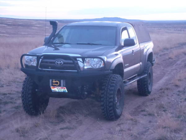

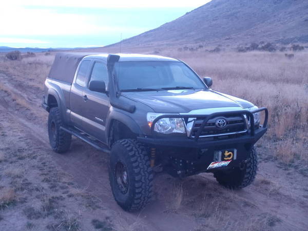

    I started to get a good amount of sediment in the bottom of the airbox intake tube after a year with no fender skirts. I had to do something so a snorkel was the answer.
    I'm liking the DT header and Jardine exhaust although I guess they are the same company cause the muffler is stamped DT but the exhaust tip is stamped Jardine and it came in a Jardine box??
    Here is a cell phone pic teaser of the snorkel I'll post some better ones after work.

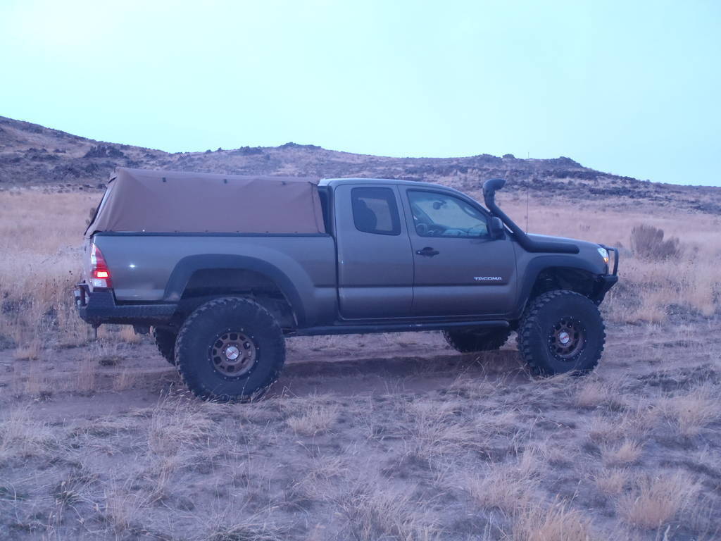

    Better pics from this evening

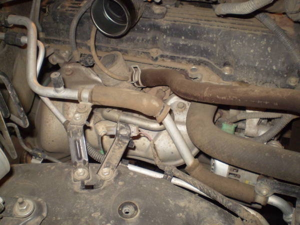

    n0rth: any pictures of under the hood of the truck? I hear you have to do some fabrication to get the snorkel to mount up.

    I can snap some pics but it won't show much, there are several ways to make it fit the instructions that are out there are mainly for the V6. I ended up cutting the plastic end on the snorkel at an angle and cut a lot of the rubber boot off then notched it to fit.I was able to use the stock part from the airbox that goes through the inner fender and work it all together for a good fit. Originally I cut the hole in the fender and lined up the snorkel and went WTF this is never gonna work. It took lots of trimming a little bit at time to get it to line up but wasn't too bad.
