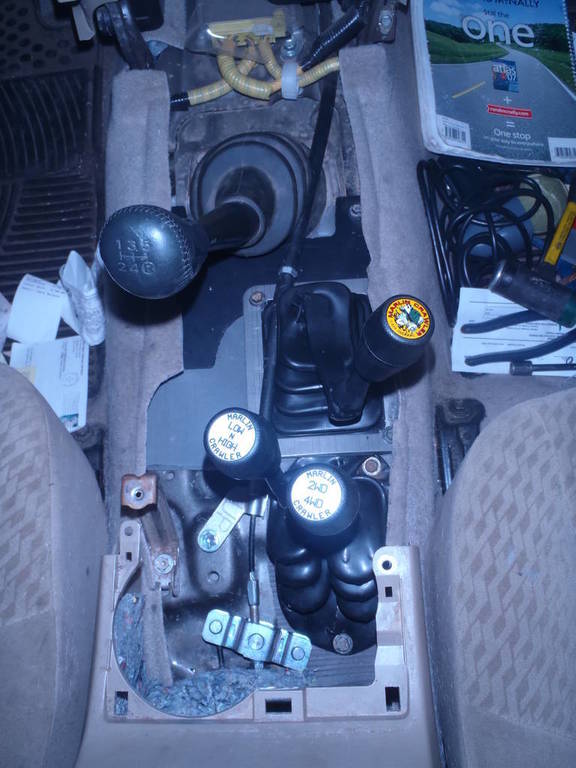

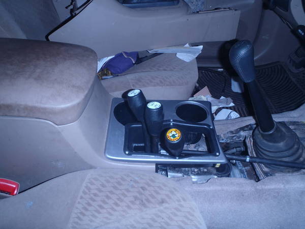

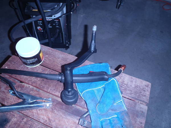

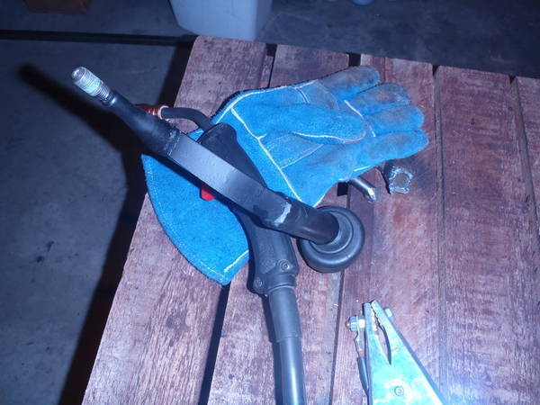

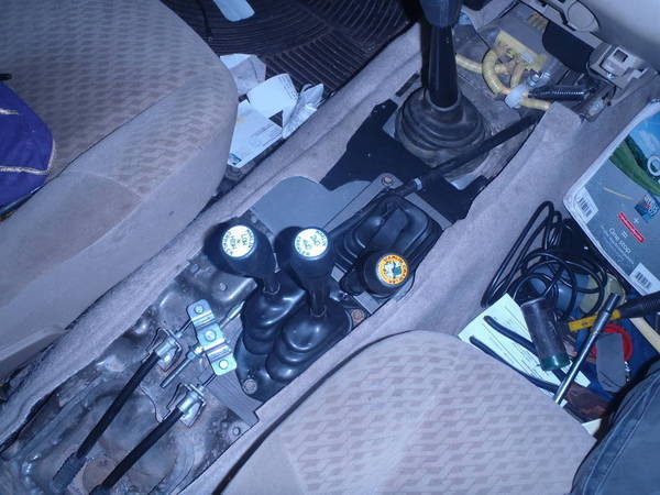

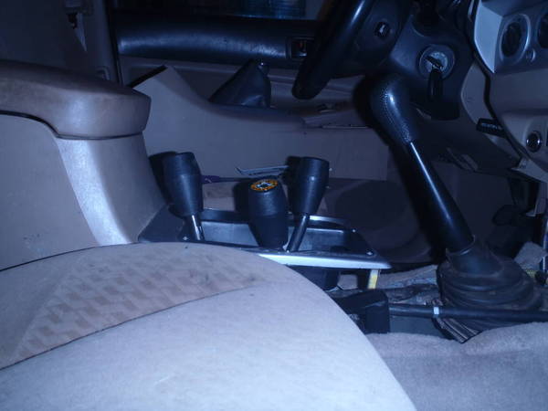

    Finished dog legging the crawler shifter today, really like how it looks like the truck is throwing up shifters. I will need to get some boots made for it. Going to try and finish up a few more things today so all I have to do is put the drivelines in it when I get them tomorrow.

    how you going to cover up the whole for the shifters? with 2 cases why is there 3 shifters?

    1 for crawler, 1 for hi/low, 1 for 2wheel/4wheel

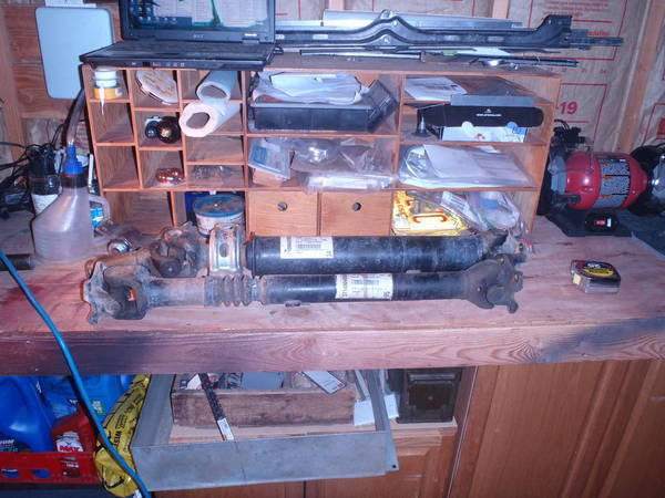

    Holy shit, this thing is low. I picked up the drivelines this morning then spent the rest of the day painting them and finishing the center console and shifters. Put the rear DL in and backed it out of the garage and messed around with it for 20 minutes in the dark in the street here at the house. I still need to install the front DL and do a couple of other things but I'm really close to being done with this project.

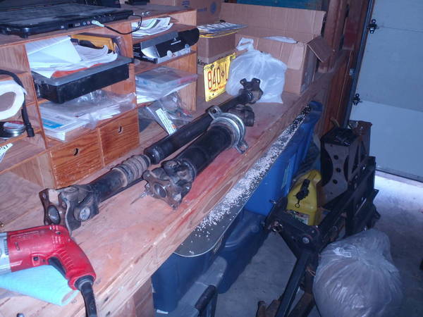

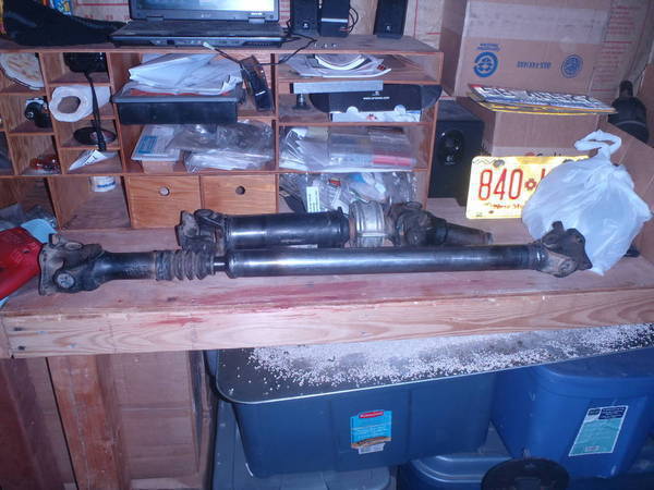

    Comparison pics of drivelines Front retubed with 8 1/2" added to it, rear shortened 8 1/2".
    Stock

    i see exactly what you mean lol. it looks like a cluster fuck of shift levers
    pretty much my reaction as well
