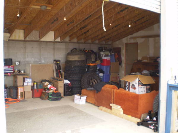

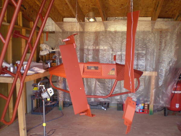

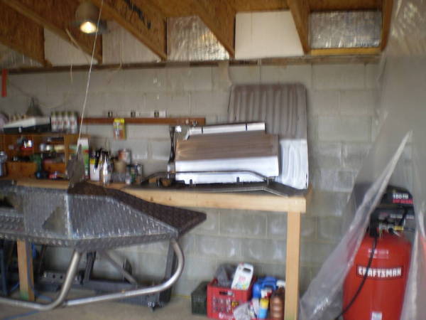

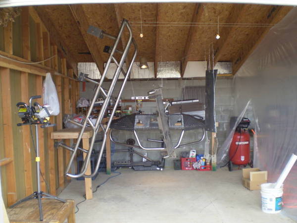

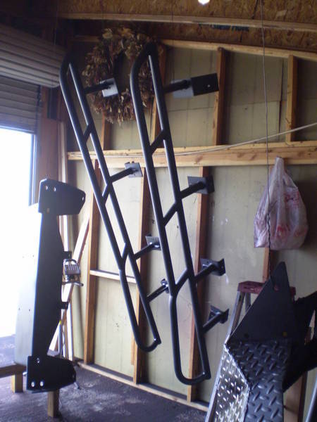

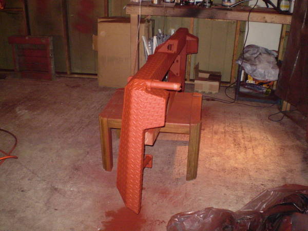

    It took awhile to get the front bumper and sliders done due to the fact that a lot of stuff was either packed from moving or what was unpacked was scattered around the shop. So I finally had to clean up the place and organize stuff.

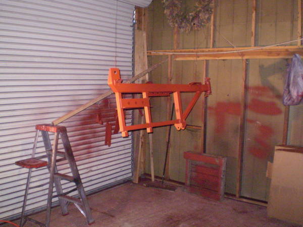

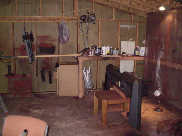

    We had tear down a bunch of old shelves, built a workbench and hung visqueen to have a makeshift paint booth. After we prepped everything for paint we hung it from eye hooks and wire in the rafters. Hanging stuff is nice although I would hang the sliders differently, the way I hung them saved space but made it a pain to paint all the nooks and crannies.

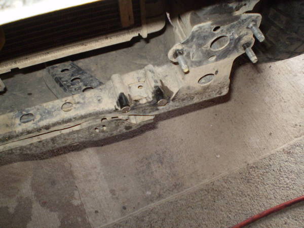

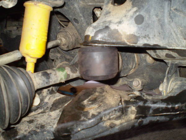

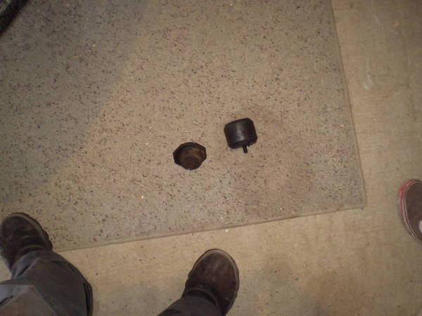

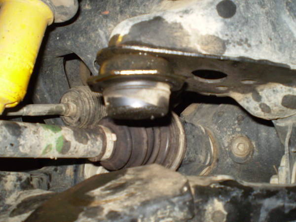

    In between coats of primer I was able to install the front Timbren bumpstops. Shoot them with some PB blaster and let them sit for awhile then get a set of big ass channel locks and unscrew them, screw in the new ones and they're done. Last shot is stock vs. Timbren.

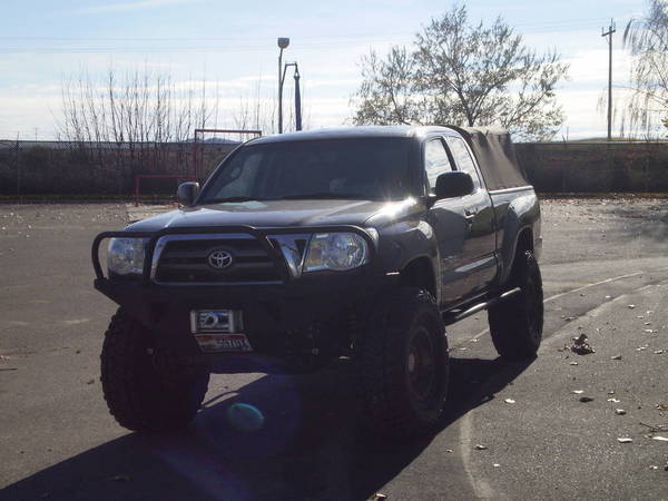

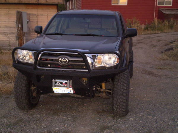

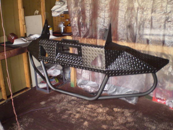

    Here are some shots after spraying the last coat of black it is a little shiny because it is still wet but it made me wonder if I should have gone with a semi-gloss after it dried I was glad I went with the flat black.

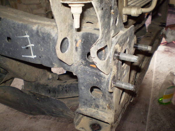

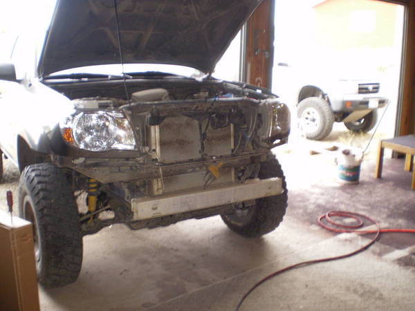

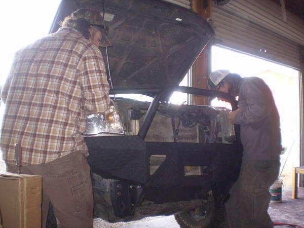

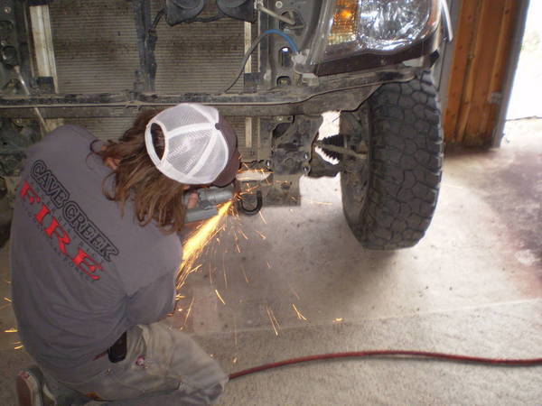

    After watching paint dry for days it was time to start putting stuff on the truck. I took several shots of what we did to fit the front bumper but neglected to get any shots of putting the winch in place.
    Cut the recovery loop off or the lower skid won't fit.
    Bend this ear over for the sub assembly to fit well.
    Had to grind that piece off because we needed a bit more room to get the bumper to line up correctly.

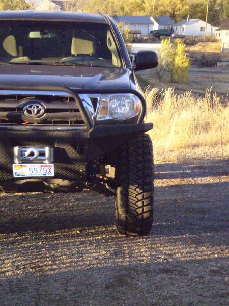

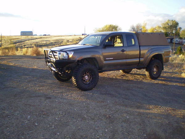

    So this is where I forgot to get any pictures of the winch going in so I'll just skip to some final pics of it all finished up.

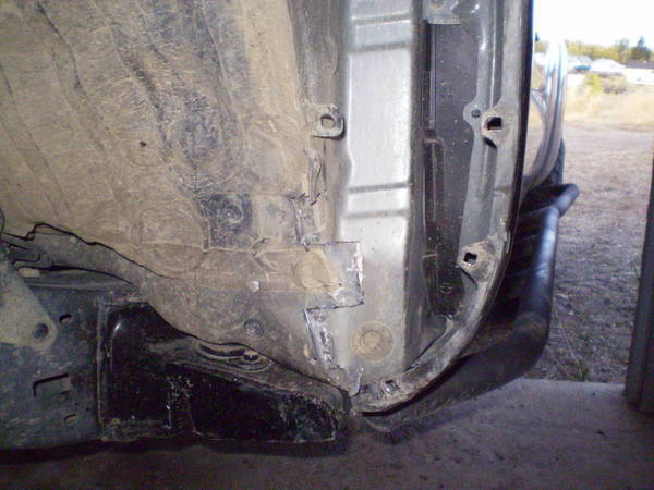

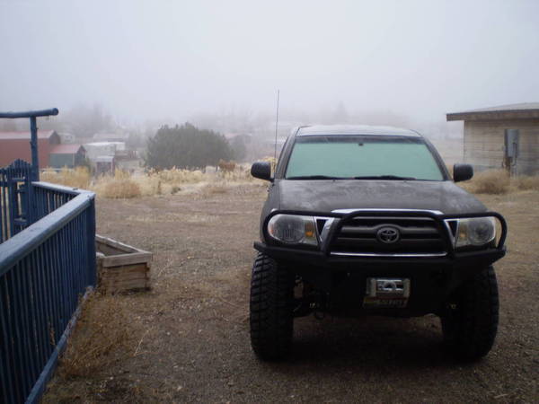

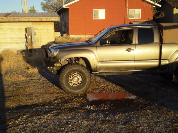

    So I ran out of paint for the rear bumper and started working on making room for the 315/75r16's. I started by putting a new set of OME 886's I had older 885's that were starting to sag under the weight of the front bumper and winch they are also saying the newer OME springs use a scragging process to prevent sagging we'll see how they hold up. Next I stripped wheel wells and cut the pinch weld and beat it back.
    Then I hacked on the body mount some more and I think will end up cutting more later but am not sure yet we'll see.

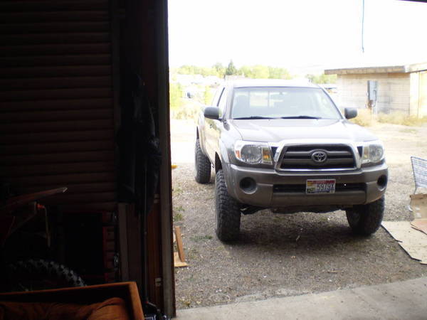

    I pulled the flares as well and took them to a shop that said they could cut and plastic weld them they have had them for two weeks now and haven't got to them yet and I'll leave it at that for now. I can't wait to cut the fenders but don't want to start until I have the flares done and in hand to measure against before I go hacking the fenders.
    Here are some pics with a 315/75r16 on the front of the truck.

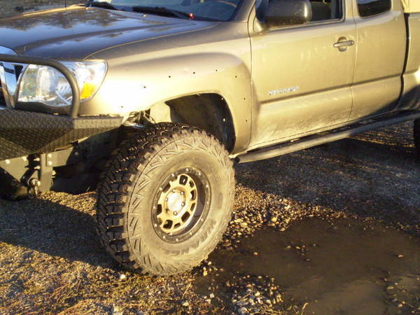

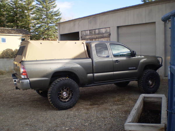

    I finished painting the rear bumper and swing out hopefully I can put them on the truck Sunday.
    I also put the 315/75r16 MTR's on and have maybe driven 100 miles with them, I plan to trim the fenders on Sunday currently everything clears the only rubbing is on the frame at full lock I will probably put my front wheel spacers back on to help out with that. So here are some pics with them on the truck.
