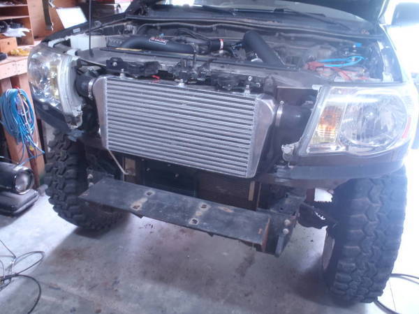

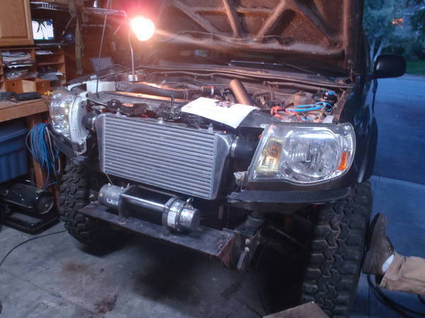

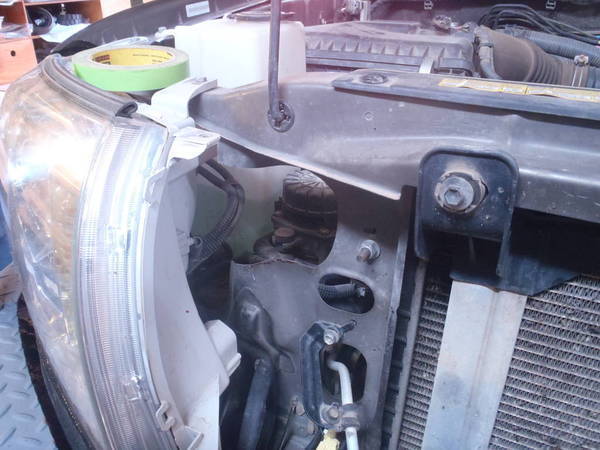

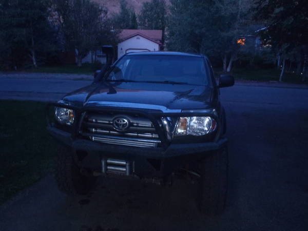

    A shot of the truck prior to its surgery after it rained this morning
    Getting started

    ha same cut out for the URD TCAI.

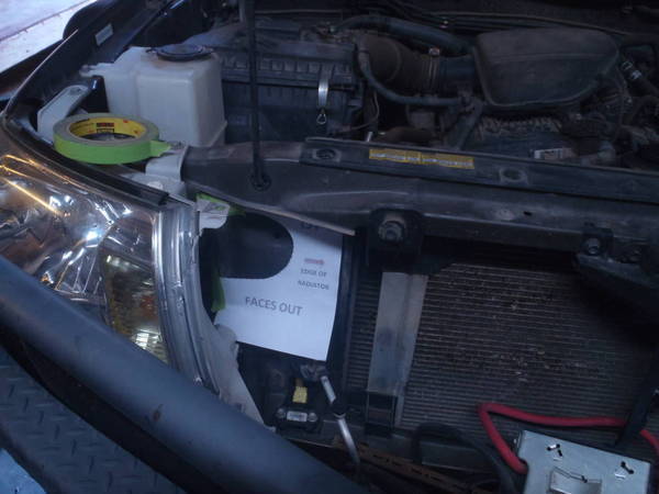

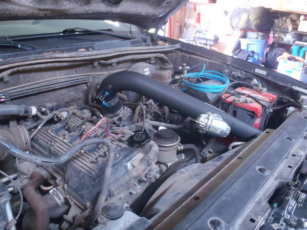

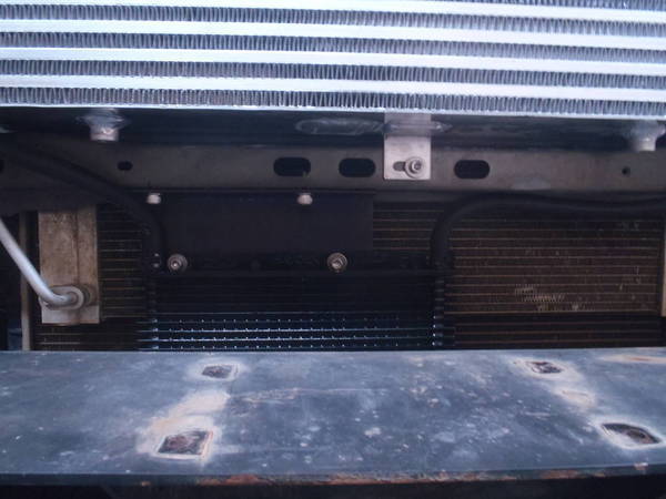

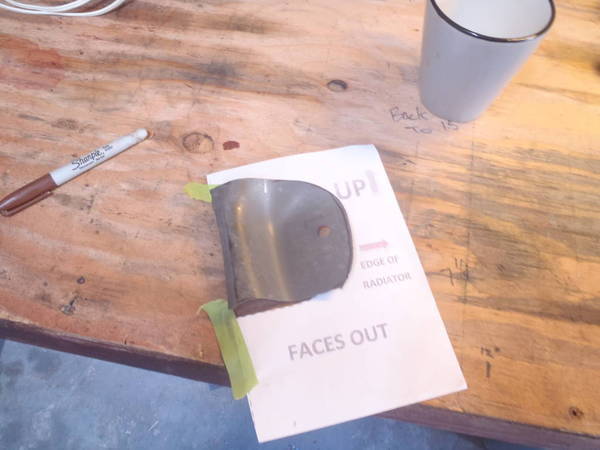

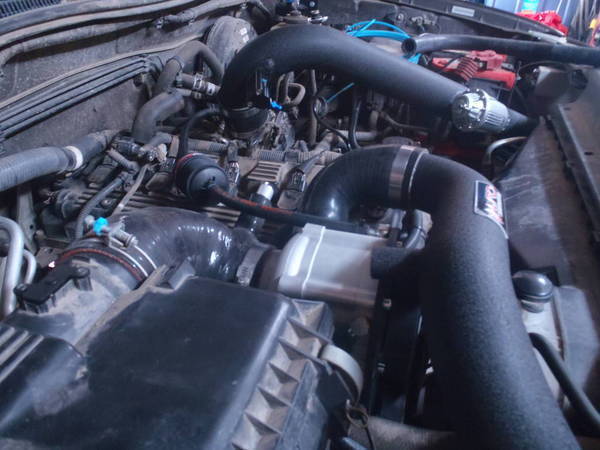

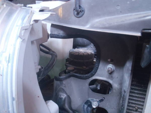

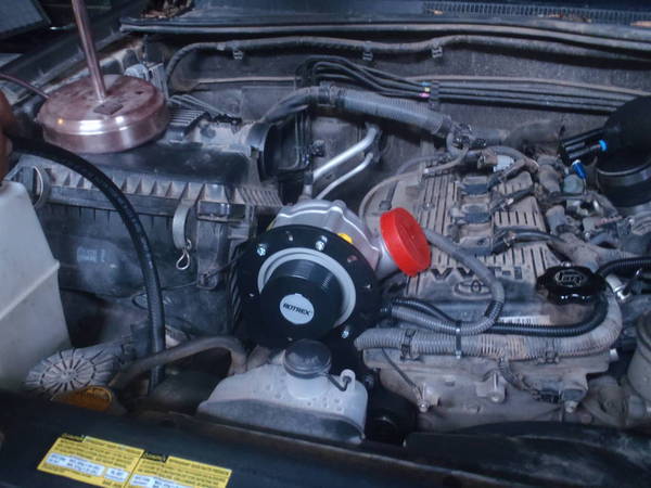

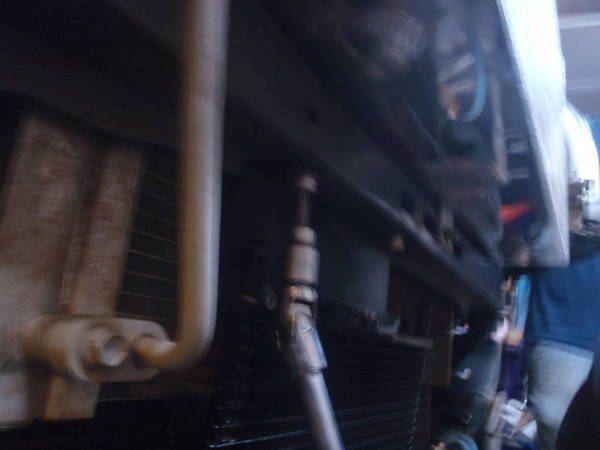

    Some more pics of the process, I have had to really think about how to make things work with some of my previous mods.

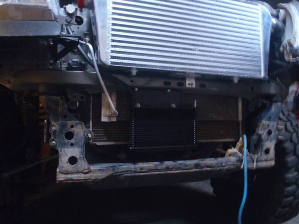

    Oil cooler mod

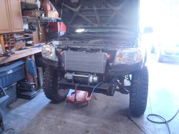

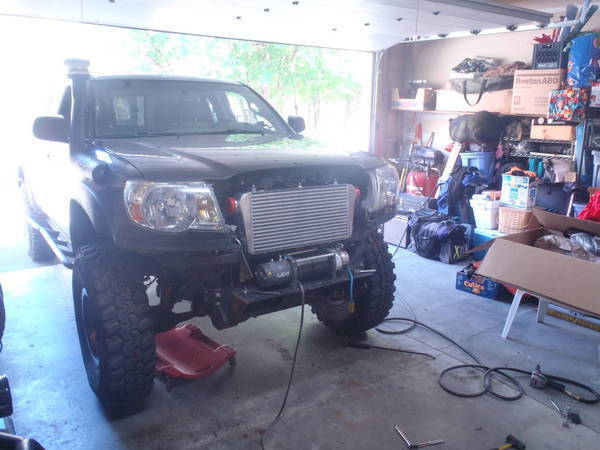

    Where I ended for the night, I'm hoping to finish up tomorrow but it may be a stretch.

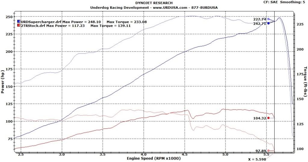

    Looking at the dyno, it basically turns your I-4 into a V6. The stock V6 dyno URD has up puts it at 207 hp and 252 ftlbs of torque at the wheels.

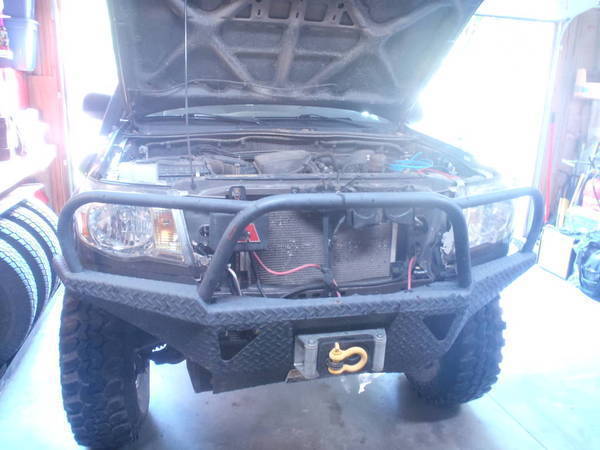

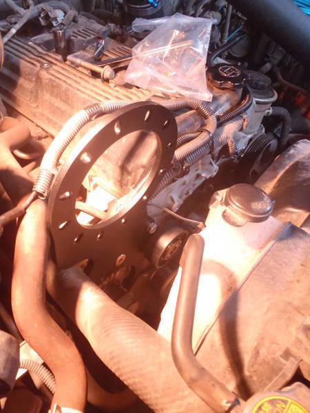

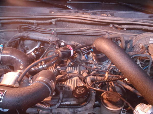

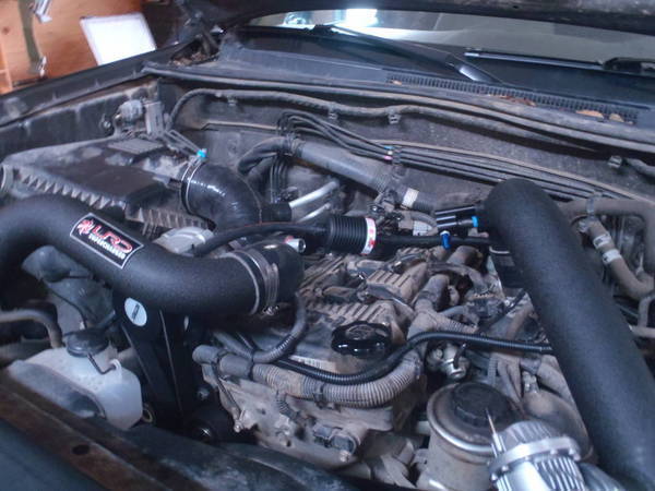

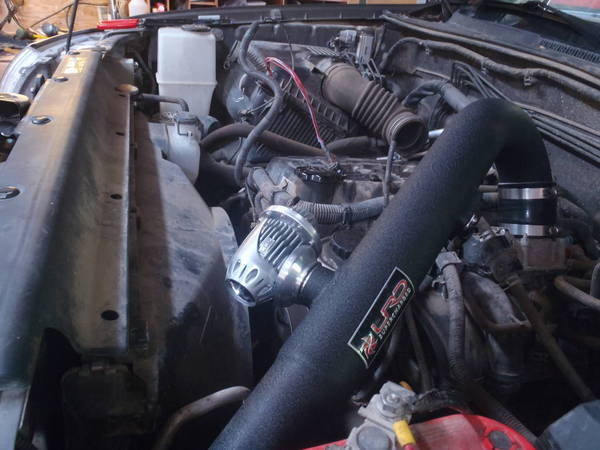

    So I was able to take a few more drives and check out the truck last night. When I got home I made adjustments to a few things and did a short drive then came home and checked everything again installed the grill and bumper (only with a few bolts) as I need make a new mount for the winch control. Here are more pics from Tues of the install.
    Josh wiring up the ECM I'm glad I had help on this, I hate wiring stuff although we were surprised at how few connections he had to make.

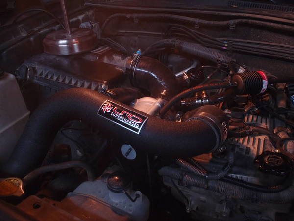

    A shot from last night, I want a different grill now guess I'll be getting in touch with Homertaco.:popcorn:
    So the S/C is awesome. I still have some more work to do over the next few days getting the glove box and wires all tucked away as well as building a mount for the winch and securing all the stuff under the hood more permanently. I have about 30 hrs. in on the install right now.
