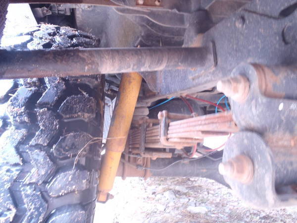

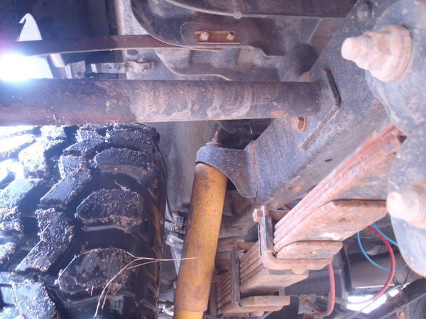

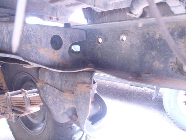

    Rear suspension pics, for reference

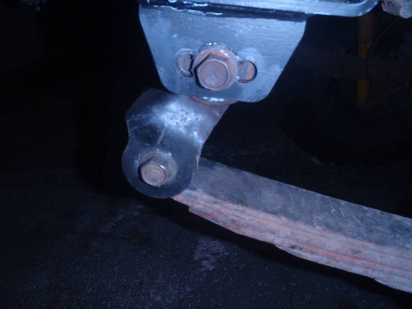

    Got the ATO shackle hangers primed, pulled the rear bumper and removed all the upper rivets then picked up my plasma cutter from a buddy that has been using it to build bumpers for his FJ 40. Tomorrow I plan to finish painting and take care of the lower rivets. Hopefully I'll be flexing by the afternoon....

    Rivets suck, but it's all back together.
    My old hanger on the passenger side along with my frame had a nasty bend to it that I had to straighten out.
    I set the new hangers up in the neutral/center holes on the upper and lower, this is the angle with no rear bumper.

    Quite the bend. Whered that come from?

    No telling, Cliffhanger maybe :D seems like I'm under the truck enough that I would have noticed it since Moab though. I think it may have happened during one of the last 2 trips to Boulder City.
