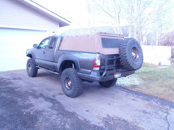

    Shots of it this morning sitting on the expos, it has 600-700 lbs. in the bed recovery bag, toolbox, 4-34" tires on steel wheels with my spare and swingout mounted to settle the springs a little. The plan is drive it where its sits for next few days and see how it works.

    Damn looks awesome. Way taller.
    think you'll have to do anymore trimming with the added flex??

    I think the rear is good, the front clears at full stuff on the bumps with the wheels straight but I think it may be time to tub.

    I played around with the ORI's again was able to pick up a little more down travel set the driver @ 100 lower 1000 upper-passenger @ 100 lower 900 upper. I kicked on the VSC, ABS and parking brake light rallying around on some dirt roads this afternoon thinking its an alignment, zero calibration or a stretched wire issue so I'll need to track that down.
