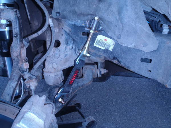

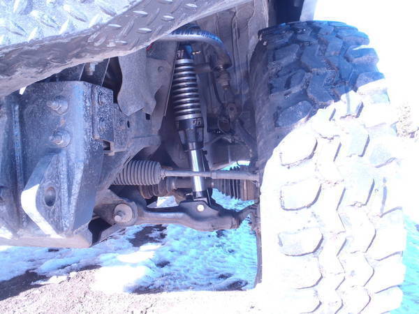

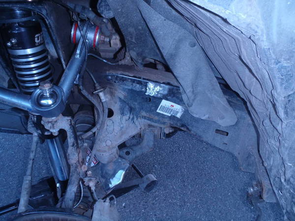

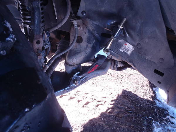

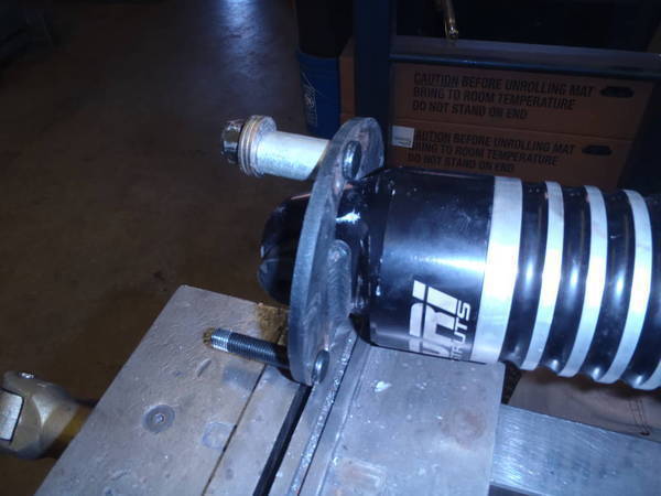

    Got some work done today wasn't really planning on it but had all the parts and my buddy Josh was up for it so we tore into it after lunch.
    Spaced the top-hats a total of 1" in the towers put new 1.25 studs in them to accommodate.
    Here it is all strapped up can't wait to jump it...... the final adjustment ended up centered in the clevis glad I didn't go any longer than 8" we would have had to build a tower or configured it differently.
    My camera and phone went dead during the process so a little skinny on pics but you get the idea. Thanks again to Josh for burning it all in and helping me measure it all out.
