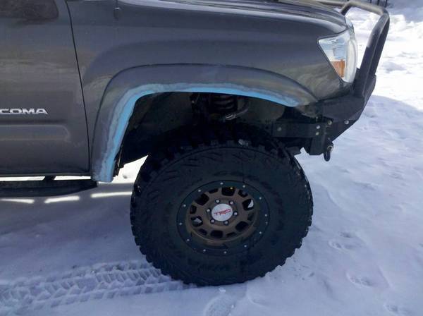

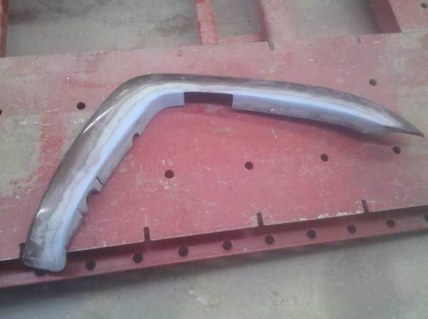

    About 4 hrs a fender roughly, They used adhesive and are plastic welded on the inside and outside the filler is covering the welds on the exterior of the flare the plan is to finish them with speed coat liner. I am going to help with the rear fenders to help cut some labor costs and learn something while I'm at it. Thanks again for the info and advice you gave me it was a huge help.
    Here are a few more pics we are still a ways out from them being completely done.

    x2.
    Are you going to color match them or run them black?

    Thanks, going to use a bedliner/truck coating in black.

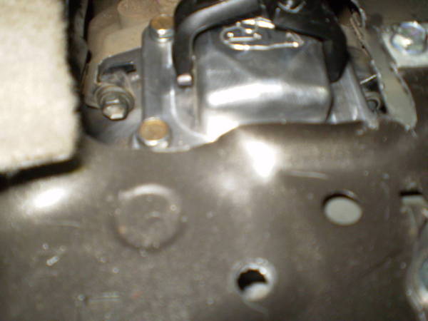

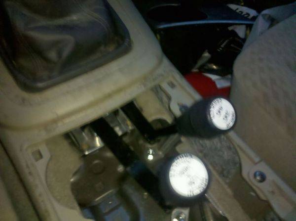

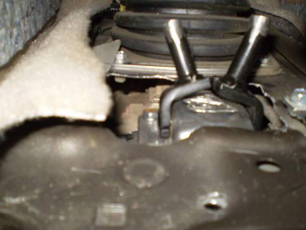

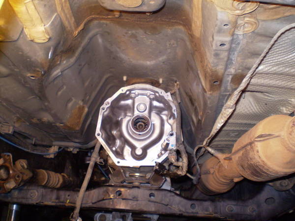

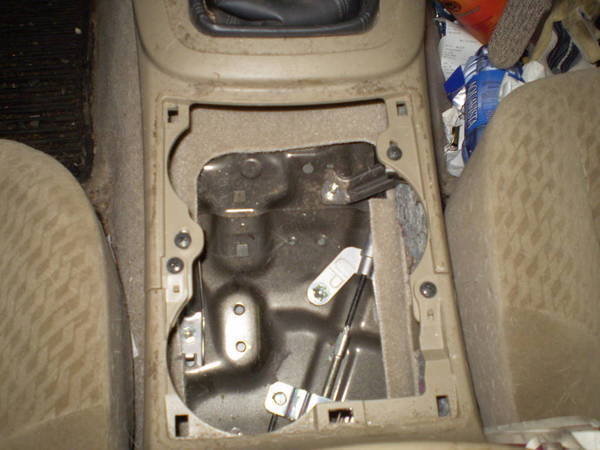

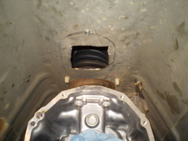

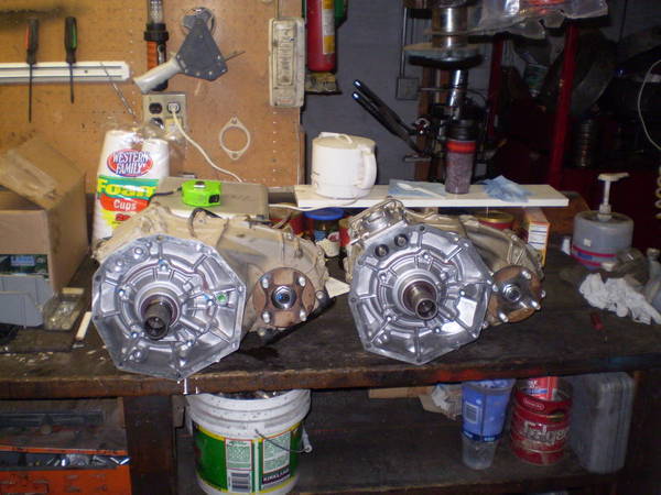

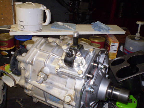

    This is where I am at on the FJ case, and some photos of the swap. It is pretty straight forward unbolt old case.
    We test fit the new case and marked where the levers needed to come through. Then cut....
    You will need to swap sensors and some other items. Here is Wyatts write-up from RST that I studied prior to this undertaking.
    http://rocksolidtoys.com/forum/showthread.php?t=60
    Here it is the case with cut shifters.
    Here it is with levers in place they aren't perfect but works for now, I have plans for a different set up that should work better for a cleaner finish.
    Still need to wire the front ADD to a switch and disconnect the 4wd ECU but am waiting for some more info to get here before I mess with it.
