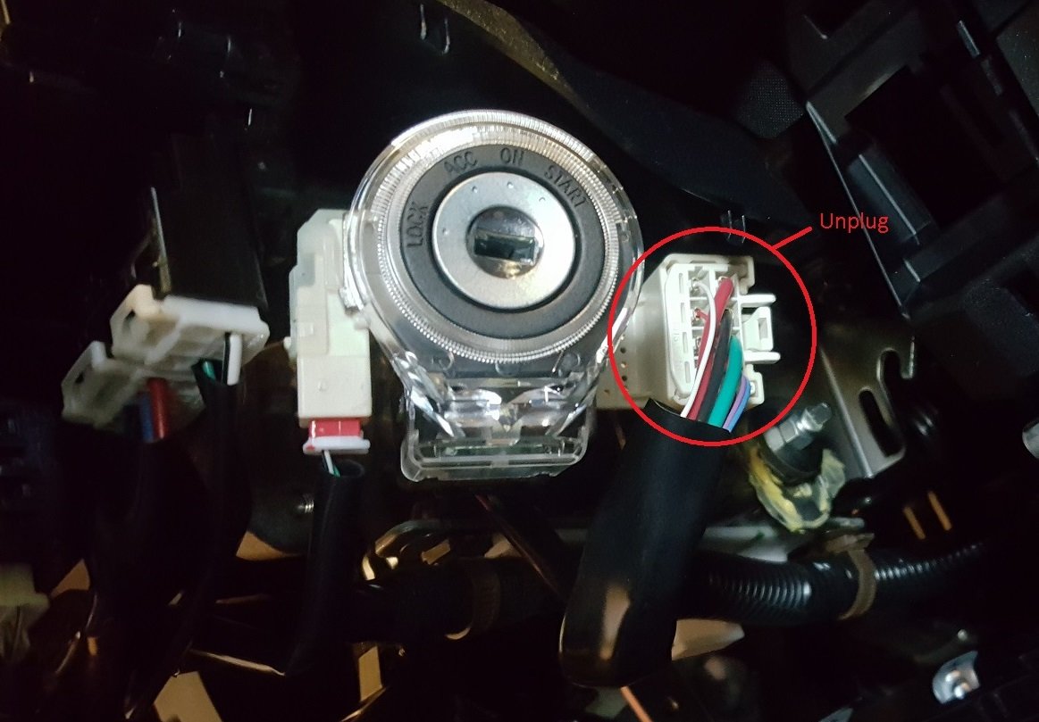

    I just got my kit in and looked at the instructions and felt the same way as some here have voiced. I'll try to detail some areas where I was confused:
    - On the first page where it shows description... you should clearly indicate that this is a visual of what that area looks like before installation. And it's not obvious whether these are photos of what it looks like before installation or after.
    For example, the ignition switch. There's a red arrow pointing to where the ignition switch is, but I only see a keyhole where I go to start my car. No wires. So what am I looking at here in the diagram? It looks like a white connector with 8 wires.
    There's an area (1) labeled "BCM". No idea what a BCM is. And do I need to remove that black plastic shield in the foot well by the dead pedal to expose the areas I need to get to? If so, how? Some instructions here would be helpful as not everyone is comfortable just hacking away at their brand new truck and accidentally breaking off tabs, etc.
    The OBD-ii connector is the only obvious one since it's exposed in plain sight.
    - Wiring diagram on the next page - Again, not clear what to do here. I see the Evo One box. But where does it go? Where and how do I mount it? There's no included hardware (brackets, screws, etc) or double-sided tape.
    - The programming part (next page) - How do I start? I assume it's without the key in the ignition, but you should clearly indicate so.
    I'm going to go attempt this installation now. Wish me luck.

    Connecticut
    Ok, if you have a regular key, the connection to the ignition harness is different than what is in the videos.
    The videos show a small black 7-pin connector.
    Ours is a much bigger white connector.
    It is right next to the ignition itself to the right (if you're looking at the ignition). I took a photo below. Mine is a 2019 6MT, for reference.
    doublethebass likes this.
  20. Dec 18, 2018 at 12:29 PM
    #640
    jmeitz
    jmeitz Audio Solutions
    Sep 23, 2016
    #198045
    709
    Jeremie
    St. Louis, MO
    2016 Tacoma trd sport
    Remote Start Lift Stereo Leather LED lights
    Yep, different plugs and install.
