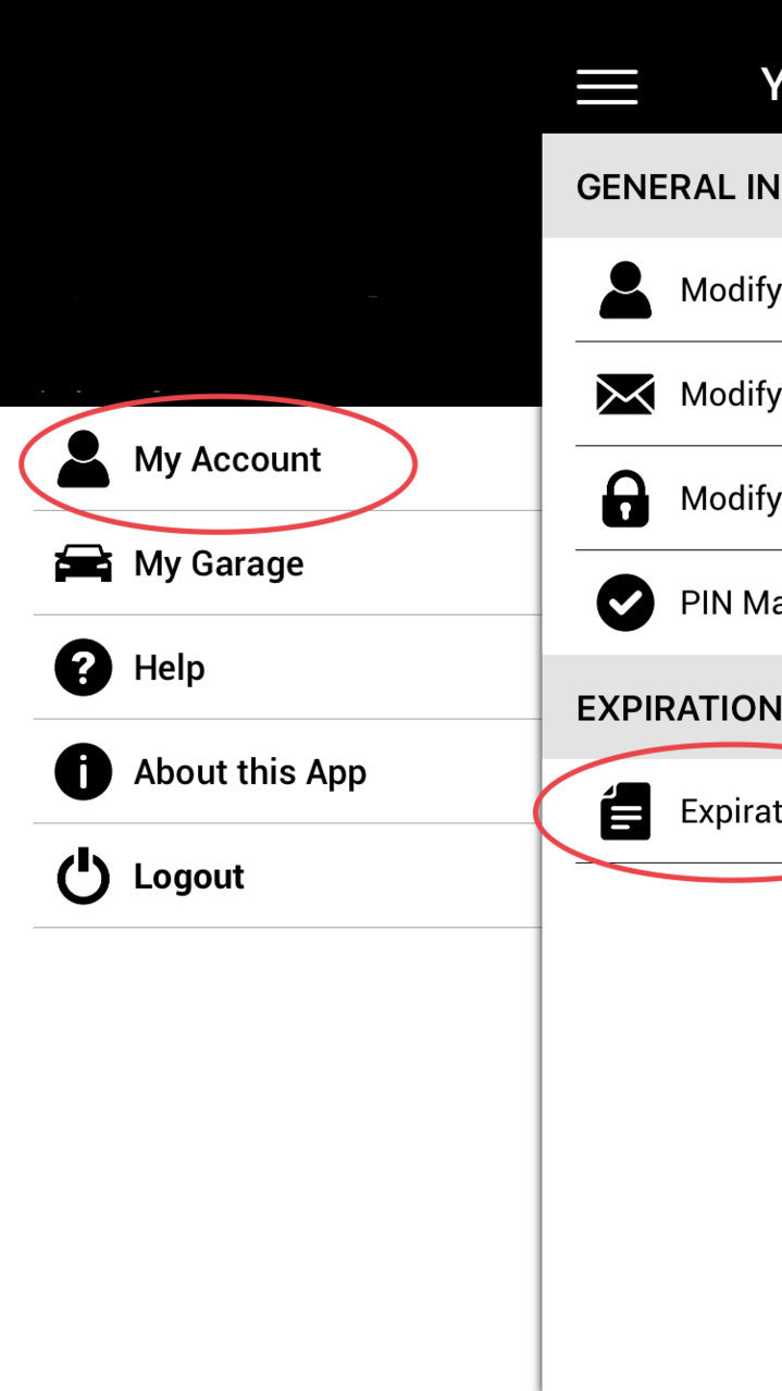

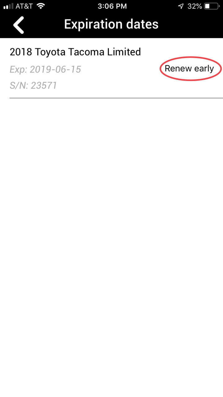

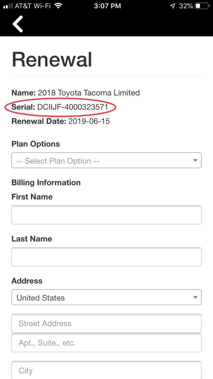

    Nope. I spoke with them and they will do it. We’ll get you guys about 3 months back for free. Intermittent is not what I sold you. I sold you on flawless, unless you’re in the Boonies and coverage sucks, then I sold you on flawless when your ass comes back into the city...coverage is one thing, but they can see where you’ve gone radio silent where coverage was still good, that’s the key. Anyways, as a retailer, they won’t question me. I just need to provide them with the list of names and 16 digits. I know all the guys there and I’m cool with them all. It’s not being questioned at all. In fact, I called to give them a little weekend kick in the ass on things, and he brought it up first! Made my job real easy! So I said “we have to, this is the least we could do to reclaim brand perception”...
    Anyways this is how to get me the 16 digit from the app.

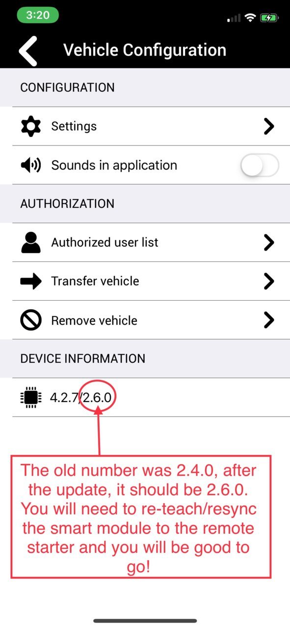

    UPDATE - THOSE EXPERIENCING SMART MODULE ISSUES ONLY - PURCHASED ON OR BEFORE 1-28-19
    PM me your FULL NAME (First, Last), and your 16 Digit Serial Code that can be found on the doorjamb sticker you should've placed on your vehicle, or via app by going through the following screens up above in my post #1263.
    The update will only be pushed to those who've experienced issues. If you've purchased ON or after January 29th, do not join this list, as this is beta and could conflict. You have the latest. Any issues you see, are likely location of mounting, orientation, or spotty signal. If you do something that causes more issues, you'll be responsible for shipping both ways for a re-flash.
    With that said, I'm going to keep a spreadsheet log, will look up order dates and keep track of everything, mainly because those who truly have been inconvenienced, will be getting credit time lost on their free year and are the ones that need it asap. They will be pushing it out one by one, so once you've been pushed the update, I'll be notified, then they'll push the next person, and so on.
    YOU WILL HAVE TO RE-SYNC (RE-TEACH THE SMART MODULE TO THE REMOTE STARTER NOT THE REMOTE STARTER TO THE VEHICLE)
    PM me only if you bought it from me.
    Please PM me your info asap so I can start submitting and getting you guys fixed.

    The folks that submitted their info should see an update by tomorrow end of day although they said there was a chance it would be today or tomorrow morning.
    This is how you will know:
    PDF instructions will be uploaded to the N2 website shortly.

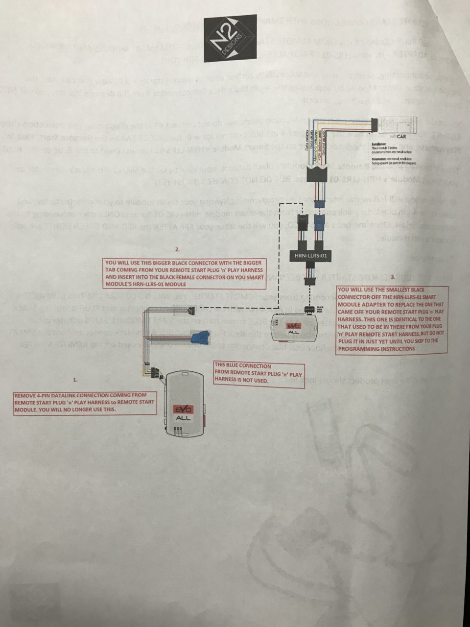

    If you have the instructions, it's pretty much the installation instructions. I'll post a picture here for the time being. Just unplug the smart module from the remote starter COMPLETELY (leave the remote starter plugged into your vehicle. When I say re-sync, I just mean re-install as if you just got it from me for the first time...so if you still have my paper instructions, that's what you'll use...or this...stand by. (I'll post a legit copy to my website after dinner (which is also breakfast and lunch for me)...

    Here it is...
