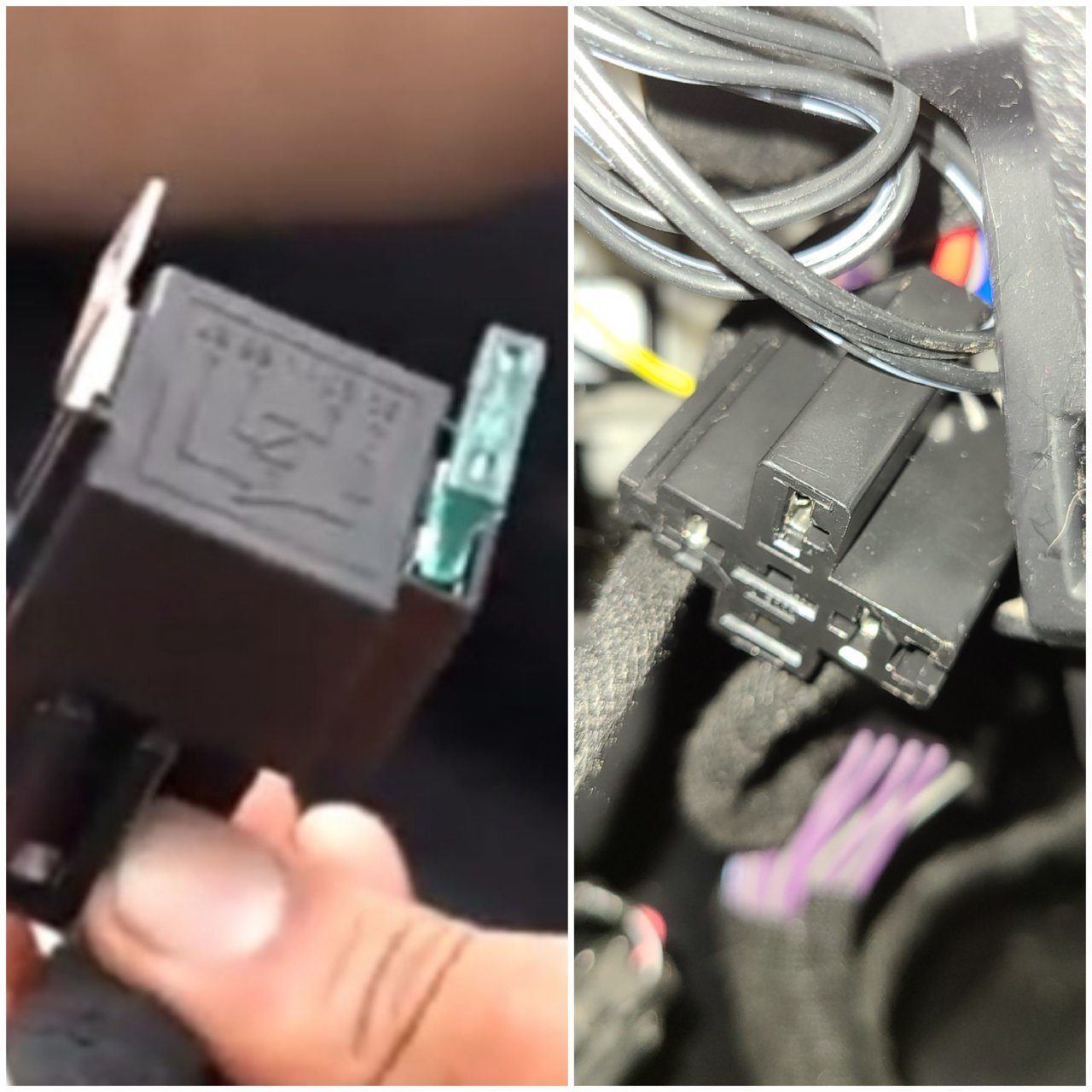

    Having the same problem here. I tried staying in the truck and holding the clutch down which allowed it to start. The T tap cut the wire on my first try so I used a heat shrink solder butt connector to connect all three so pretty certain it's solid. Clutch cancel button still works so don't think it's a bad connection but not sure if a bad tap with the connection would disable it. Mine came with a fuse but I don't see a relay box like the one posted that I could insert it into. Messaged N2 but guessing with holiday weekend won't hear back until next week.

    The yellow "clutch cancel" wire comes out of the relay base. You can follow that wire back to the harness to find the relay base & relay.
    If there's no relay plugged into the base then that would be a problem (but I'm guessing the relay is there, along with the fuse pictured above.)

    You were correct! Looks like mine shipped without the relay with the fuse plugged into the base. I took a screenshot from the youtube video when he was going through the cables. Guessing that is the problem so will have to wait until next week to get it sorted. Thanks!

    Yep, definitely the problem. Did you re-check your box to see if it fell out?
    That will be an easy fix then.
