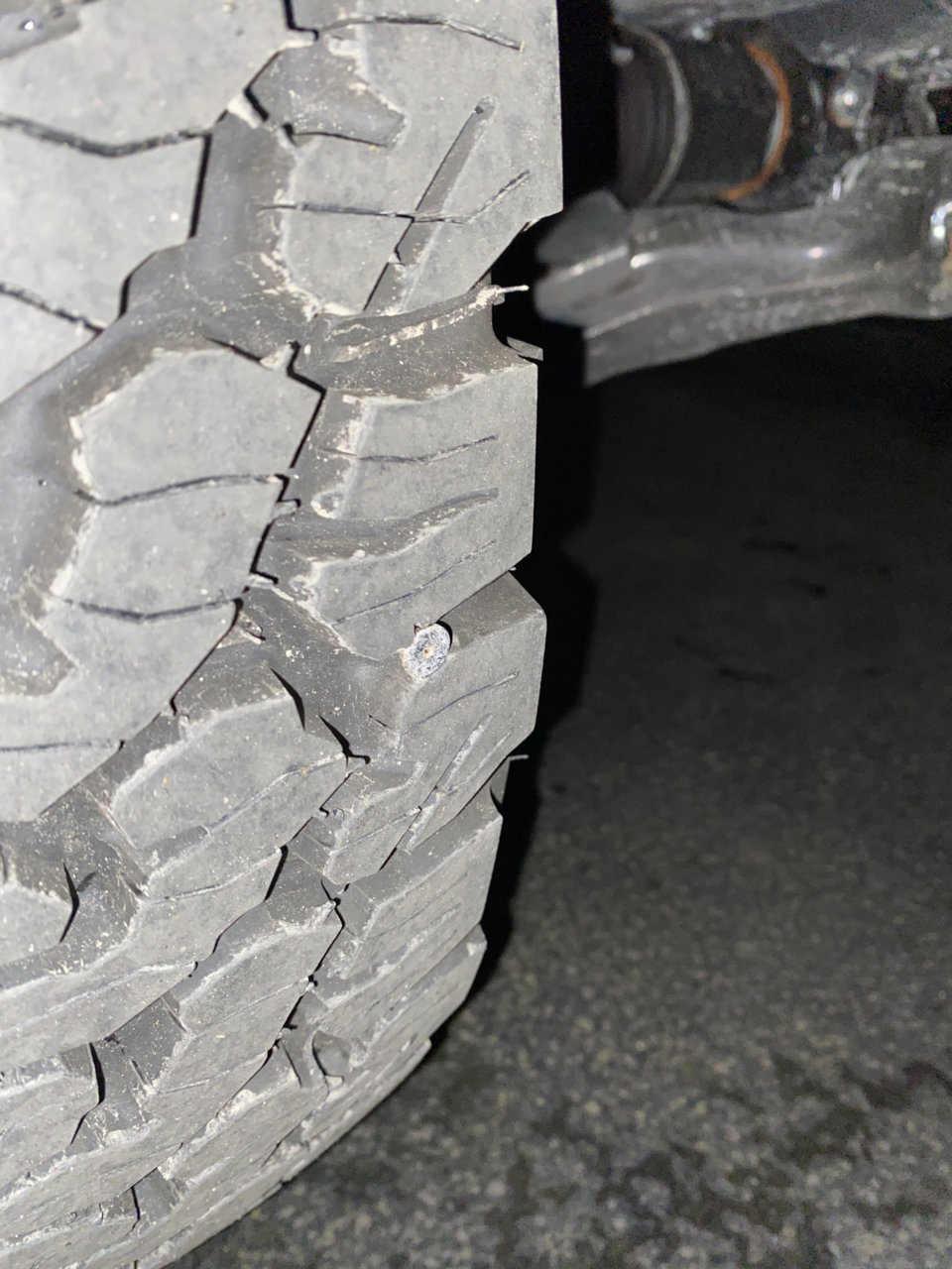

    While installing some new fog lights today I found this nail in my pretty new 285/75/16 bfg ko2... (5k miles)
    Sorry I’m a newb. I haven’t noticed psi decrease yet... my Tacoma has 6k miles.
    I bought these tires from the dealership as part of my suspension upgrade.
    where, who, what should I do? Best route that’s $$$ friendly.
    thank you

    Get a cheap plug kit and plug it yourself. It will be fine. If you take it to a tire shop, they will tell you to replace the tire because it’s too close to the sidewall.

    Plug it yourself and keep it as a spare.
    The shoulders of the tire see tremendous amount of flex when cornering and when aired down. A patch or plug will not hold long-term there.

    Your safety is worth a new tire. Spend the money and replace it. By the way it does look too close to the sidewall and if it were me I'd replace it.

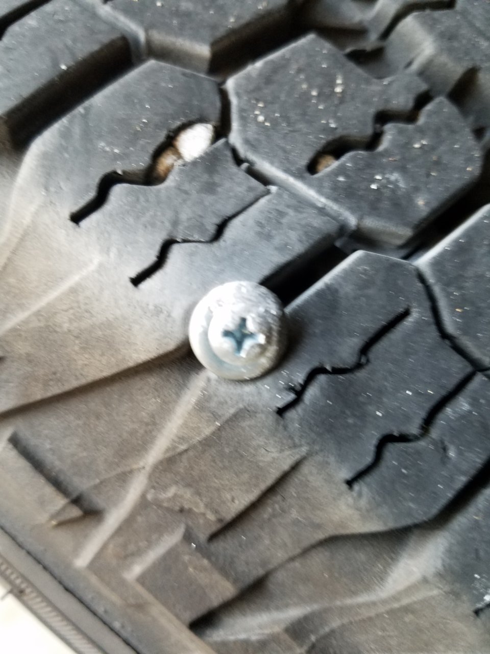

    I would take it to a tire shop and get it repaired. I had a screw removed from mine (for under $20) and put another 30k miles on that tire.

    I just seen the position- i think I read the rule of thumb as the first lugs from the edge are a negative.
    Mine was just past, walking the tight rope

    Professionally on a customers vehicle I would replace the tire.
    On my personal vehicle I would patch it and keep on driving with it on the rear axle.

    That’s a patch or plug and no worries
    Don’t stress

    Pull it out and see what happens. It looks like a roofing nail, which are typically pretty damn short.
    If it does leak then take it in to a tire shop and see what they say.
    Edit- might also be a screw with the head almost totally worn off. Either way, if it hasnt leaked yet you might be lucky
