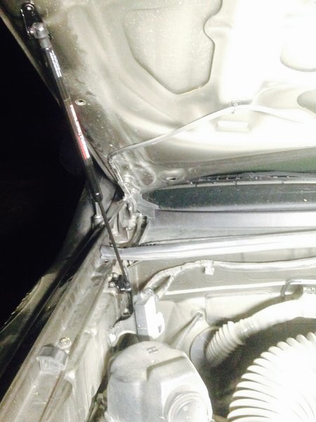

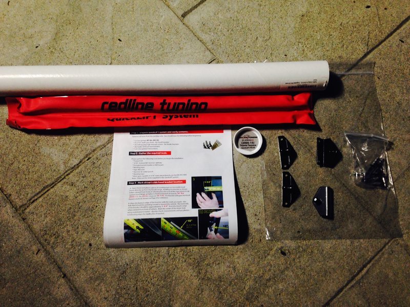

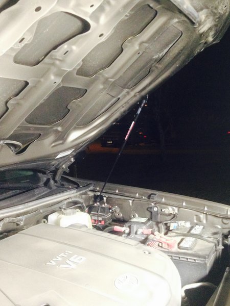

    Got some RedLine hood struts. Never realized how much they come in handy till you need to open your hood at some extreme angles for whatever reason. For me it's getting to the winch box to connect remote. I'd recommend them to anyone.

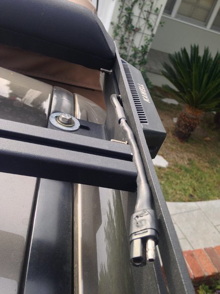

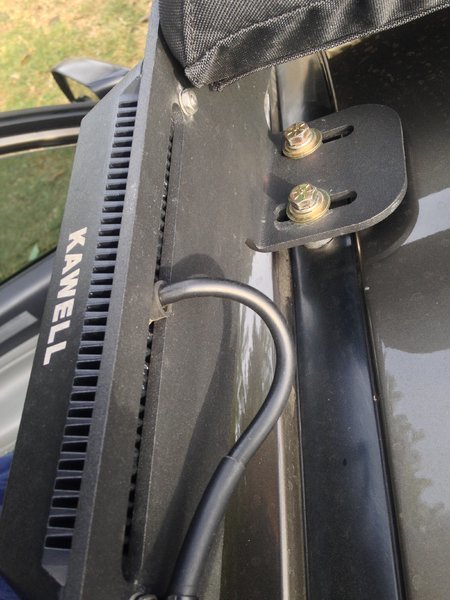

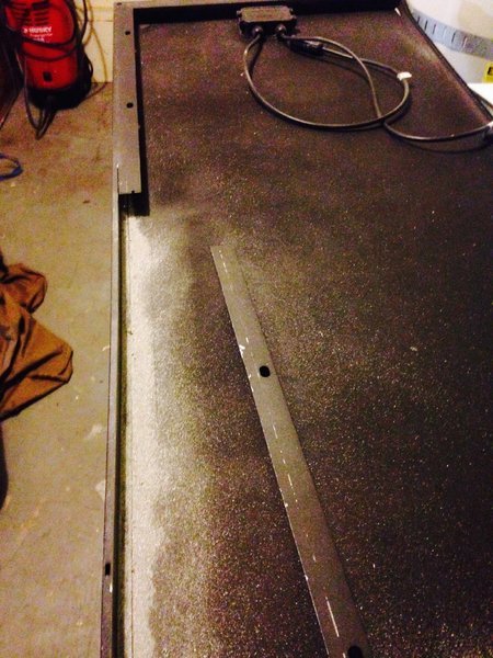

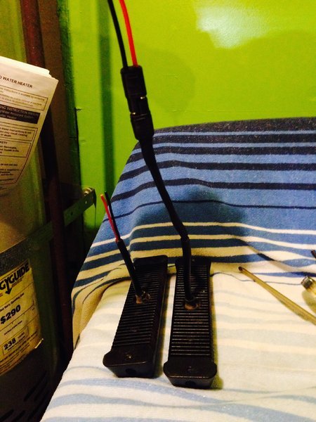

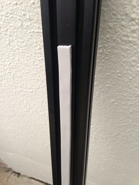

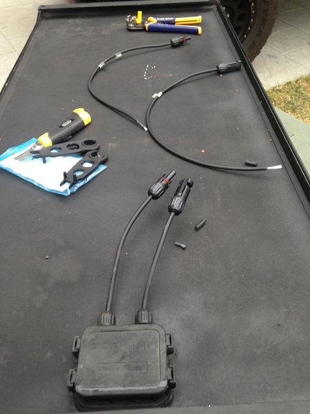

    I added some foam door sealer to the bottom side of crossbar to prevent some rattling of the solar panel making contact with bar.

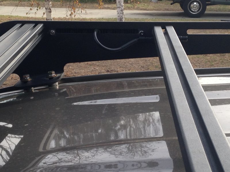

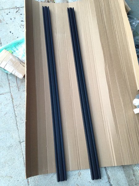

    Also got in some HD cross bars. They are a bit thicker than the normal bars so that required me to cut off some of the solar frame to fit. With the panel mounted under the bars, the thicker bars puts it closer to the roof. Without cutting it would make contact with the roof.

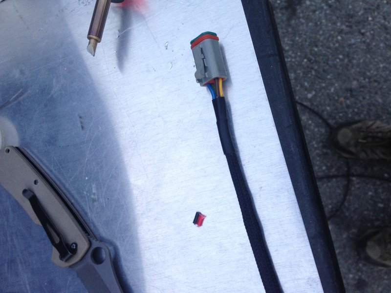

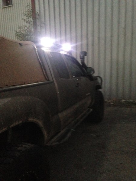

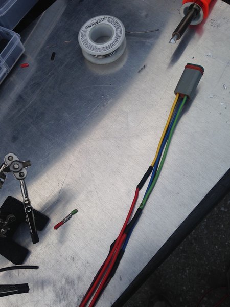

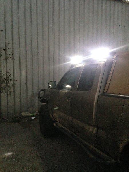

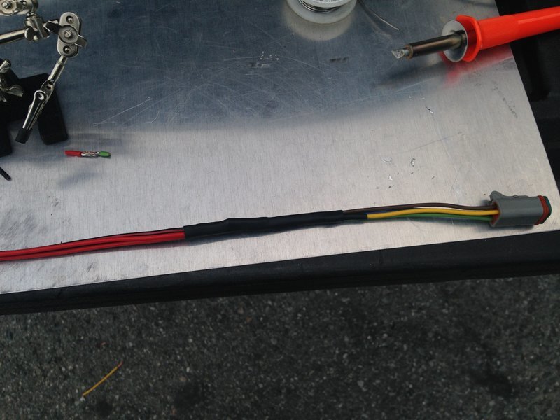

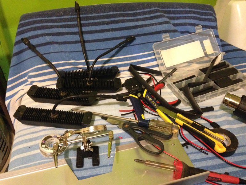

    Also got to working on attaching connections to the roof rack lights to get them wired up. Went this route because it was cheap and can be unplugged if needed to remove rack.
    Lights mounted with pig tails
    Made small notches in the cross bars to tuck in wires
    Shortened panel plugs to desired length
    Window foam seal used under cross bar
    Put edge trim on the cut panel edge then ran wires down drain channel and through window weather stripping. From there down and in through the bulkhead of the cab.
    Then used a 4 Pin Deutsch connector to wire up the roof rack lights
    Aaaaand finally working. Wired independent for left and right.

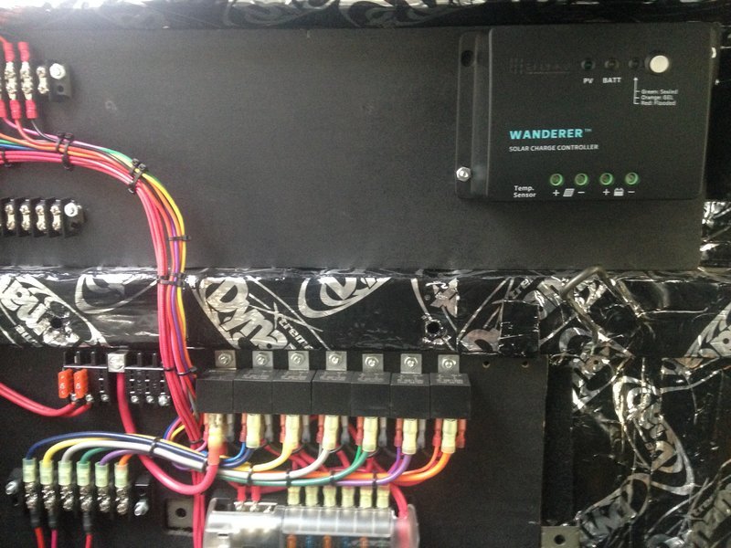

    Put the charge controller here

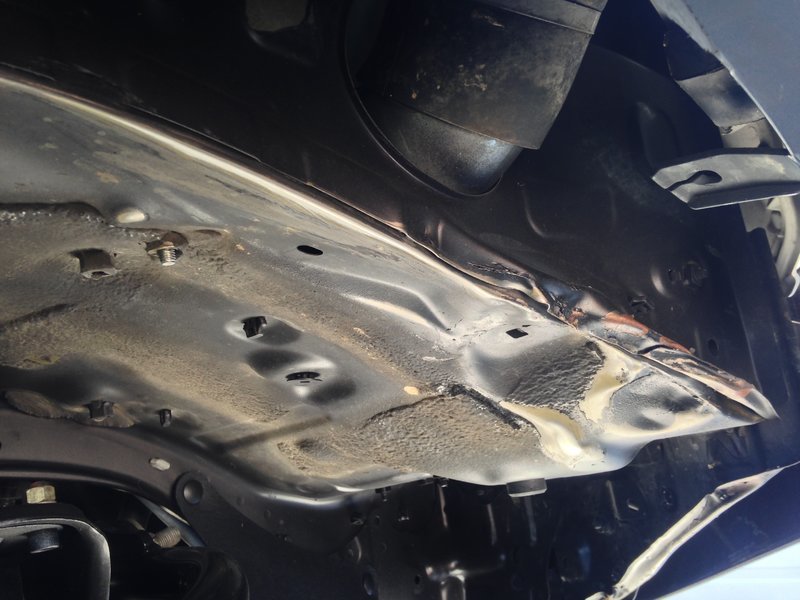

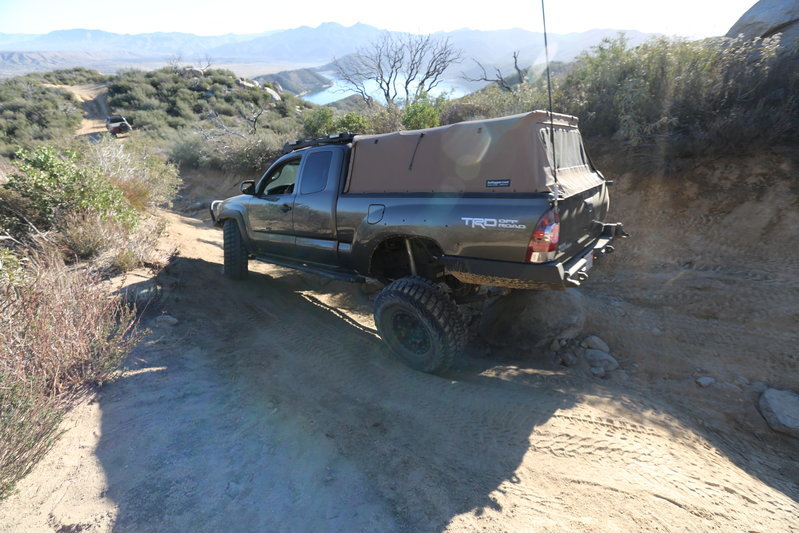

    Then I decided to do the SoCal Six Pack in 4 weeks so a few trips were made up to the mountains.
    Where I backed into some branches :frusty:

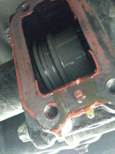

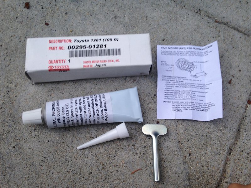

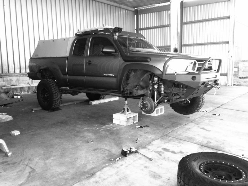

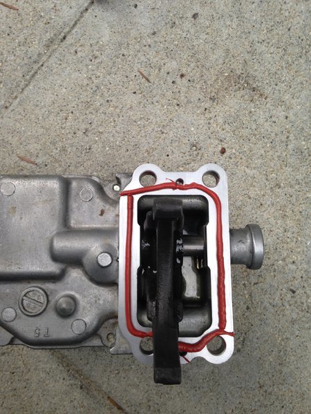

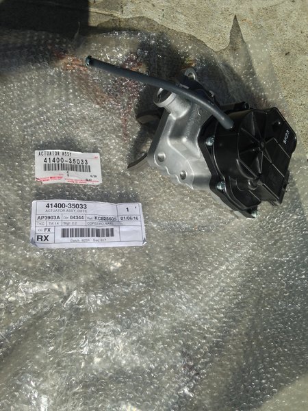

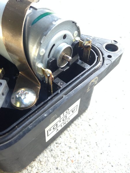

    After a wheeling trip my 4x4 was acting up. Determined it was the front diff ADD actuator that was bad by checking the signal pinouts on the connector. I was in a bind because I had another wheeling trip coming up in a few days so it had to get done fast. Purchased the actuator assembly part number 41400-35033 from Toyota. This one replaces all older versions and is damn expensive.
    After taking out the front ADD actuator and opening it up, it only turned out to be the two prongs on the motor. Added some solder to them and all was well. Further information can be found on this informative thread here.
    Two positions for the ADD sleeve in differential
    Cleaned everything back up and resealed with Toyota red/orange sealant part number 00295-01281. Then returned the new actuator.

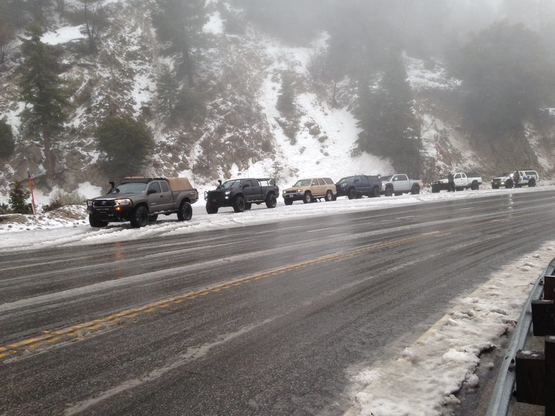

    Then took a trip up to Big Bear to have some fun in the snow. Only two tacos in the mix of all jeeps but still a good time.
    Then went back up a few days later with a TacomaWorld group

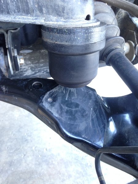

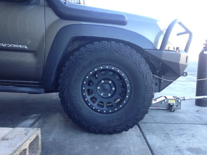

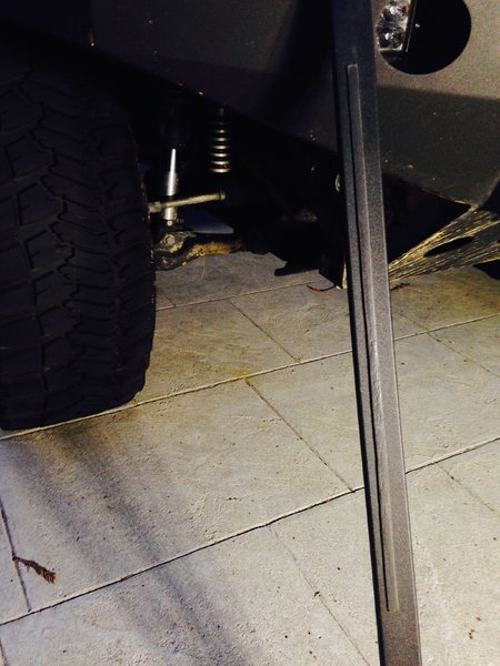

    Combination of self clearance and hammer clearance
    Added spacers from Wheeler's Offroad to the Superbumps
    Better
    Then after KOH. Luckily no damage!

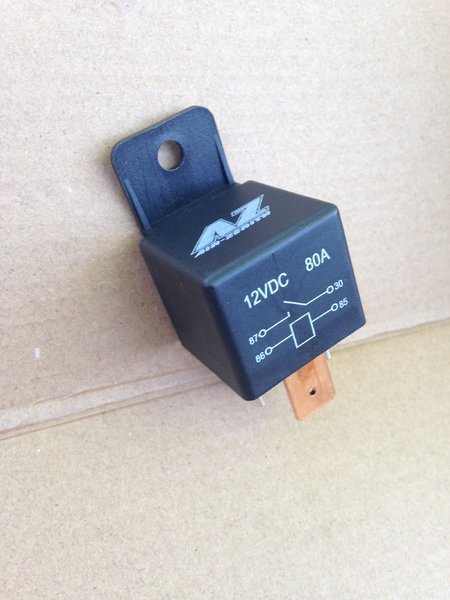

    This Air Zenith 80 amp relay was used to replace the 60amp one currently being used for the air compressor on the relay/fuse panel.

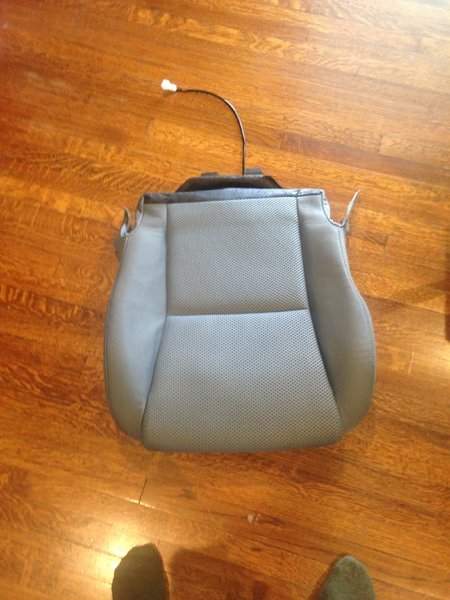

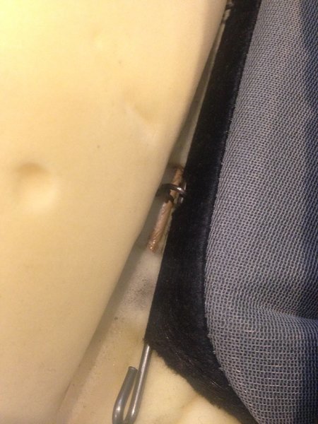

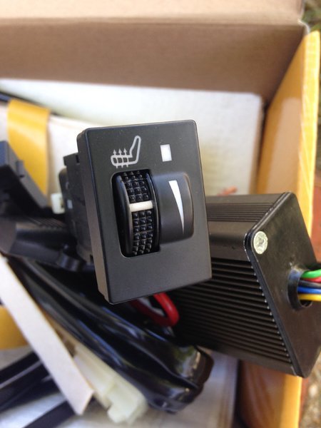

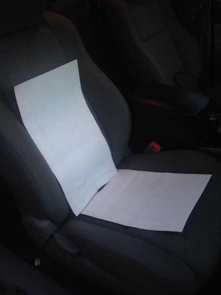

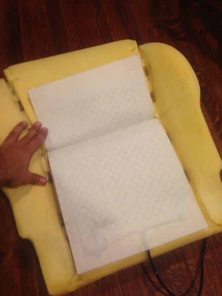

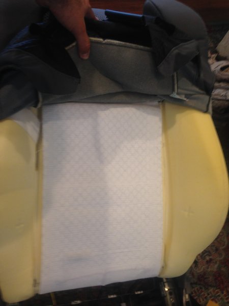

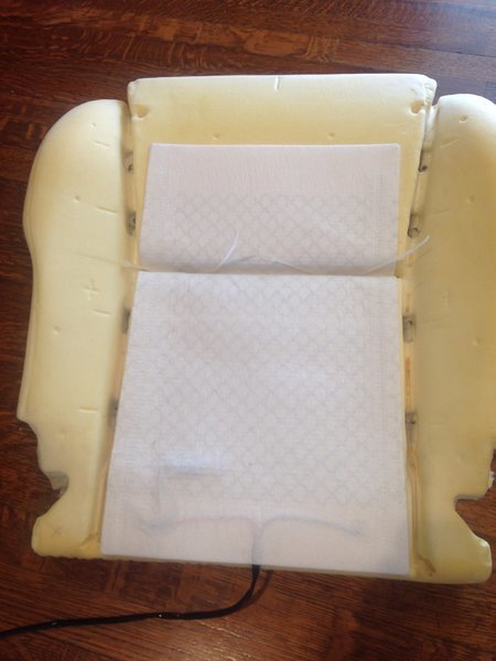

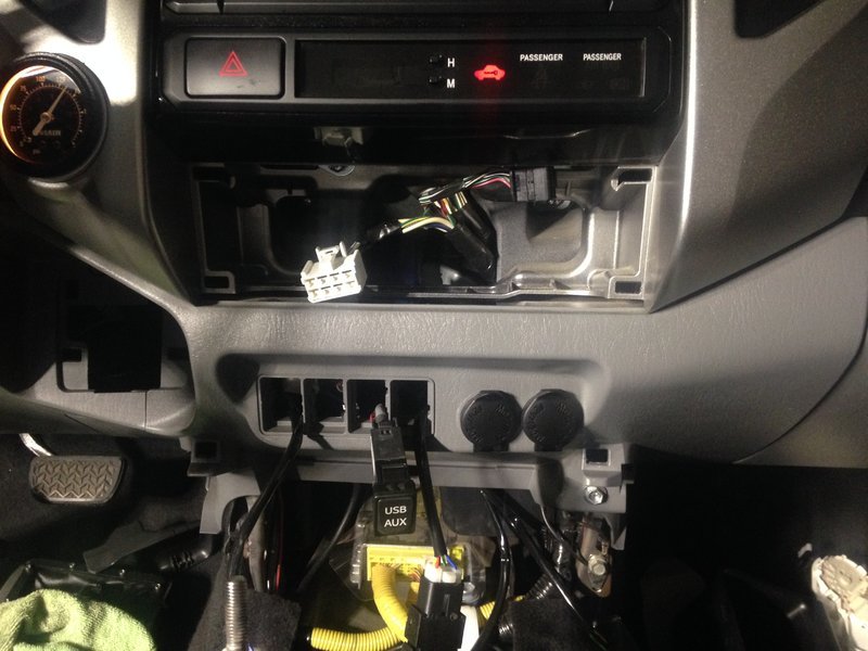

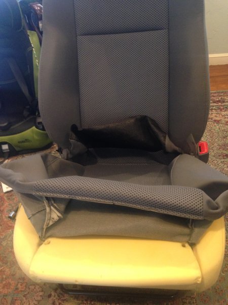

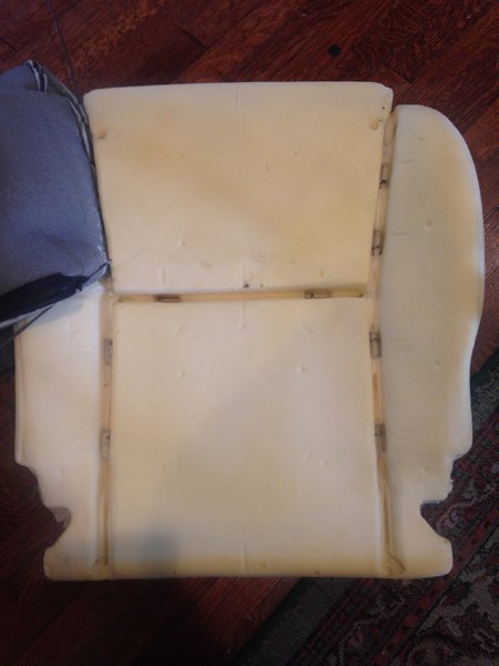

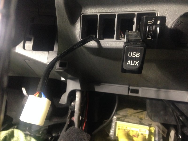

    Then decided to turn in my man card and get some of these! Seat heaters will keep buns nice and toasty and they are a hit with the ladies.
    From there I went at it and put these things in. No real clue what I was doing. Just tinkered and figured out how to take the seats apart and covers off.
    Hog rings holding covers on. Just carefully slid out bar retaining it all on.
    Place in desired location. Small cuts were made in the heating pad to get the metal rod through the hog rings and tucked into the seam.
    bottom done
    Now for the back
    Wired the switches to rear panel on a "keyed" fuse block to only be on with ignition then ran to two empty slots in the center dash. They fit perfectly and look factory.

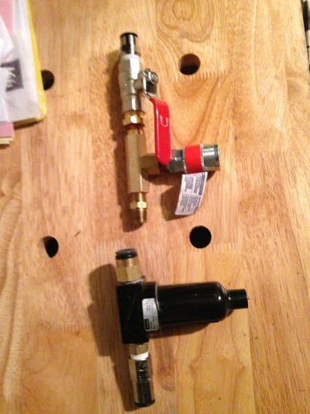

    Also decided to add a little to the air system. Out in a shut off ball valve and air chuck prior to the air tank in case the tank got smashed and ruptured I could block off that path and still run lockers and fill tires ect.

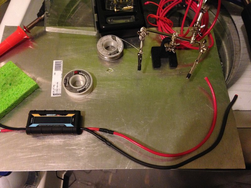

    Then got this Renogy in-line wattmeter to track solar performance

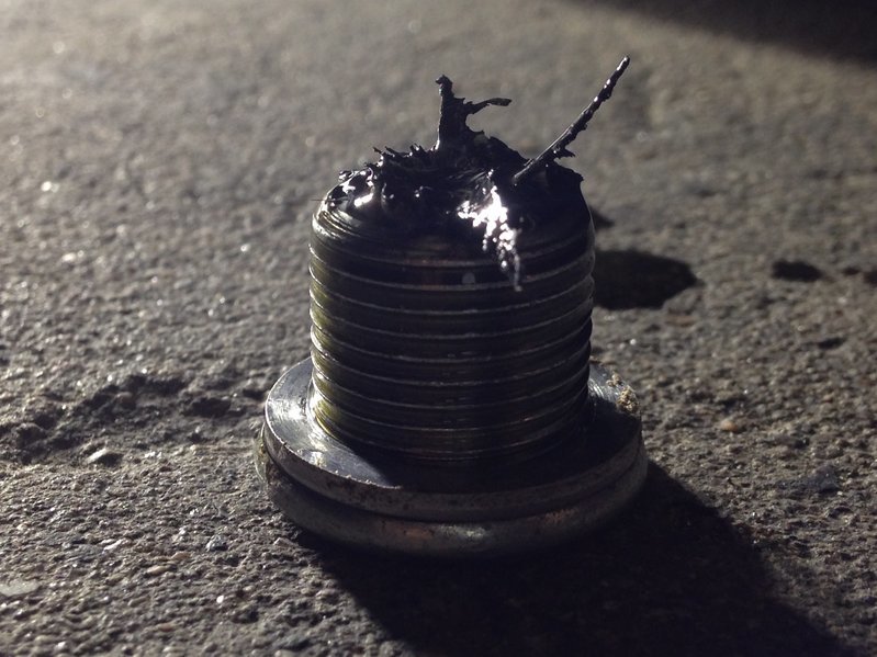

    On the way home I noticed an unfamiliar sound from the drivetrain.....
