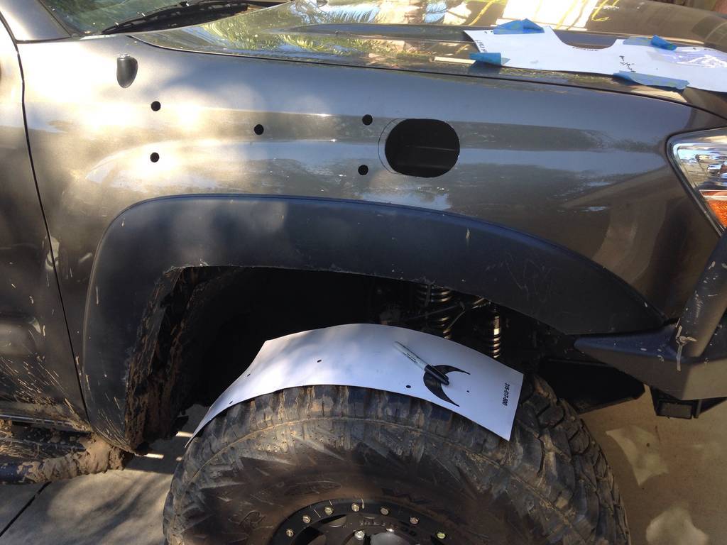

    And speaking of crappy, blurry night time install photos...

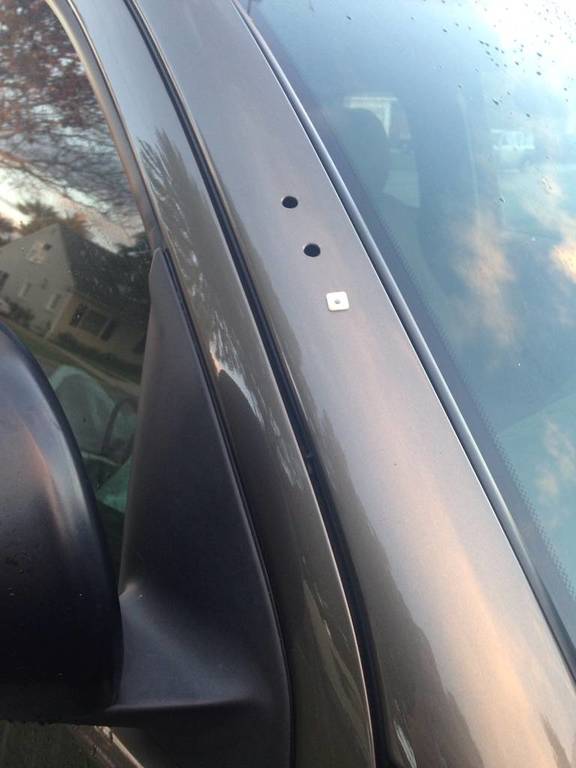

    Time for the snorkel to go on. Mud was getting up in the intake since taking the liners out to fit the larger tires. Nothing super crazy, but also not something I wanted to leave that way. This was back before the Sema show before ARB released the new 2nd gen model specific snorkel. I contacted Cruiser Outfitters for the Safari Snorkel. It's made for a different truck but modified to fit the 2nd Gen Tacos.

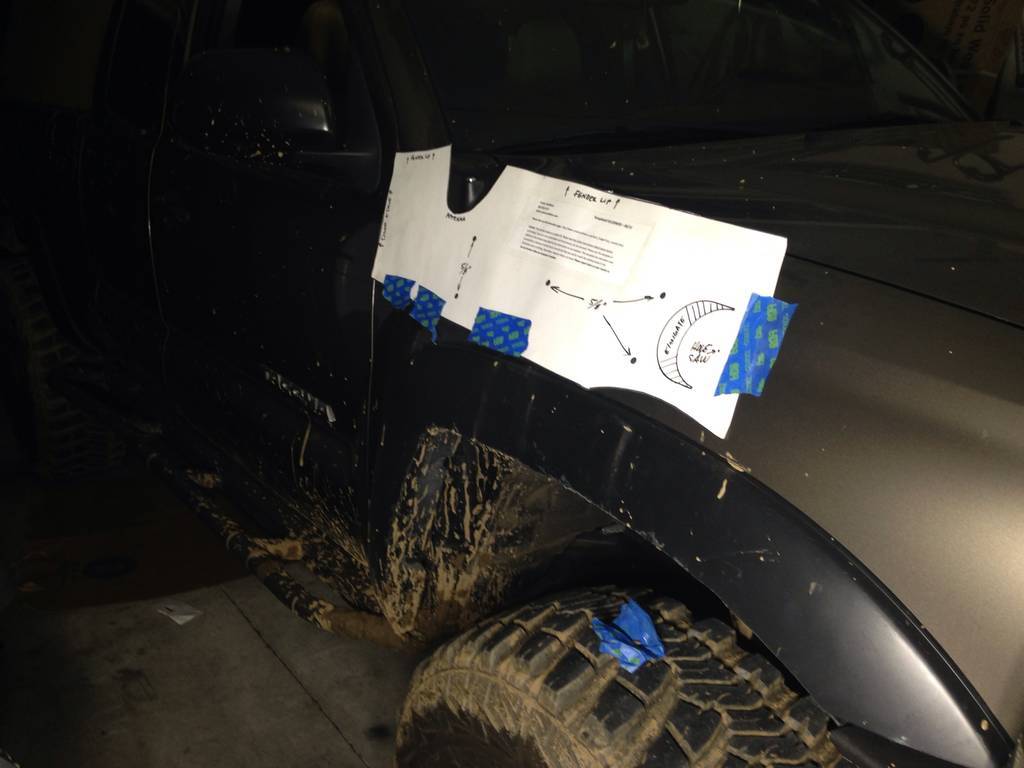

    I followed the detailed instructions HERE to help along the way. Many of members have posted their process and results to help anyone looking to do the same install.
    Tape up the template the provide for a starting point.
    Then use a center spring loaded punch to mark then drill pilot holes
    Take your time and elongate the intake opening as needed as well as drill out the mounting holes
    Only after checking fitment multiple times and tightening down the bolts to ensure final placement of the snorkel should you drill the A pillar holes for the bracket

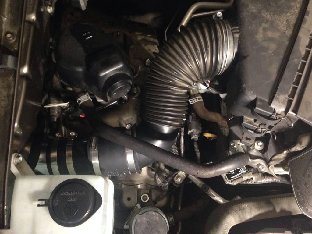

    I ended up cutting and reusing the factory intake tubing and just used a few different hose clamps and tubes to get the fit just right
    From right to left would be:
    Plastic snorkel body with trimmed outlet, trimmed supplied 90 degree bend rubber connector, 30 degree 3" tubing, 3" rubber connector, straight 3" tubing, can't remember but I believe next is a larger than 3" hardware supply rubber connector to the cut factory intake tubing. You can eliminate a few of those if you were to have a longer end after the 3" 30 degree bend. That's just what I had on hand at the time.
    Factory intake holes were plugged to make it a sealed intake path. Put your hand over the snorkel intake tube and the engine will cut out. Sounds legitimate to me.
    For those looking to do the same, I tried many different degree bends for the intake tube connector and found that a 30 degree bend would be ideal to get the angle just right to fit and line up with the cut factory intake tubing. That's 3" tubing by the way. Like many others, I ended up cutting quite a bit of the snorkel plastic off as well as the rubber hose to be able to line up with the factory fender well hole and not have to cut it open larger. Unfortunately I don't have any photos of that or during the process but similar installs can be found in the linked thread above.
    I did sand/shave/file some plastic off the snorkel body to get a better fit to the fender. It helped to conform it and lessen the gaps a little to not look out of place. I'll try and get some photos of where it was filed down next time I have the snorkel off. Off the top of me head, it was the very forward bottom edge and the rear end before it bends upward up the A pillar. I just tightened the bolts and saw where it was rubbing then removed and filed away.
    I also used some color matched touch up paint you can get at the dealership on all edges that were drilled or cut before final snorkel install. I'll try and get more detailed photos up later. I will say that it was a pain in my ass to install that thing. I've read many had an easy install that was quick and smooth. Mine definitely wasn't like that. Lots of installing, measuring, uninstalling, cutting, reinstalling ect.. Did that a few dozen times before it was just right. You don't want to cut too much off the screw yourself and be able to go back. Take your time.
    A few with it on

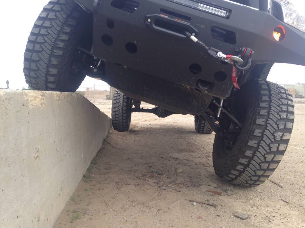

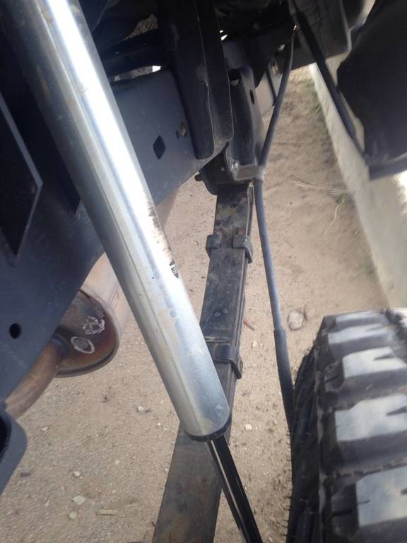

    And testing travel and clearance again
    Gotta keep an eye on that parking brake cable. It was super tight and rubbing the inside of the tire here. Might take off that bracket and do some sort of spring retention. We'll see.

    Looking good!! :thumbsup: I am having the same problem with the e-brake cable. Probably going to have to disconnect the bracket

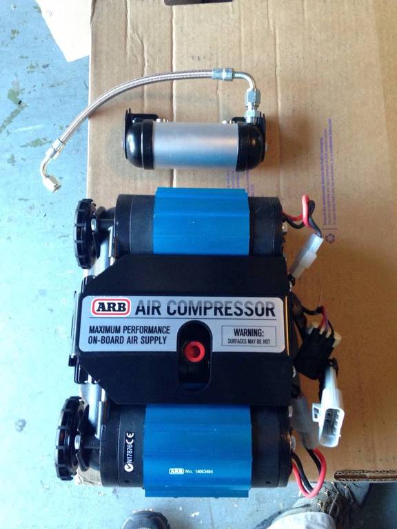

    Now I need to figure out where to mount these. Any suggestions? Access cab space is pretty limited. I'd like to utilize unused/hidden spaces. Thinking about bolting underneath the bed somewhere to have a short run to my second battery location and extend the breathers up to the bed rail area. Might make a bracket to bolt manifold to compressor and hopefully make mounting easier.... Ain't nobody got time for that.

    Nate,
    That compressor is on my list too, and I've been thinking of places as well. I had one idea to put it in the engine bay on the passenger side, however I worry about the heat in that area.
    There's under the truck where the spare tire goes, but that also exposes it to the elements. My other idea was in a tall ammo can in front of the wheel well bolted down in the bed.
    How wide is it?

    Iggy,
    Do you have a double cab or access? Can't really tell from your thread. But if double, guys have put it behind the rear seat.
    I've also thought about in that under hood spot. One member(mik4stlcards) here has pulled off the best example of that location I've seen HERE. I'd still need to mount the manifold and eventually run plumbing for an air tank in the rear so I'd like to keep it close to the future tank and second battery in the cab but that spot might end up being my best bet.
    I was thinking under the bed as far forward, near the cab, right above the drive shaft area. And just making a simple splash guard with sheet metal or something for rocks and some water. Being in SoCal we don't really worry about water, and from what I understand, these are really resilient to the elements as long as its not submerged while operating.
    The bulk of the compressor body is 11"W x 8"L x 4.5"H
    The wire stick out a little more though.

    I have an access cab too. For a second I thought the same thing after seeing your wiring in the back. You only see that done on doubles.
    That is a sweet looking mount, since I don't have the ABS pump in that area I thought of mounting the ARB 1gal tank there with the compressor on top, but I wasn't sure if the unit was too big. It looks like that might work! The heat is still an issue, but you can probably run the manifolds to a cooler spot.
    The second idea is great and you can run the manifolds into the bed to keep them out of the rare water. Lastly, if you mount the tank make sure it's a position where you can drain it from time to time to make sure you don't build up water in the tank and send it off into the tires, or worse into a locker.

    Right on. Yeah, like I said, I'm trying to put things in unused space and that's one of the reasons why I went with the wiring back there vs under the hood.
    You are lucky! I have that smog pump there but might be able to relocate it. I'll have to look into that some more. As for the heat, I know compressors get pretty hot when on and the hotter electronics get the more resistance they have, but for how little it'd be used, it may not be a problem. Many other have them mounted under the hood without issue.
    As for the tank, I'm thinking where the spare tire used to be with drain orientated down. I'll have to look into water separators for that crap when it comes time for that.
