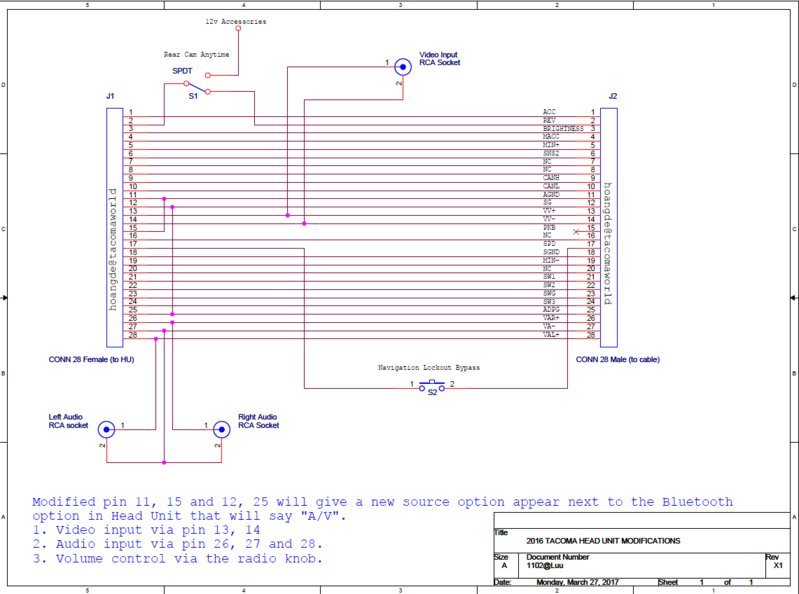

    Dont mean to revive this thread but is ABC the only shop that sells the map override?
  7. Jun 28, 2020 at 1:38 PM

    I think u can do it yourself, all it takes is cutting a wire I believe. Look into the "HAI anytime camera" thread

    This harness is plugnplay right? I wanna wait for the other guy reply first before looking into your suggestion, but i definitely would choose the plugnplay option :D

    It's not plug-n-play, but it is cheaper, so take your pick. I used this harness because I also wanted to do some other things like having front and rear cameras and being able to force either camera on while in motion. Nothing existed, not even the $150 cable would have done exactly what I wanted. I also don't want to cut into my main wiring harness - words of advice my father gave me growing up.

    If you want it to be permanent cut wire 17, if you want to keep your teenager from doing a nav search while driving add the switch.

    Im gonna buy 28pin like @seattle_taco suggested and cut the wire from that harness, i dont want to mess with the oem harness just in case something would stop working :D Tnx

    I cut that wire on the back of the head unit a year ago, no problems since. Plenty of threads here on it if you search.
