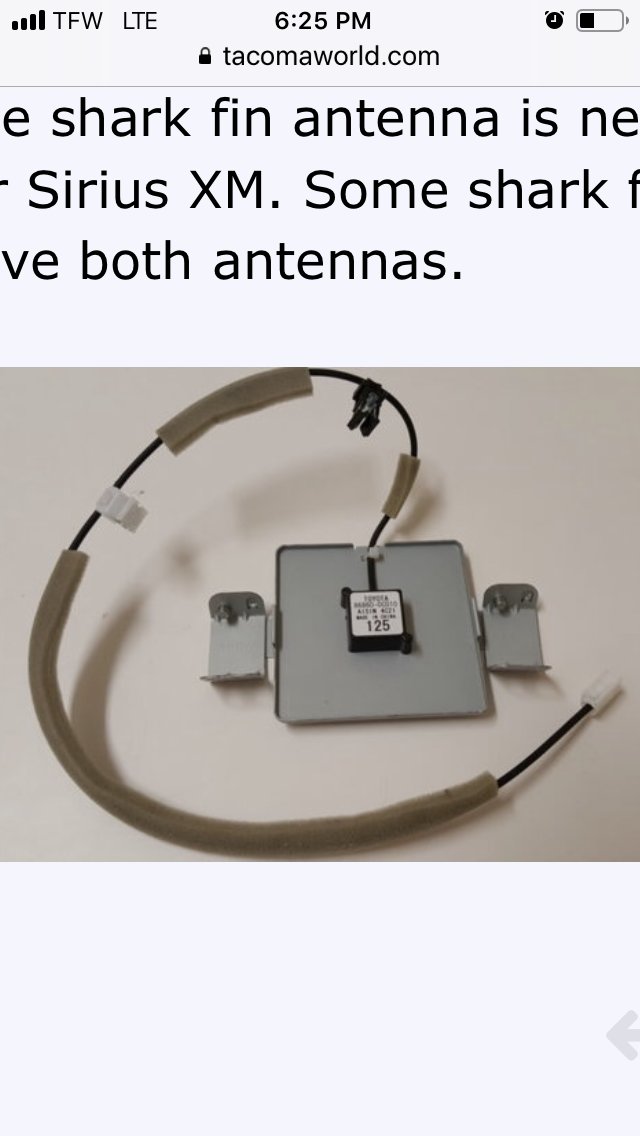

    8EB09D80-C7B5-48B7-91C5-4B3679E97AE1.jpgI haven’t verified the actual box part of the antenna but I have this wire that is wrapped in the foam coming to the back of the head unit

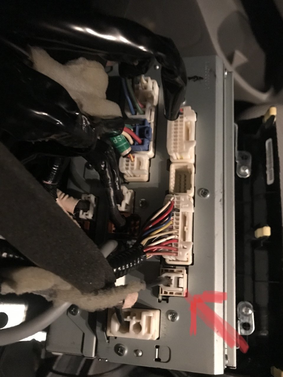

    004757F4-D1BC-4276-8B01-093DAF76198B.jpg 7E785997-AF5B-4BBA-9C73-1A385D28EF92.jpg
    I am really struggling with this nav unit. I pulled the radio out and I believe the red arrow is pointing at the gps antenna that is plugged into the back of the radio. But also on the nav screen it is showing the gps with a red line through it. I kinda got the nav to work somewhat. It will recognize addresses and routes to get there but no matter how much I try to calibrate where I am with the little triangle it never stays on the roads. It will be close at first but the farther you drive the farther away it gets. Does it not automatically sync where you are to the map?

    You appear to have it correctly installed, as the white connector goes in that location and the black one goes in the Sirius Sat radio. Did you try the Sat radio to see if it worked? Even if you don't have subscription it will come on partly. Correct me if I am wrong but doesn't a Etune radio require that you activate it with a correct US VIN code? if so was this done. If the Sat radio works maybe try switching the leads as they will plug in due to being the same type connector.

    The red line through the GPS is because you're not getting a signal from the satellite. No amount of "calibration" will make it work.
    (you may have a bad antenna)

    And of course it gets worse. The Tacoma uses a rare white, rounded GPS connector while most Toyota GPS plugs are square. Aftermarket antennas use a screw on mini connector.
    If it is a bad antenna - and that's what it looks like your choice is a OEM GPS antenna for around $400-700. (Yes really) or a used $150 eBay one:
    https://www.ebay.com/itm/GENUINE-TO...=item3f52f83f49:g:CfUAAOSwZd1VcnfB:rk:14:pf:0
    The 12-16 Camry antenna has the white connector. Also $150. But it may not work.
    https://www.ebay.com/itm/2014-2016-...=item442b3f6b44:g:Sy0AAOSw6VRaCgMU:rk:46:pf:0
