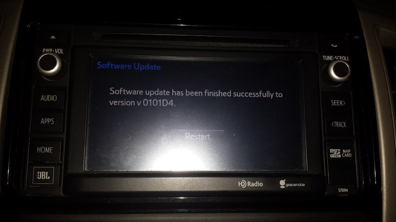

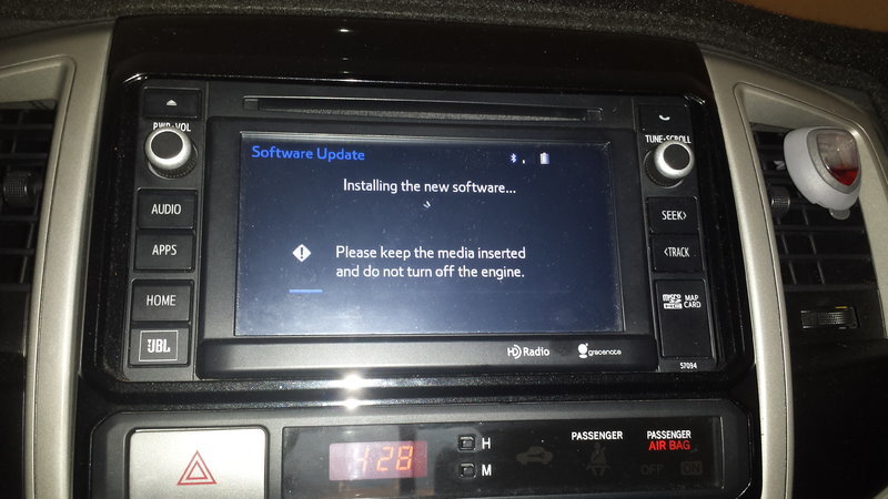

    I just purchased a SD navigation card from a member on Ebay. The Ebay member sells genuine Toyota SD cards for $90. My navigation was running on 2013 maps. It took 3 days for it to arrive. I just pulled out the old card and stuck the new one in. My radio automatically detected the new card. Then the radio rebooted itself then it begin to update software. The process took about 10 min then it restarted. I'm running on 2016 maps now. I noticed some changes. One, I only had two options when I hit the compass button. North and South was only shown horizontal on screen. If I hit it 3 times the map is shown flat vertical. Two, the streets names would only show on the bottom of screen when a destinations was set. Now with normal driving it shows street names with speed limits. That's all I noticed so far. I don't know why the stealership is price gouging us for the installation process. When they don't do jack but stick it in and walk away. CRAZY!!!

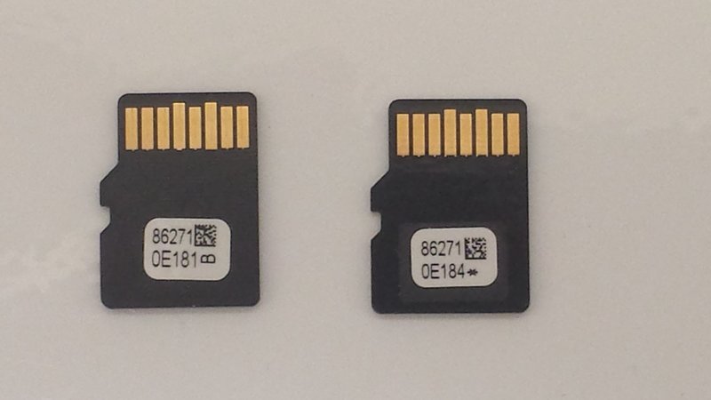

    I just installed the new SD card yesterday. I bought it from eBay for $90 (plus the Ohio sales tax I will owe when I do my taxes next year). The new card is OE184, while the old one was OE182. My Audio code went from 0101D1 to 0101D4. It was not necessary to start the engine. I just turned the key to the accessory position after swapping cards.
