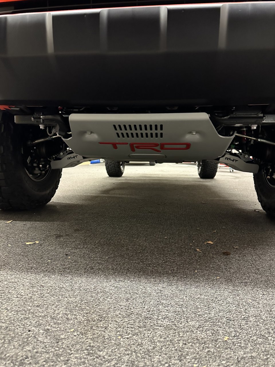

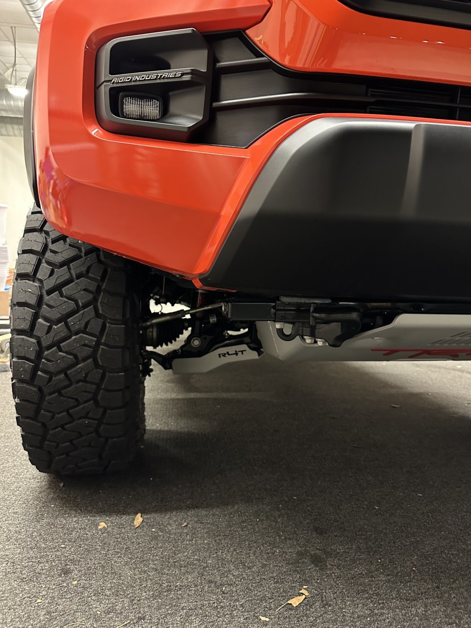

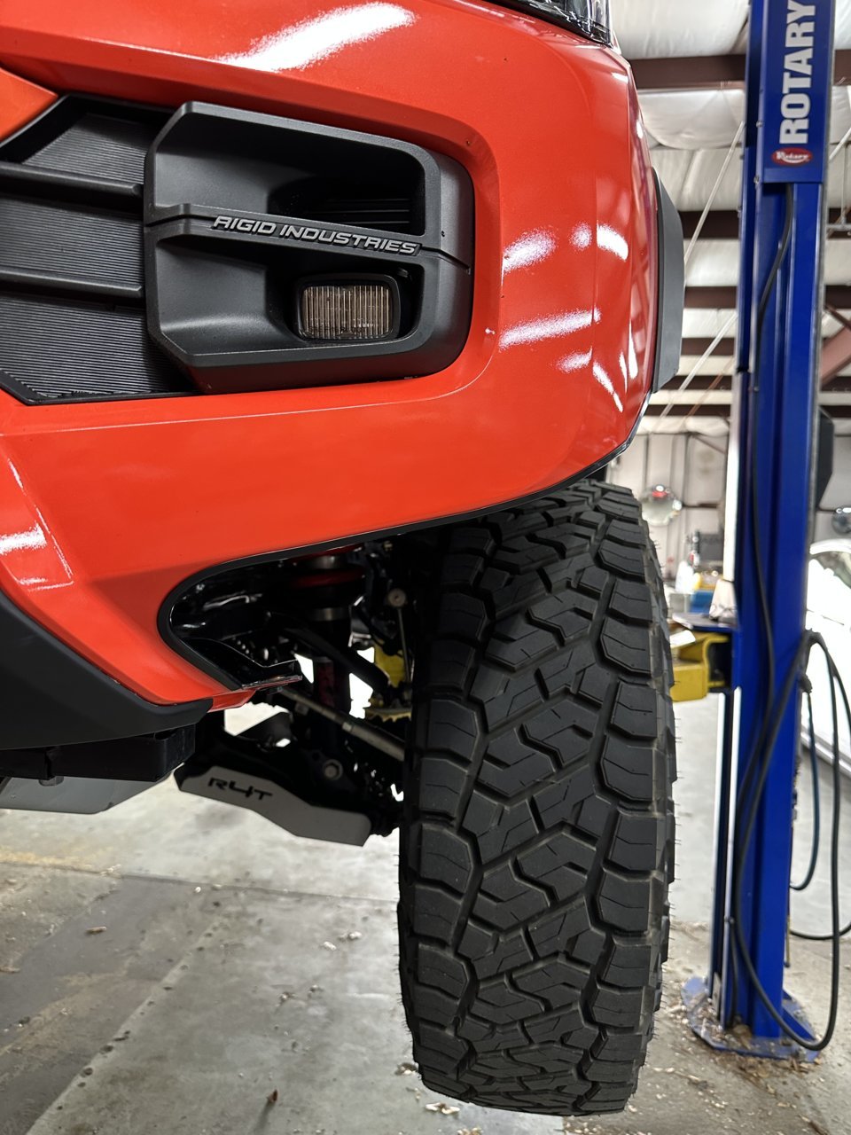

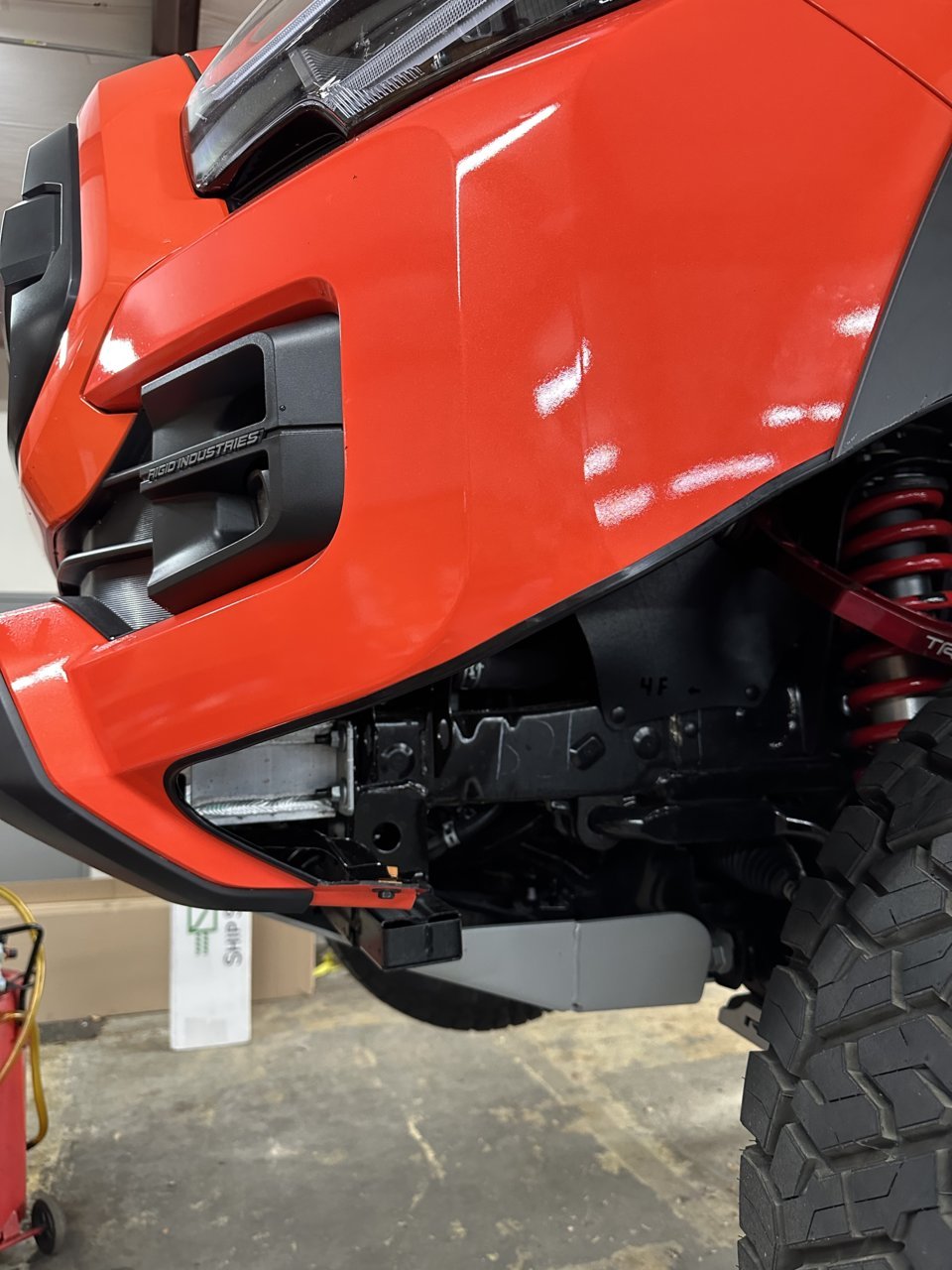

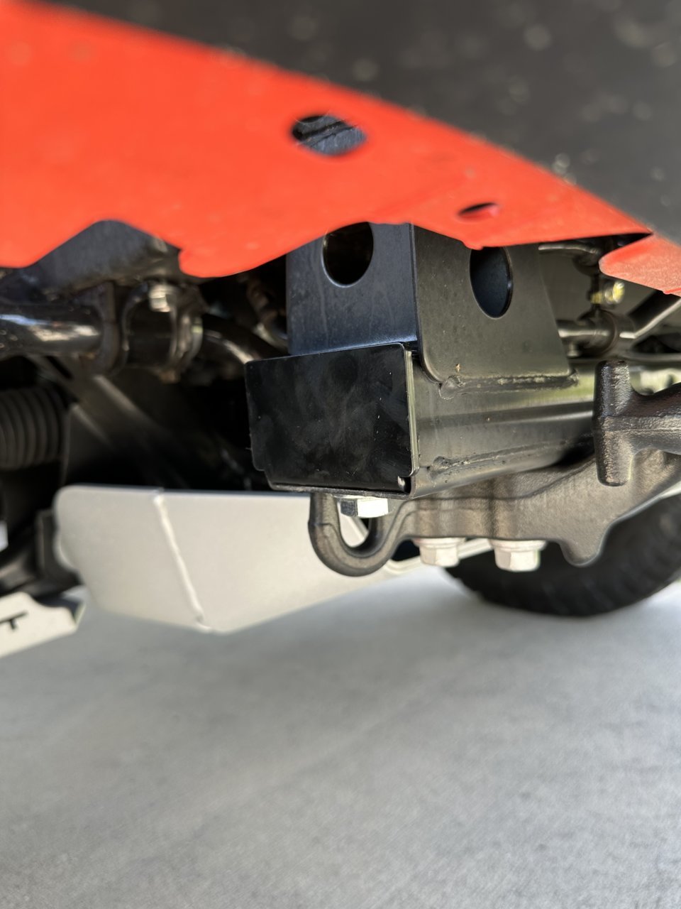

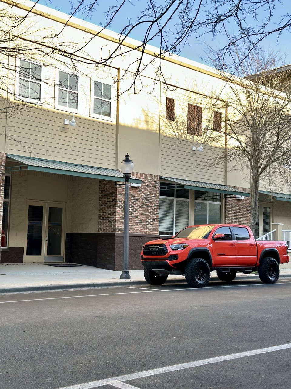

    Added Runnin4Tacos LCA skids. I think they tie in very nicely with the OEM skid plate. Easy install.

    Are THESE the ones you got? they are listed for 2016-2022 Tacoma and they couldn't guarantee me they would fit the 2023 as they haven't tested it.
    Thanks!

    yep! that's them

    awesome - glad to see they fit. I'm going to order a set.
    Thanks!

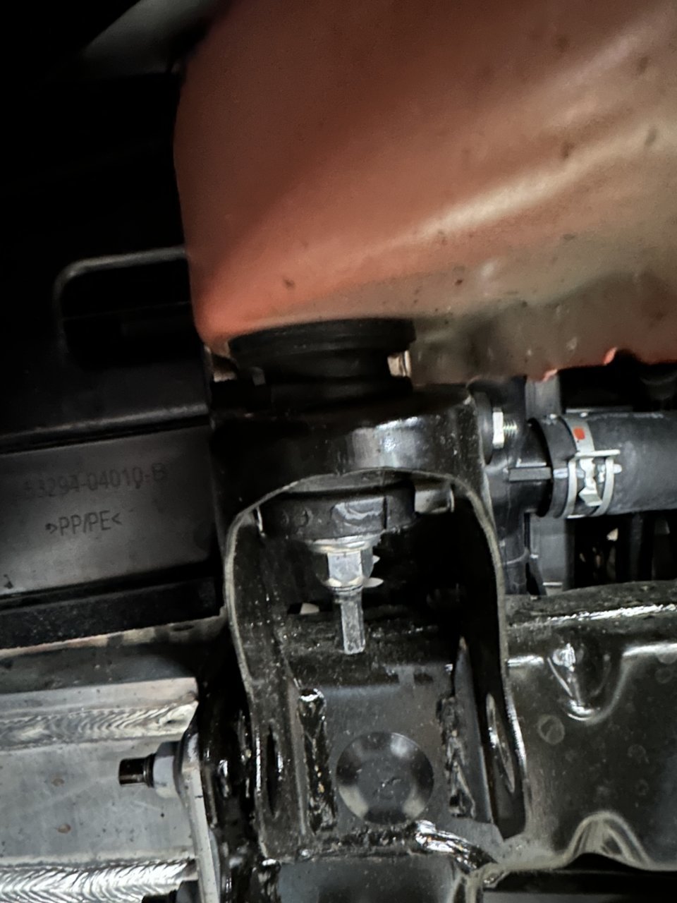

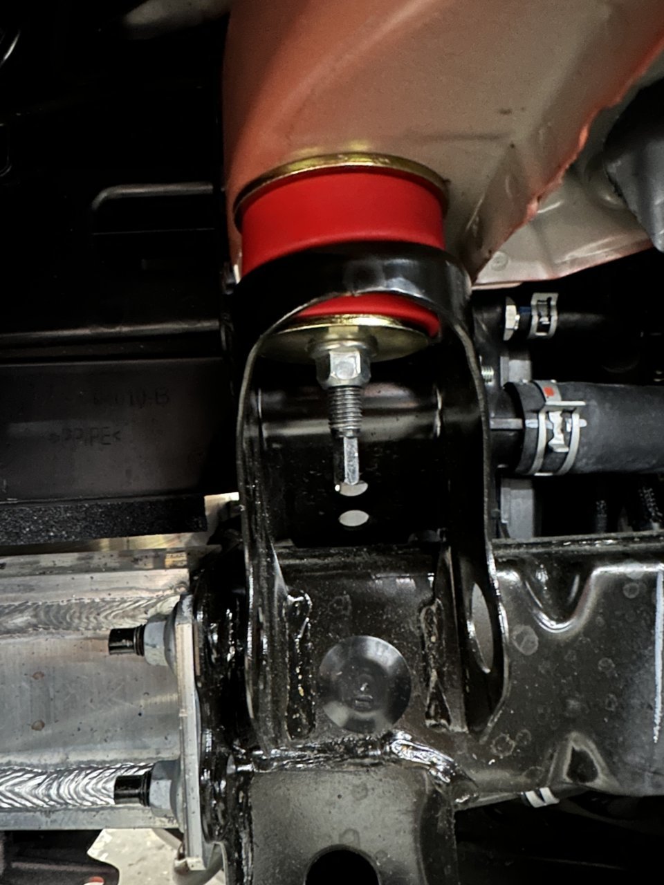

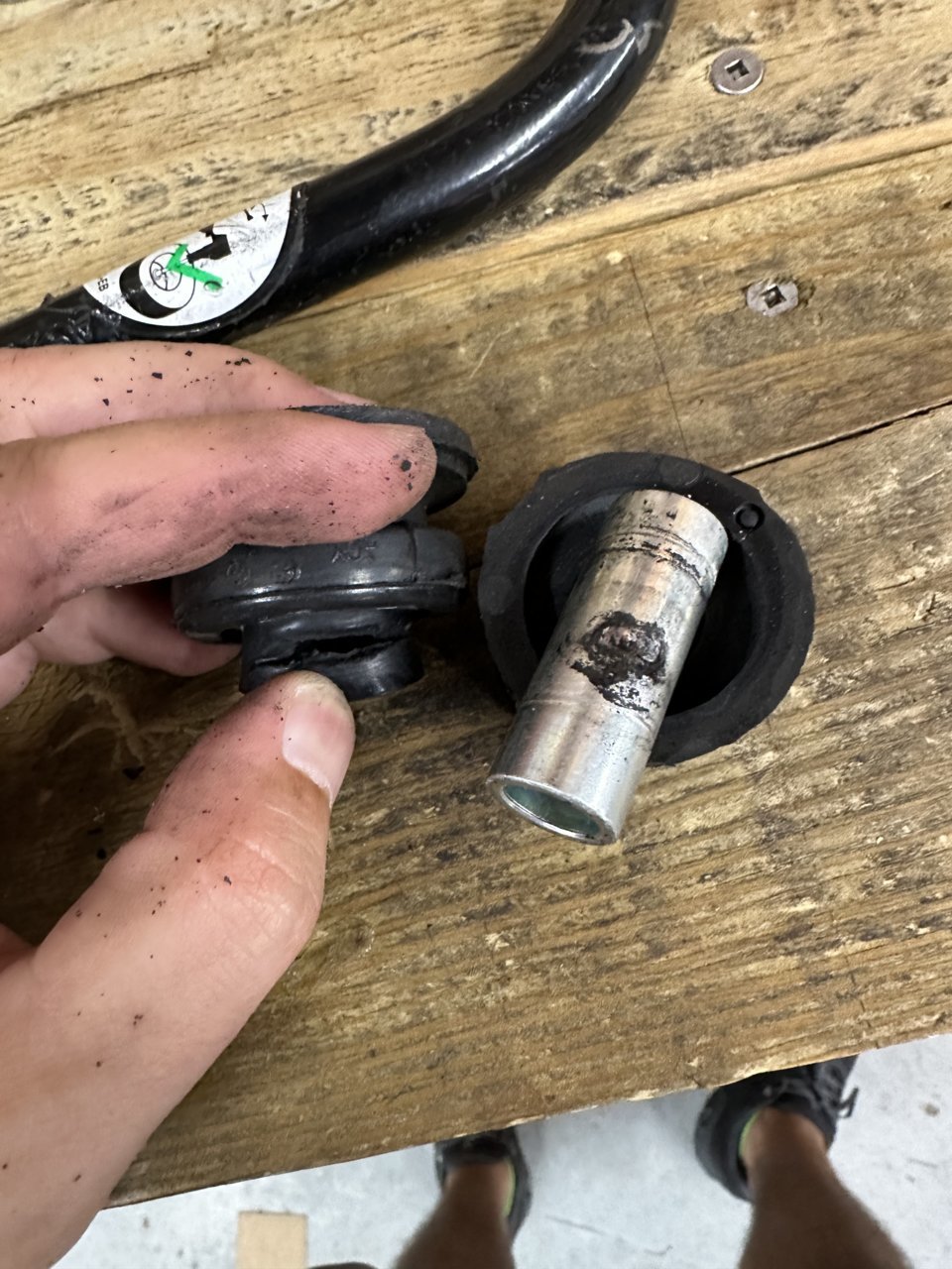

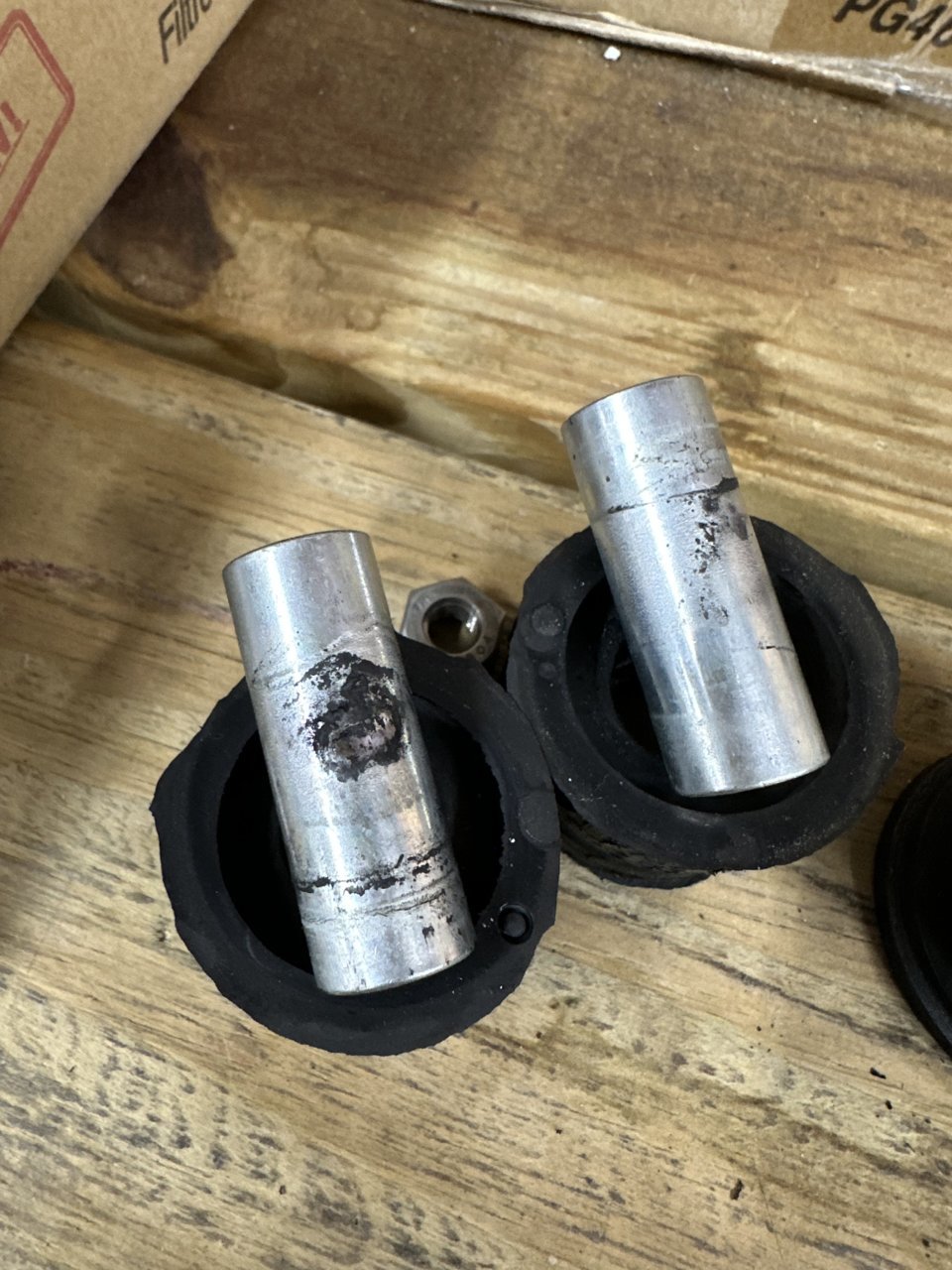

    Had an absolutely horrendous creak in the front end that I think I was able to chase down. The driver side radiator support/body mount had failed. Apparently it’s somewhat common. Only have 2,400 miles on the odo which is surprising but sure enough.
    Failed bushing and metal sleeve shows signs of rubbing on the support bracket causing a terrible creak.
    here is the comparison of the passenger side that seemed fine
    Here is the new Energy Suspensions Poly Bushing

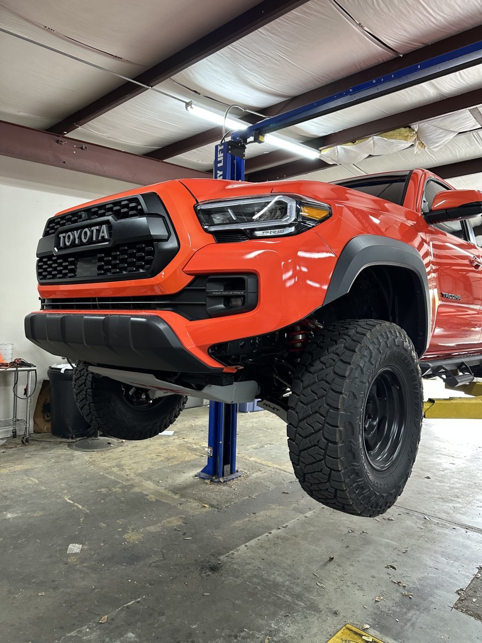

    And instead of removing the bumper or wheel liner for access, I took it as an opportunity to go ahead and knock out a viper cut. Originally planned on doing it down the road but figured I’d go ahead and make the bushing swap easy on me

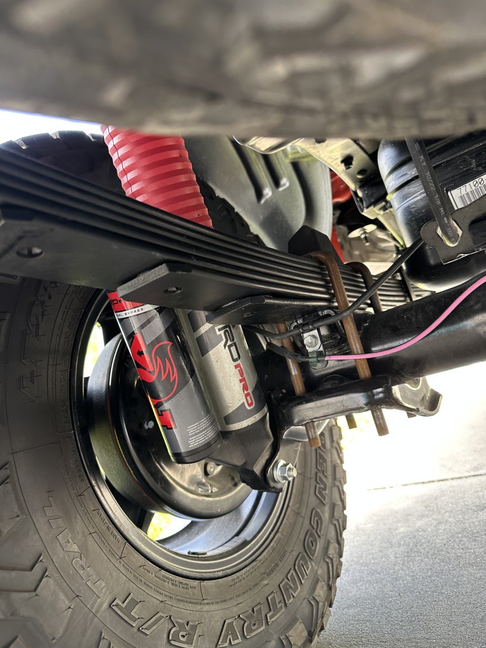

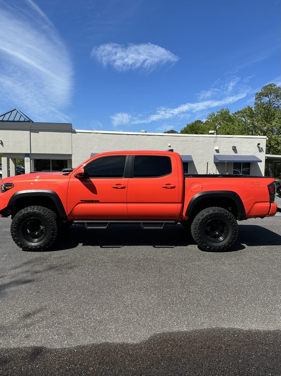

    Installed the Icon RXT stage 1 leaf pack. Definitely happier with the stance compared to the 1in rear block. Not really a fun install, but there’s definitely worse. Wanted to get more pics of the process but the new copilot got some attention instead.

    Also threw in the Square One Creations frame caps. Made it look a little cleaner with the recent viper cut.
