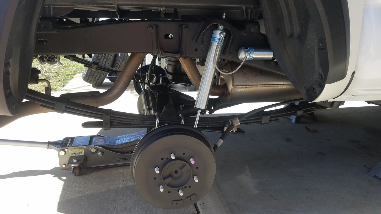

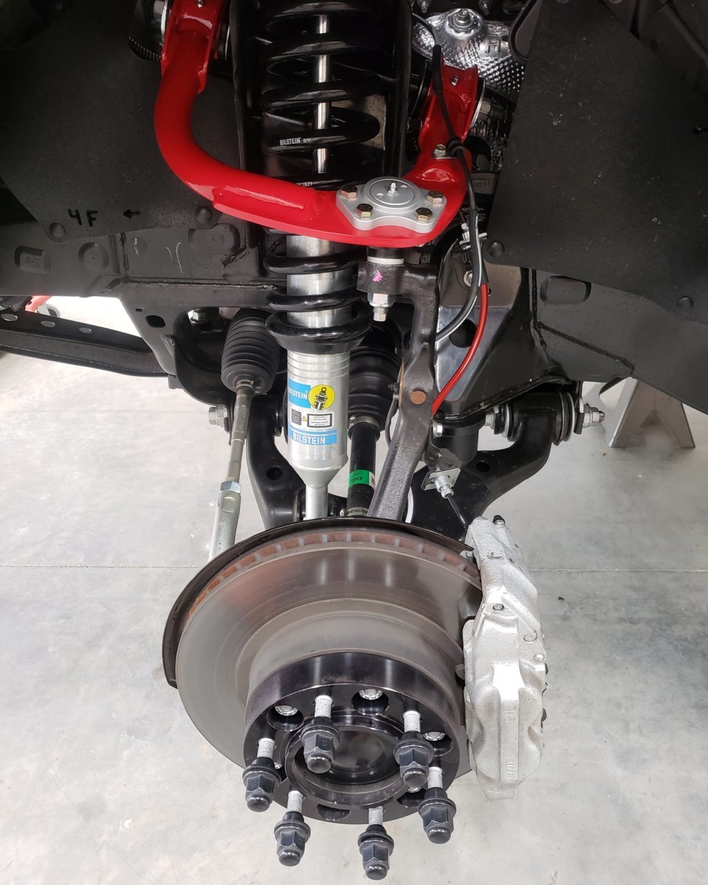

    Update: 6112/5160 install to be completed. Awaiting final parts to install. Will be running 285 bfg ko2 on stock wheels.
  5. Mar 6, 2018 at 5:48 PM
    NCtaco914
    NCtaco914 [OP] MALLIN'CRAWLIN'
    Oct 18, 2012
    #89268
    2,109
    NEIL
    NORTH CAROLINA
    17' DCSB TRD O/R

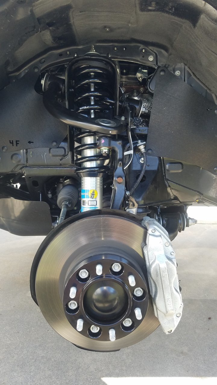

    6112's installed as of Friday along with the progressive AAL. Installed on 5th notch and as expected I got closer to 2.5"-3" of lift. Alignment #'s still turned out good imo with stock UCA's. Also fit full size spare (285) in factory location without much effort

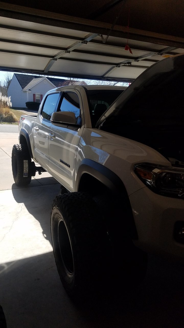

    Thanks! Yeah the 285's fit really nice and actually don't have as much trimming to do than I originally thought. On the progressive AAL I did have to cut the oem rear spring keeper to fit the new leafs. I chose to remove the overload leaf and cut off the e brake bracket to the overload leaf. Also used 1/2" spacers to move the e brake line away from the leafs at the frame

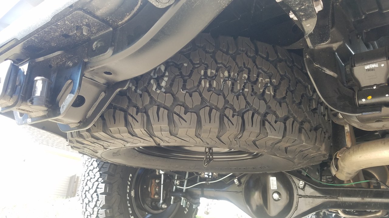

    That spare tire is huge. How in the world did you get that to fit

    Hammer and a little patience :D

    Wait, hammer? What did you do to make it fit back there. Killer looking truck.

    Well a good heavy rubber mallet was kind enough. Just to bend the metal tabs back a little to completely tuck the 285 up against the frame snug. Other than that, just winching up the chain is where it counts. May relocate my exhaust eventually. So far no issues at all and keeps a full size spare out of the bed

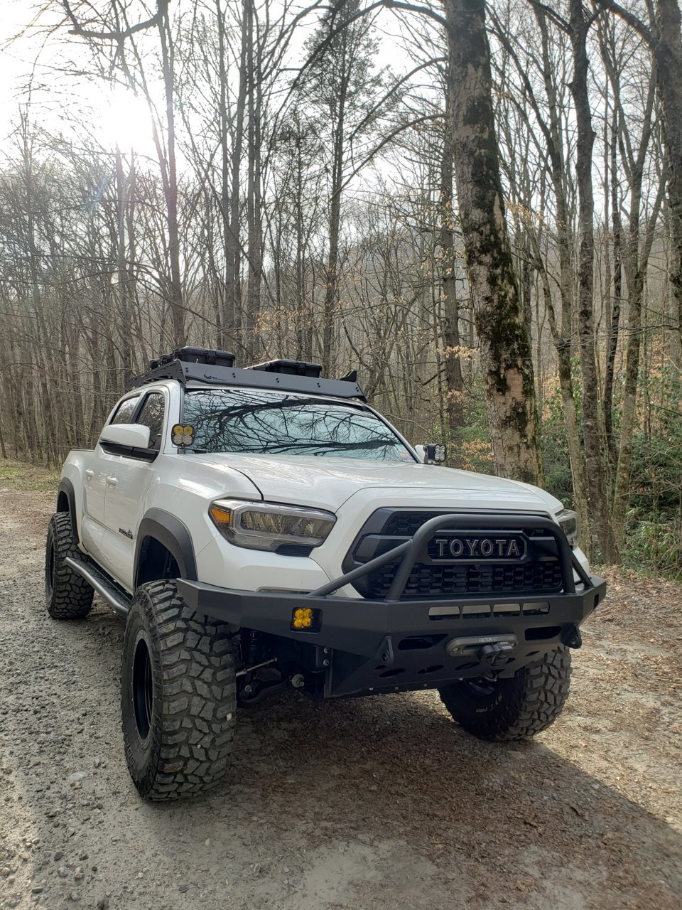

    UPDATED.
