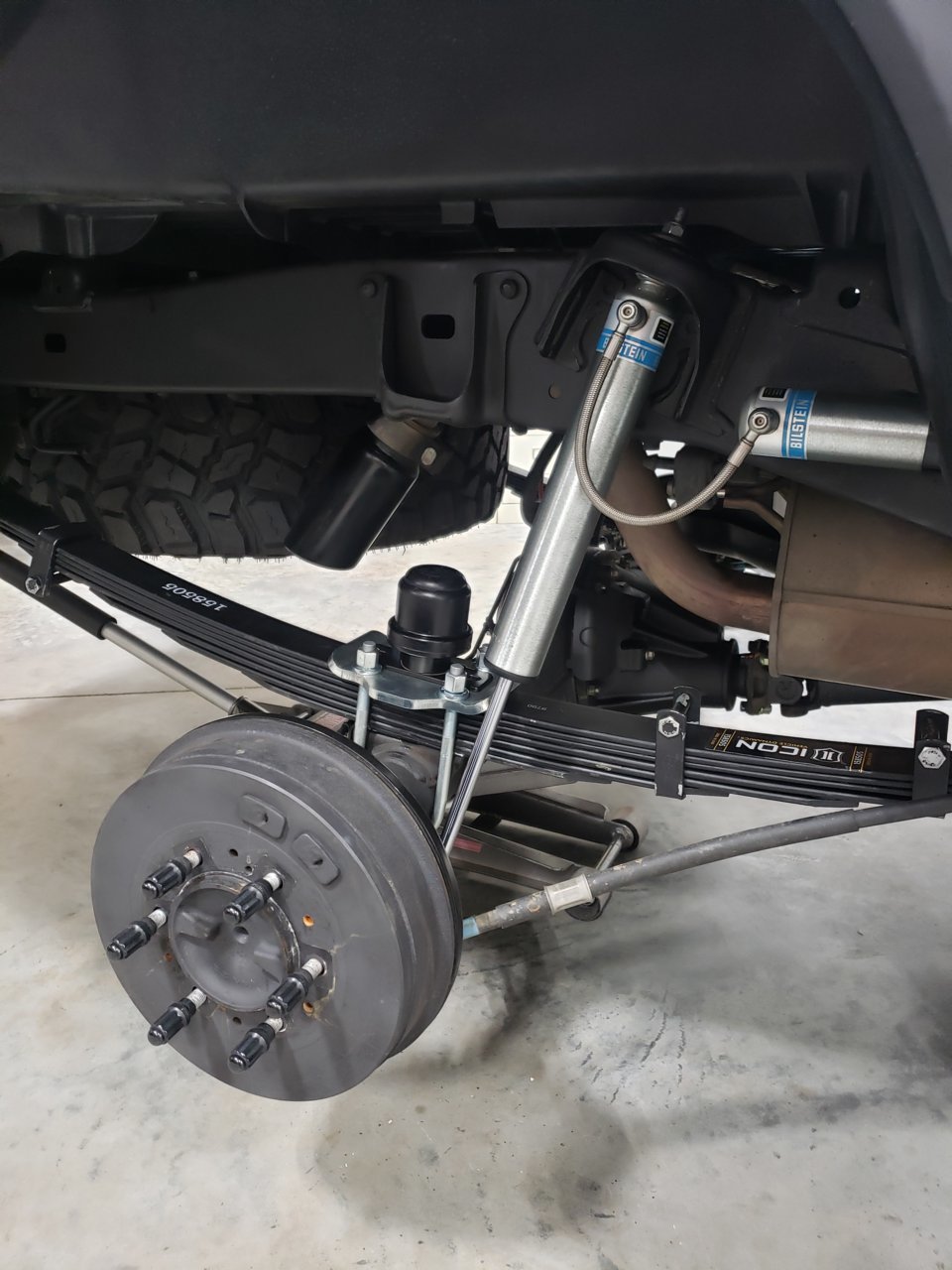

    Icon RXT leaf packed installed. So far pleased with the ride. Not much difference from the progressive AAL unloaded. Did not install the extra leaf. Hoping these will support the extra bed weight or trailer better

    Icon claims 1.875 of lift with the pack assembled as shipped. Granted I have around 200lbs extra weight in bed constant. I probably got 1.5". Which is perfect for my setup currently. They provide an extra leaf and depending where you place it, dictates ride height/weight capacity. They seem well built and heavy duty. Just wish they have poly bushings vs the pressed OEM style rubber.

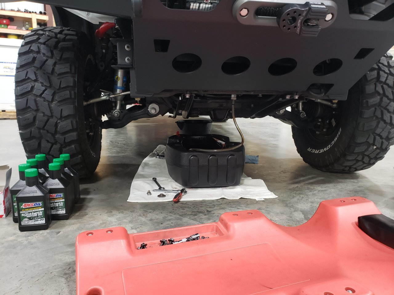

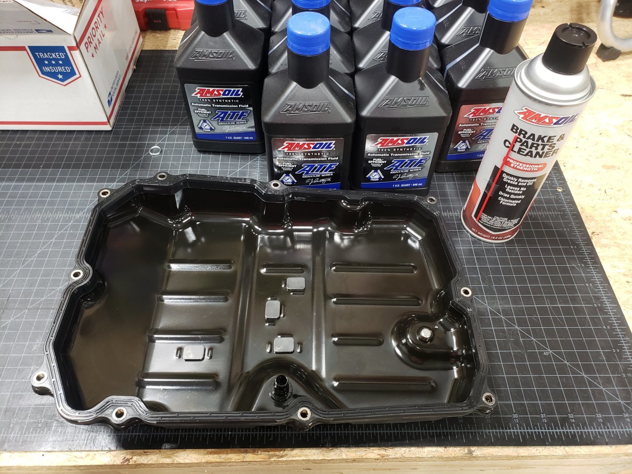

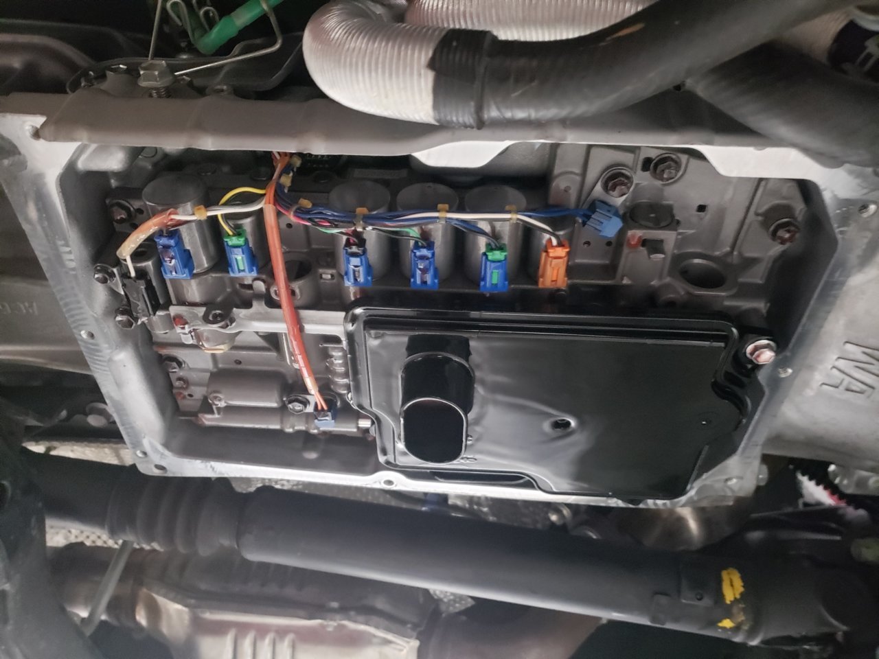

    Good Sunday catching up on maintenance. Trans flushed and oil change :cheers: Also got the core support bushings swapped out. Hopefully eliminate some noises...
