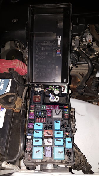

    I have a 2010 SR5, this is what my fuse box looks like, I noticed it's not the same as the OP any suggestions so I don't burn my taco down?
  9. Jul 30, 2016 at 9:19 AM
    #629
    ICBigMike
    ICBigMike Active Member
    Aug 20, 2015
    #162239
    41
    2015 Super White DCSB TRD Sport
    HID's, LED's, WeatherTech Floor mats, OEM Running Boards, Broadway Mirror, Tinted Front Windows
    Look on page 29, I believe that has the same fuse box as you. Good luck!
