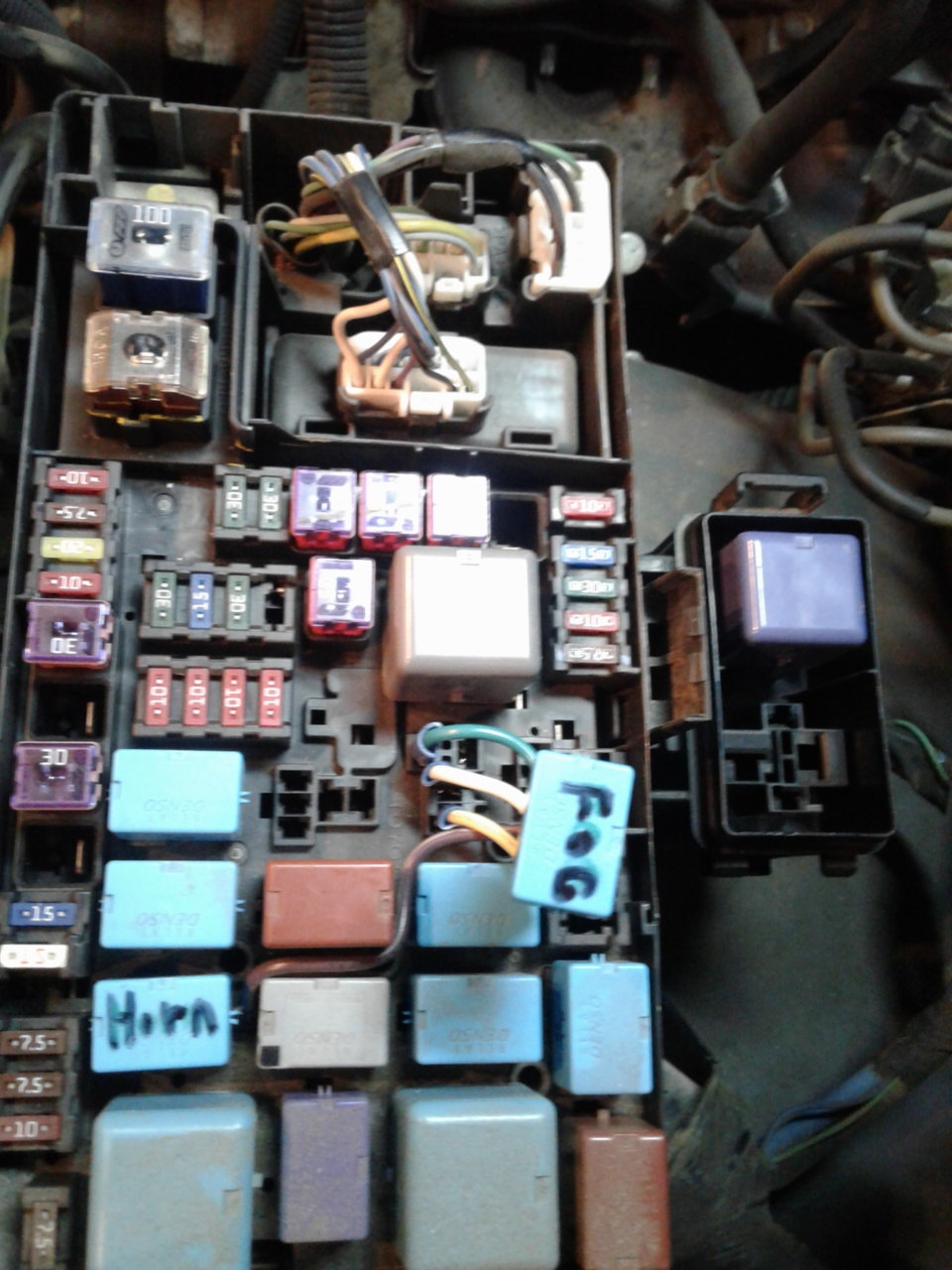

    I have a 2015 TRD OR and just tried this mod exactly as shown. However, it won't work. I used a volt meter to verify that I do have power off the brown wire - and I did check the continuity of all of the pig tail wires. Everything checks out, and when I undo everything and put it back together all works perfect. Any ideas why this will not work? Thank You
    UPDATE: I got it to work. I needed a heavier gauge wire. It seems like the thin wire was not enough to handled the current? Not sure, but now it works perfect.

    My 2010 TRD OR did not have the same co-located relay per the original post, and I was leery about using the EFI or any other potentially critical circuit. I used the horn relay instead, and the fog lights come on when the switch is pressed. Great for setting up camp without calling in the insects.

    AHHH Great IDEA using the horn relay. Id much more recommend that VS the EFI relay!

    The Horn circuit is not a "switched" circuit.

    ah, didnt know you could hit the horn without keys in.

    Is using 12 gauge wire bit of any over kill for everything? It’s all I had. Also do you you have to turn on the inverter for the lights to work?
