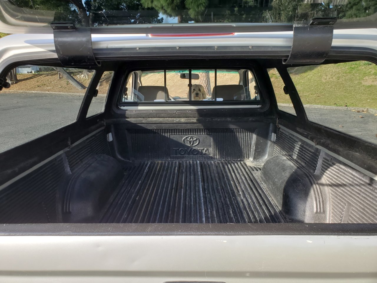

    If yours is and under the rail bed liner, it should work. Mine also has rail protectors for the top of the rail, but these were separate from liner.IMG_1226.jpg

    There's a pic w no liner, my weird cap inner diameter, and a type of clamp.
    Even if you had to cut it a little, a couple passes w a razor knife wouldnt be so bad
