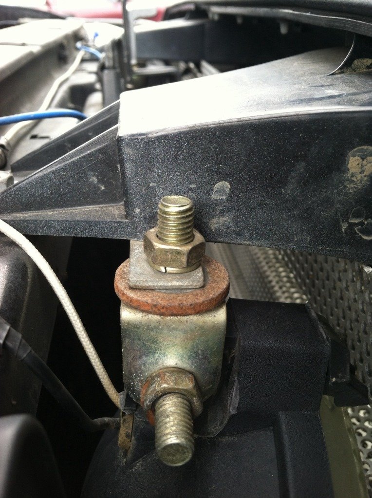

    Mine have held up fine.

    Not pretty but it works, seems to be my moto lately. :D

    Im trying to figure out how that piece of metal is even holding up...?
    I was going to just drill through that black plastic piece...

    I suppose you could go all the way through with a bolt. I just used some large diameter wood screws, tapped out the plastic and put two screws in each flat bracket. Been there almost 2 years no issues.

    Great thanks! since i have 2 6" bolts i might try to go all the way through, itll be adjustable and then i can cut the extra off.

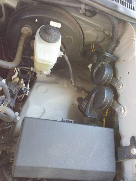

    just wondering if theres a problem with placing the horn at this spot behnd the battery?
    There were two holes and the wire was long enough to make it....

    No problem, just your horn may be louder to you than the vehicle in front of you. I mounted mine in front of battery and behind the headlight since i am mounting a fuse panel in your location.

    Yea i just changed them back to the front but behind the bottom bumper. Sound will stay the same this way, thanks!
