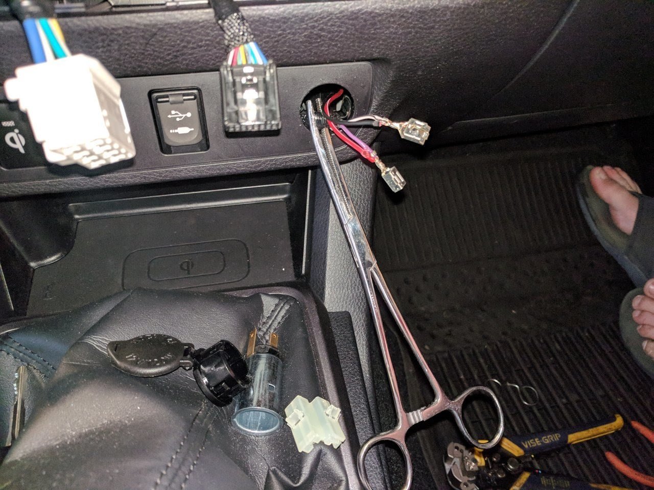

    The power port worked for me.

    Outstanding..... Now, how do I get that open like that ???

    Looking inside the power port, you will see a square black tab on the bottom. There is a similar one on the top. Push both outward just a bit and pull the metal barrel toward you.
    From there, you can slide off the connector. The plastic cover will then pull out toward you also.
    The connector is easy to take apart, as seen in the pic. Pry open the two, small doors and release the small spring clip on the spades.
    It all goes back together like butta.
