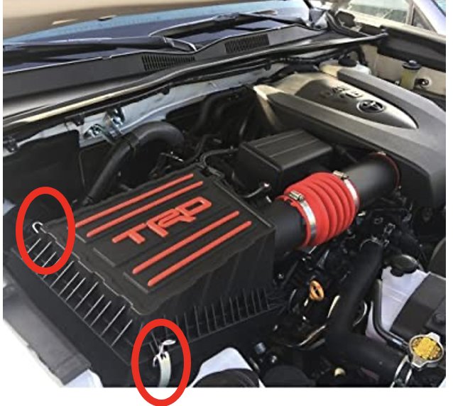

    Does anyone have the OEM clips that hold the air filter box together for a 2019 Tacoma (SR5 V6 engine) (see the outlined clips in the attached photo)? Long story short - I bought my Tacoma in Oregon and it has a nice K&N aftermarket air intake system, but unfortunately it is not a compliant system in CA (where I am trying to register the vehicle). Toyota stopped selling these as independent parts for the 3rd gen. Hoping someone has replaced their OEM system and still has the clips. If so, please let me know if you will sell them to me.

    Nope. Mine are on the truck. The TRD kit makes you re use the factory clips too.

    Yep - Wish that had been clear to me before I bought the TRD kit. Thanks guys. Hopefully someone else purchased a different aftermarket system and doesn't need the clips.

    Those look like pretty standard issue hardware. Check online or a hardware wholesale might just help.

    Thanks @STOCKTRD - I am hesitant to buy those because they say they only fit up to model year 2011. It is a little tough to see the details on those clamps, but they don't look like the same ones on the 2019 (at least to me). I may just have to buy them and find out.

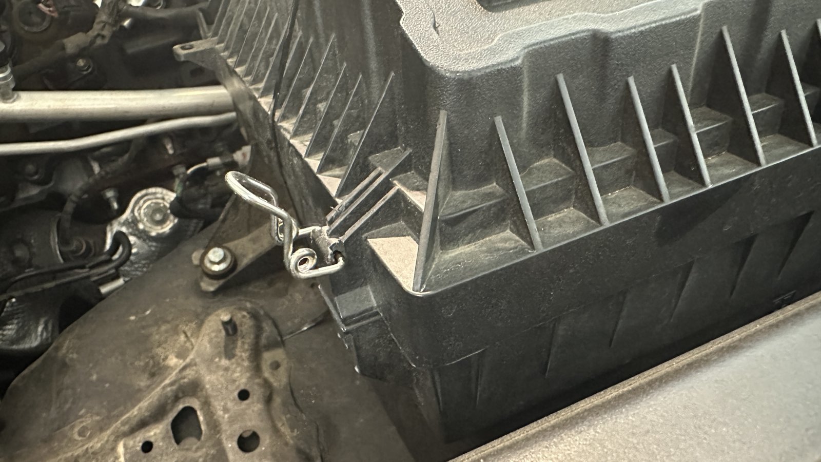

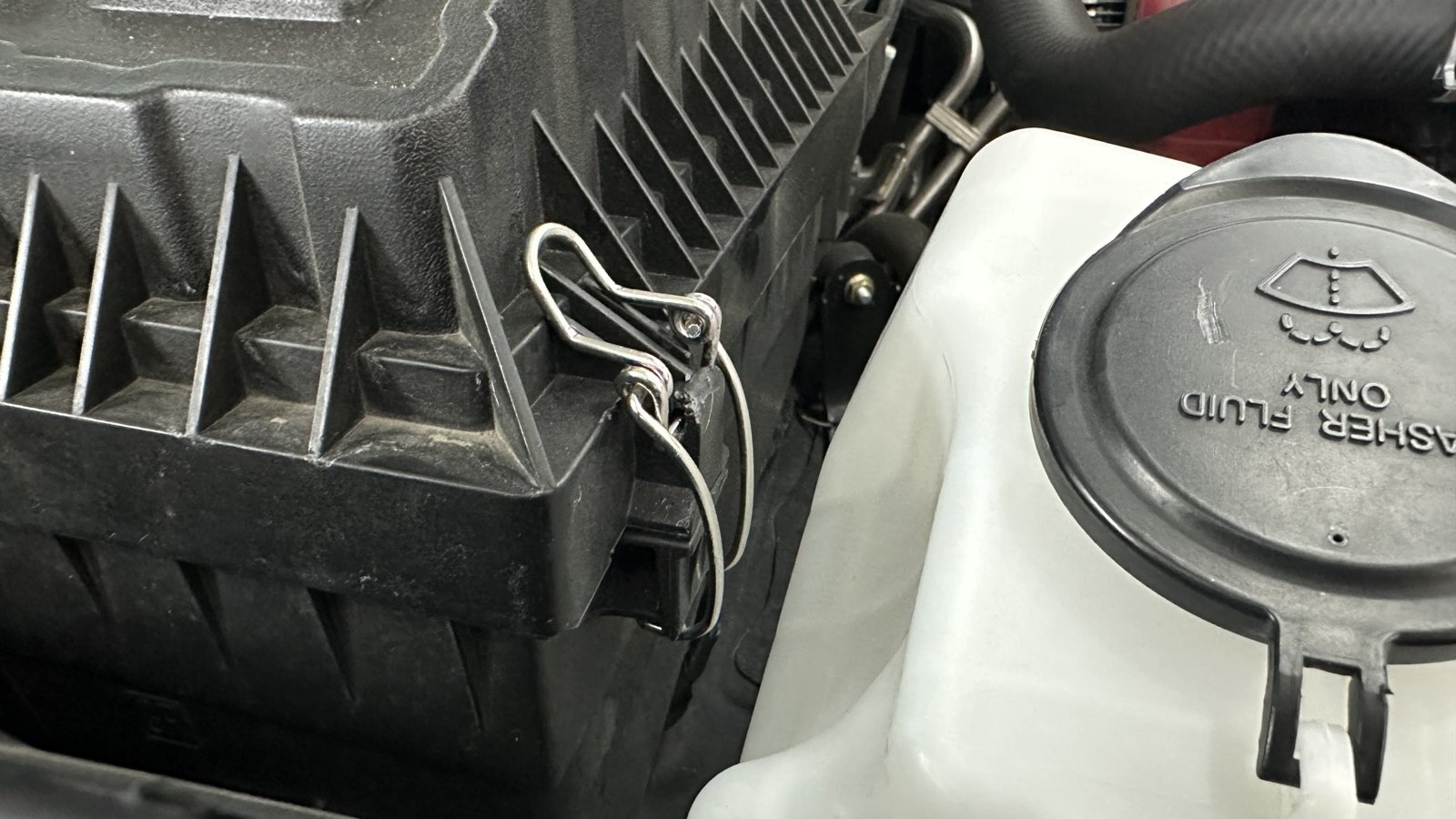

    so I know this is incredibly late, but anyone else who reaches this thread in the future with this same problem, I have a solution. I bought some Polaris(the side by side manufacture) airbox clips and they work. There is some massaging needed because these clips are a tad small, but with pliers and some unbending, they will work. Polaris Part#7081872
