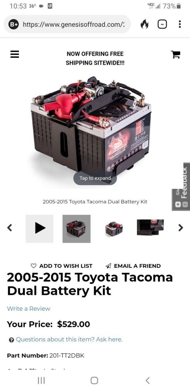

    Bumping this up...may spend the money on this genesis setup, looks easy for a dummy like me.
    Still looking for idea for switch/outlet panels that can be mounted in the bed, maybe in that removable cover aft of the wheel well

    how much does that weigh? I've read about damage to the factory battery location from the weight of the battery and offroading. the battery can tear the body at the mounting holes. just something to consider.

    Not a clue. Open to other ideas, on my LC, the spare battery was mounted on the opposite side of the engine bay.
    Where do folks typically mount the 2nd batt on a tacoma?
