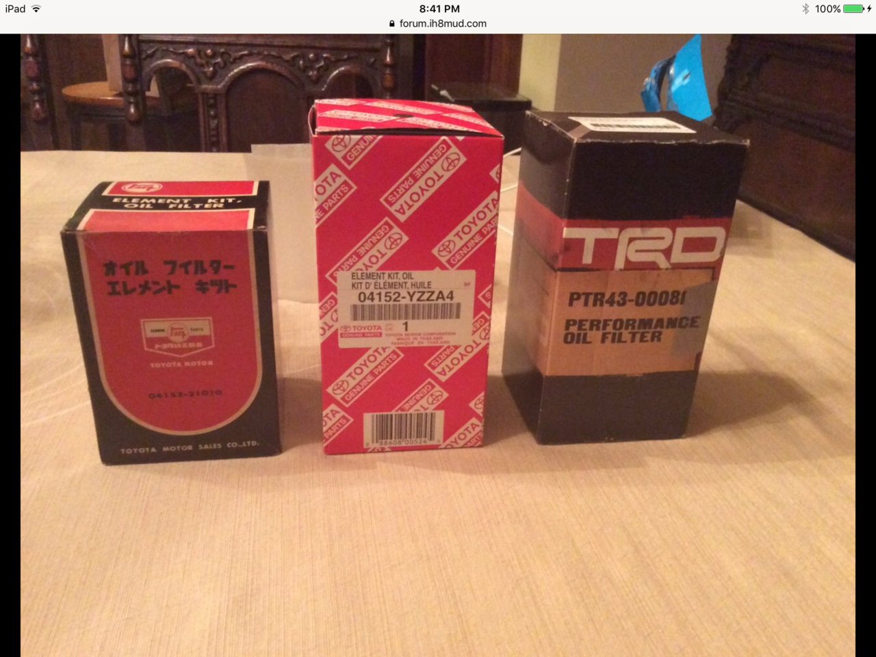

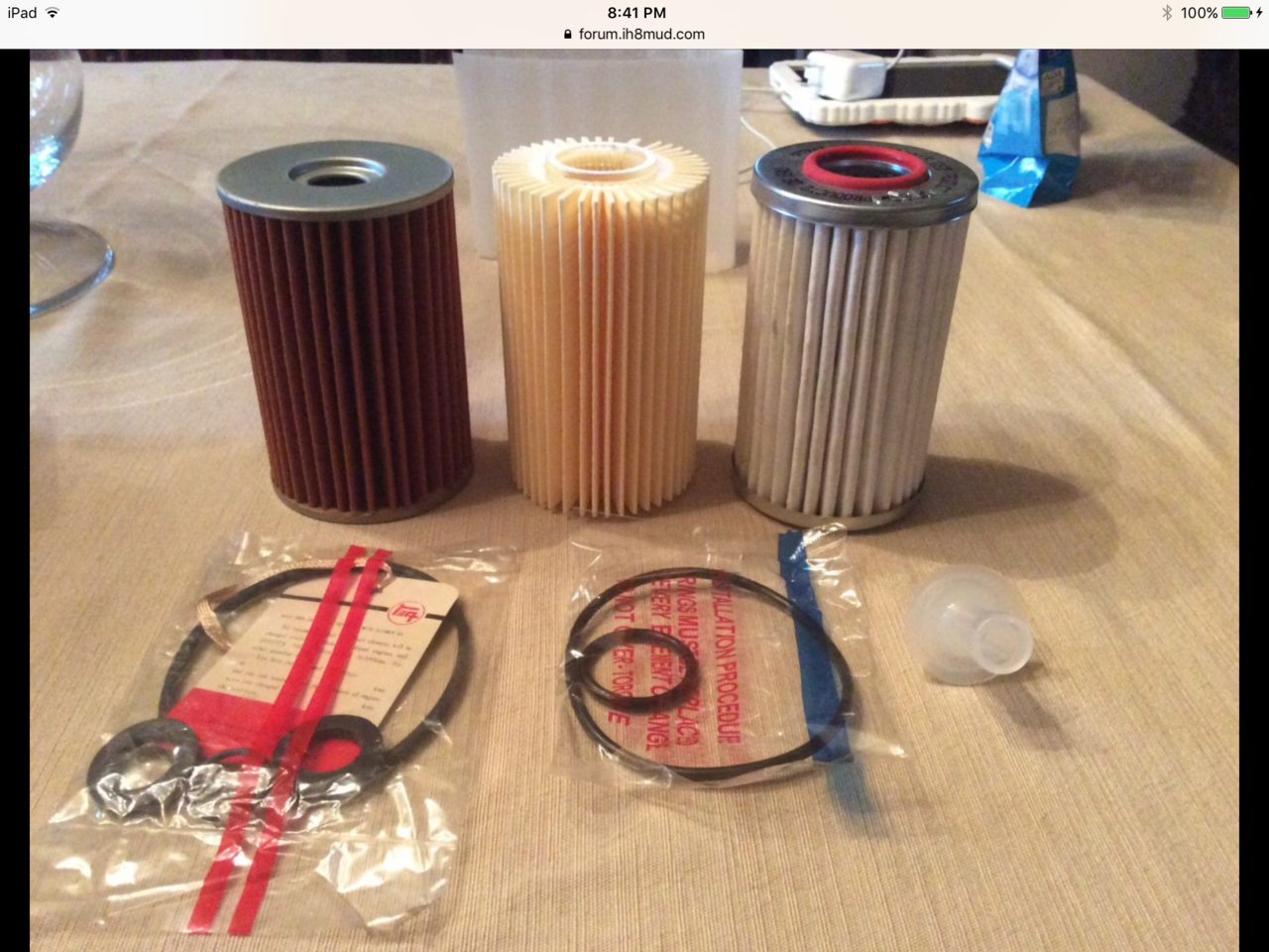

    The cartridge system is excellent, but the plastic cap was designed with a nod towards causing issues for the careless or unfamiliar. Toyota has dabbled with this type of system many times over the years. Here's a vintage early 60's Stout 3R filter next to a couple 3UR V8 filters.
