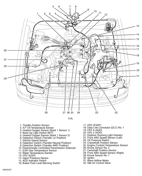

    just like title says looking for someone that could reference the ignitor's location for me. as i need to find the ignitor wire to hook up my remote start.

    It's number 30 on the list. Hope this helps.

    lookin in the manual right now and it says"the igniter on breakerless ignition systems is a separete component from the distributor and is mounted on the right side of the engine compartment under the air intake on four cylinder engines or in the left side of the engine compartment together with the ignition coil on 3.0L v6 engines.
