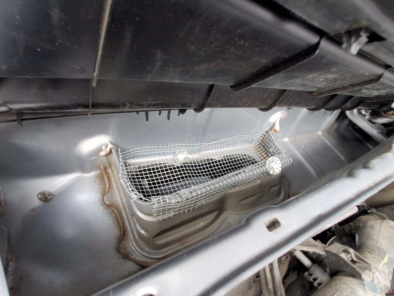

    Out of nowhere I smelt urine, guessing from the cabin filter. So, I swapped out the cabin filter. IT had some debry in it, not much. I didn't do the do the smell test. Then, for security I added 1/4" galvanized hardware cloth (chicken wire) to the open access port.
    The smells gone and I have a little piece of mind that no vermin will be getting too close to my cabin filter.
    My solution:20201128_133125.jpg
