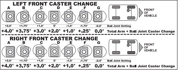

    Upper ball joint should be set to "E" or "F" position and the stock LCA cam bolts set to max caster (front cam all the way in, rear cams all the way out).
    What exact tire size and wheel model are you running? This has a big influence on rubbing. Wider tire will rub more. Wheels with more negative offset will rub more.

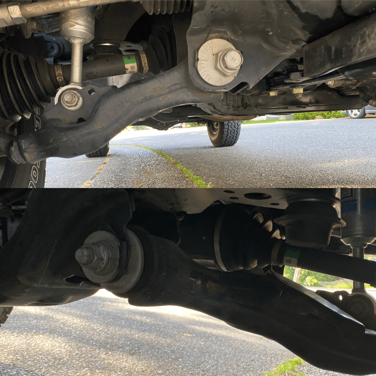

    Yup lower cams will get you 90% there, If I recall you want tabs out in the front and in in the rear. Leave the camber for the alignment shop and set the SPCs to what you want initially. When my alignment was perfect I sat around 3.5 caster but everytime I wheel I throw my alignment so I stopped caring

    Like this. Then adjust your upper ball joint.

    Moving the front cam will greatly affect toe, because the front cam is in the plane of the steering rack. If you adjust the lower cams, be sure to straighten out the toe with a fishing line setup before attempting to set the camber with the slot on the SPC arm. You can set camber fairly easily with a digital level against the wheel. Be sure to park on a level surface first.

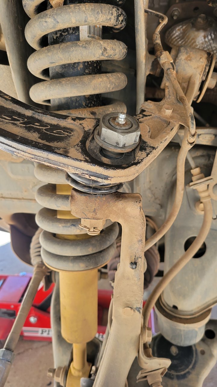

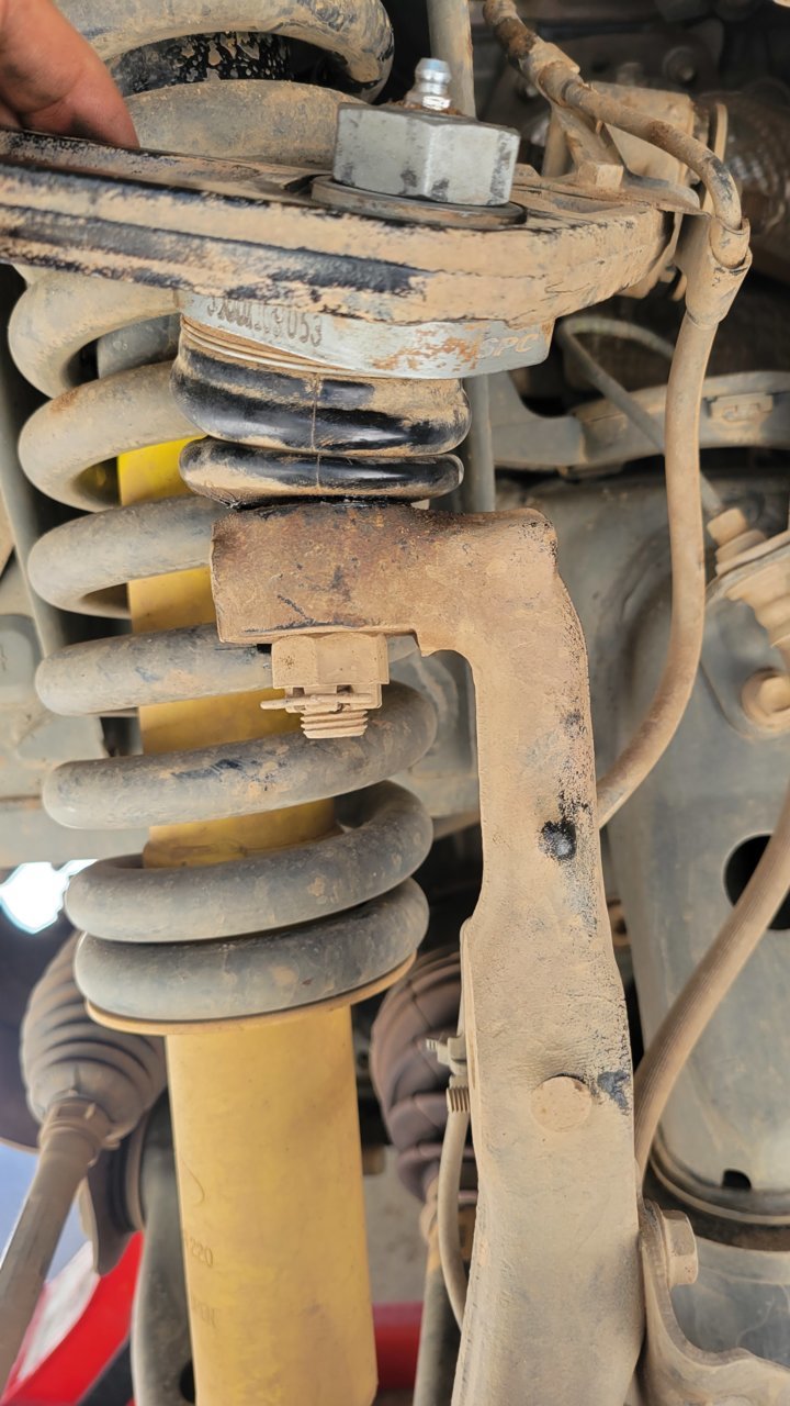

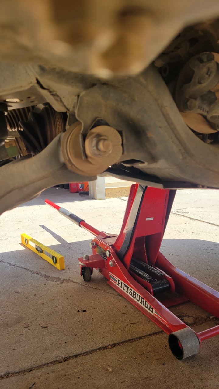

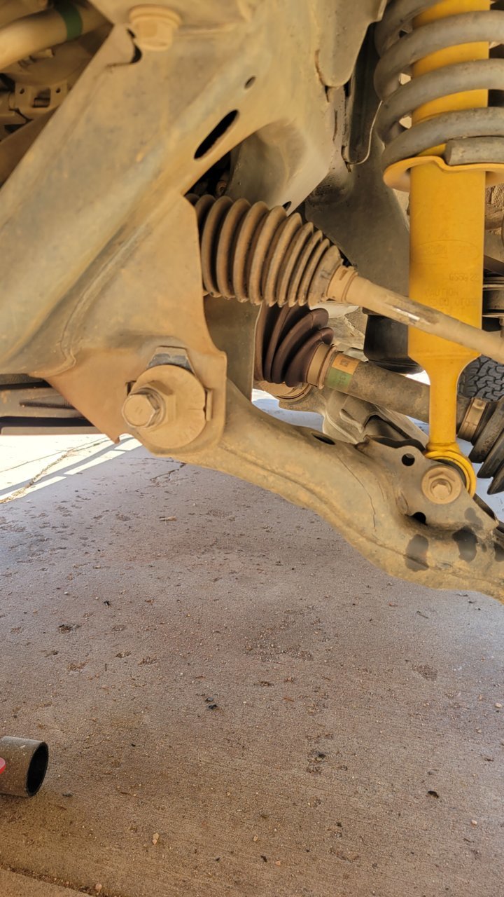

    Ok, so I set my LCA bolts like yours in the pic, which moved the wheel forward, but it also moved the wheel into the wheel well a bit. I then had to move the camber slot on the SPC UCA inwards because it was leaning way out at the top, and now after moving that upper camber adustment inwards I'm rubbing on the UCA at full lock. This is with the 'f' setting on the SPC.
    Can someone with SPC uppers tell me what setting you used for the upper caster? How can I clear the UCA?

    1. Set SPC upper ball joint to "E" or "F" position.
    2. Adjust toe to 0 before camber, because incorrect toe will screw with your camber setting.
    3. Set camber to 0 with the SPC slot.

    Ok, I dunno what's going on but these settings do not even come close to working on my truck. I think its the LCA adjustment positions I was given that are screwing this up. Even with the SPC camber slot set all the way inward I can't get the tires to be straight up and down. But I couldn't run it there anyways because it rubs on my coilover and UCA. Tried both the E and F positions. Unless I'm reading the SPC chart wrong?
    These pictures are all from the driver side.
