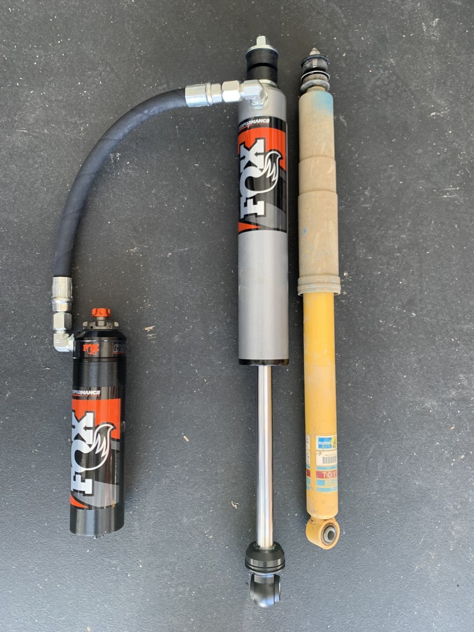

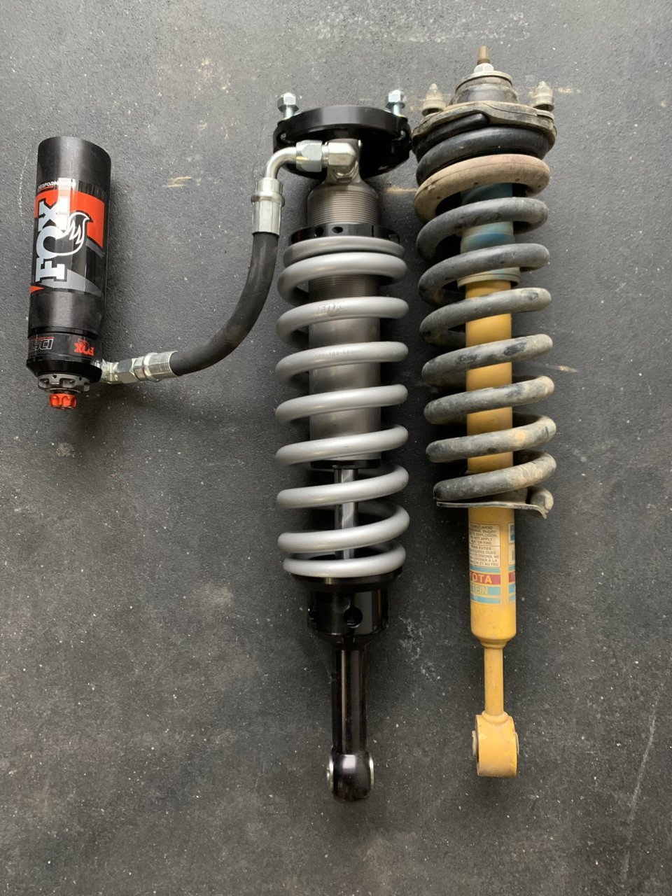

    I finally pulled the trigger. Installed my Fox 2.5 Performance Elites last weekend. Haven't driven it much yet but rides good so far. Need to get an alignment.

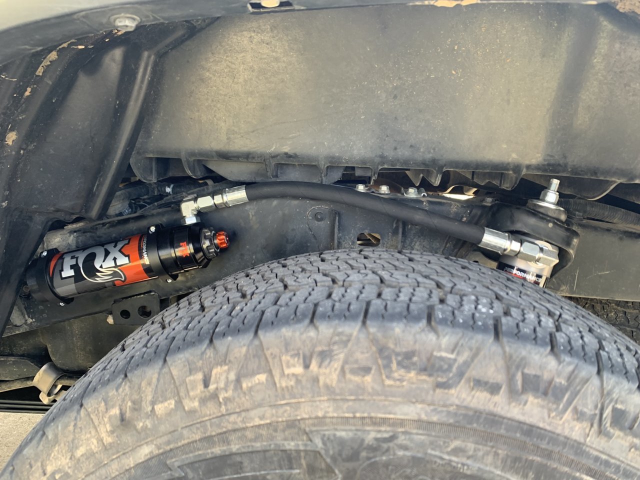

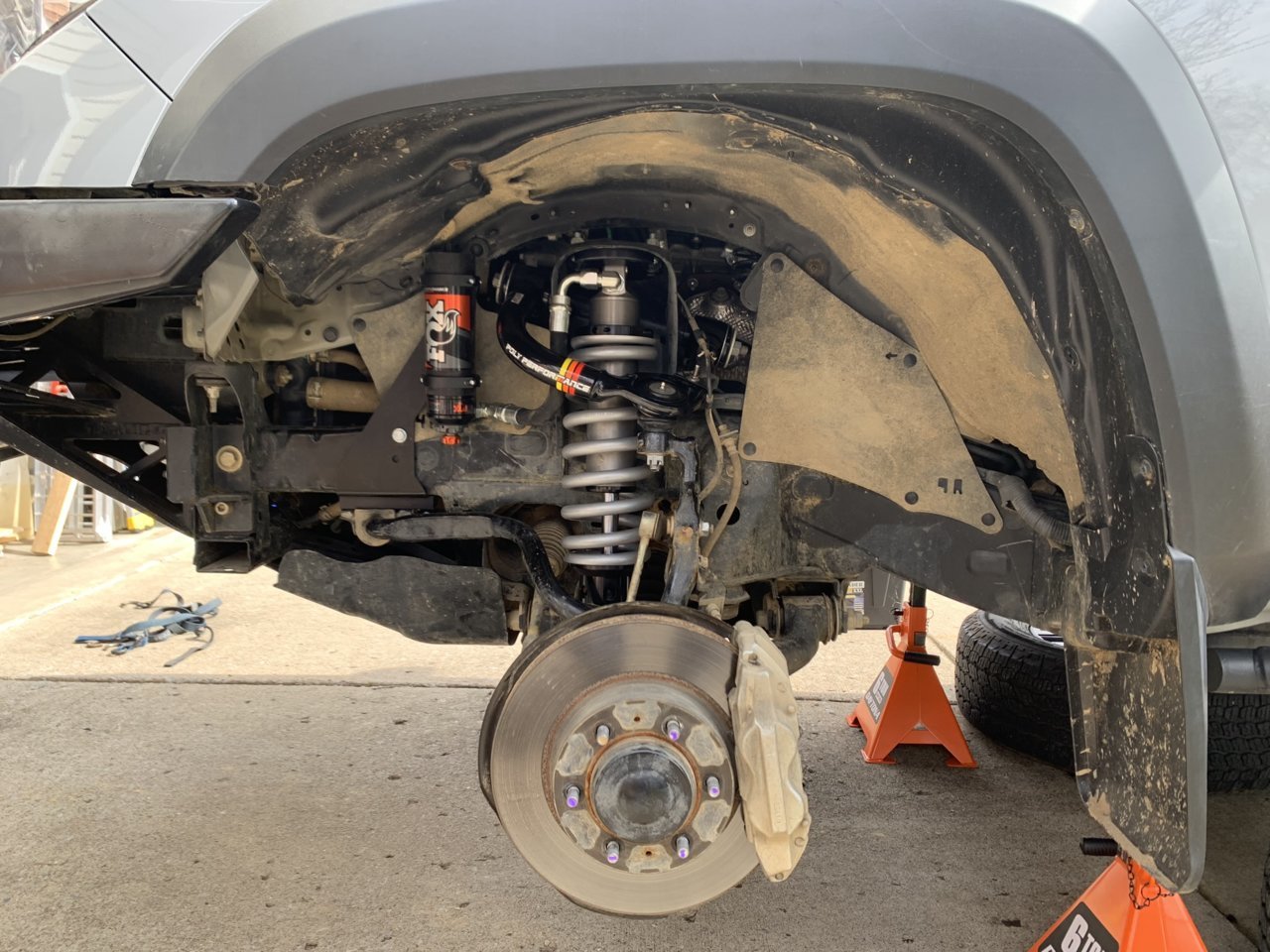

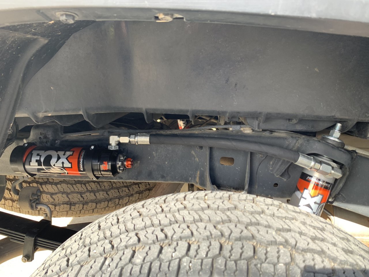

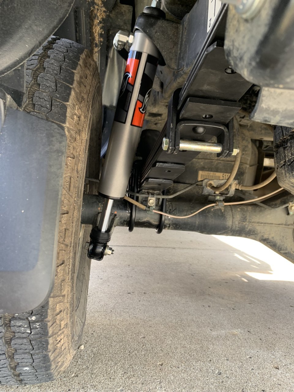

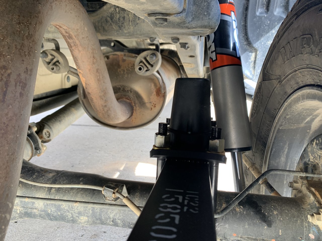

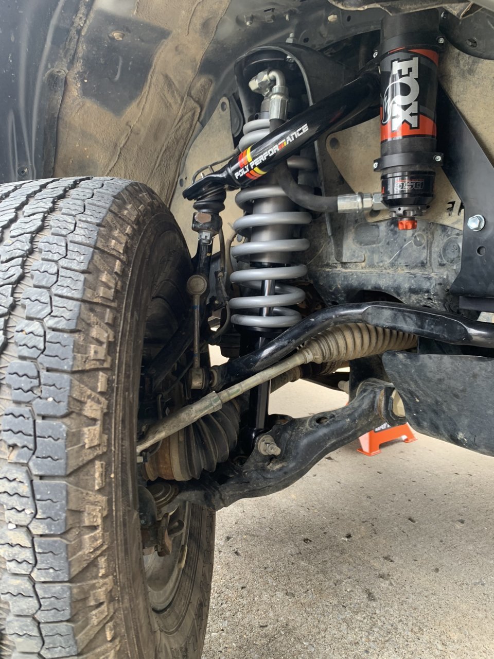

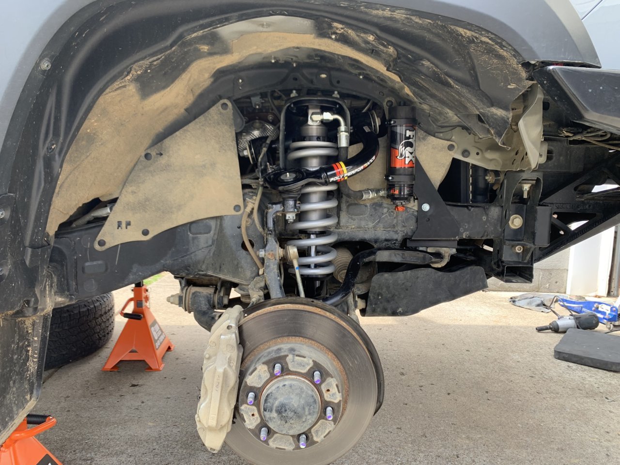

    Here are some pictures of my install.
    DC7E6516-2CAC-4424-9879-25EE95F00F1D.jpg IMG_3102.jpg IMG_3100.jpg IMG_3109.jpg IMG_2940.jpg IMG_2941.jpg IMG_2836.jpg IMG_3051.jpg IMG_2947.jpg IMG_2945.jpg
  15. Mar 15, 2023 at 11:08 AM
    Bishop84
    Bishop84 Well-Known Member
    Dec 17, 2015
    #172494
    10,503
    Sick!!
    is the tie rod hitting the sway bar? Hard to tell in the photo
    MGMDesertTaco likes this.

  17. Mar 15, 2023 at 11:12 AM
    #17
    BugJuice
    BugJuice [OP] Well-Known Member
    Nov 19, 2021
    #382536
    86
    No, but very close. The other side is even worse... Not sure what to do about that yet.
    I'm waiting till I get my tires delivered before I align my truck.
