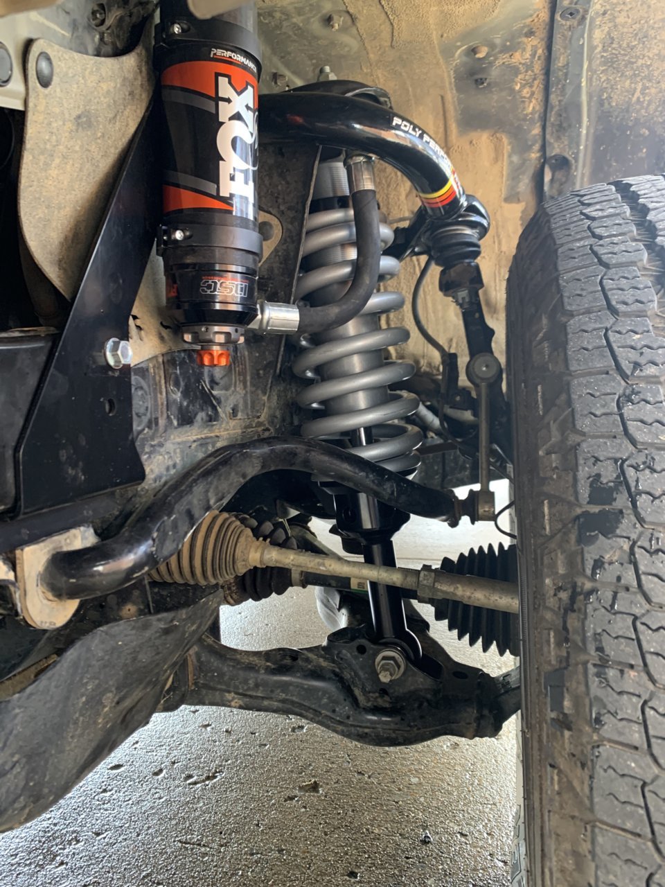

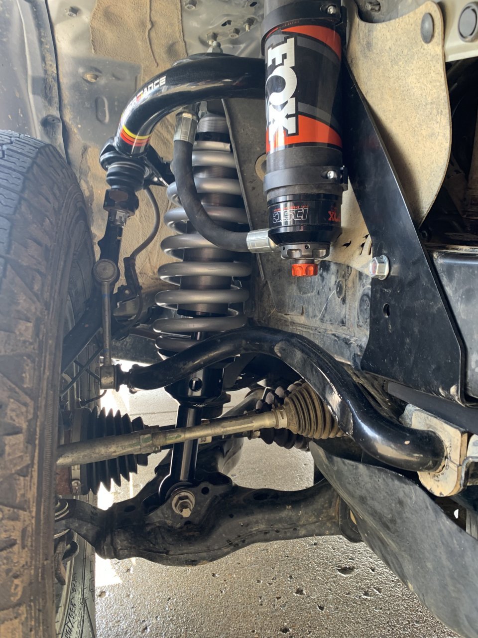

    Yes, the sway bar spacer is installed. If you look at the prior pictures you can see it. It's the black spacer block where the resi mount is. Keep in mind this is at full droop. When the truck is sitting on its own weight it looks like this.

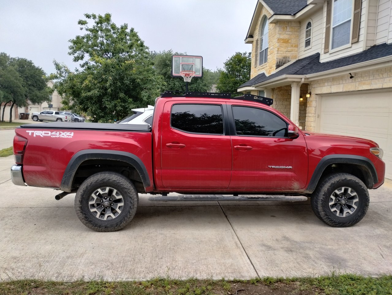

    6112s up front with 1/4" top hat spacer and 5100s rear with a 1"block. 265/75/16s. I really just wanted new shocks since I had 60k miles on the stock TRD OR suspension. No complaints, feels great and gets me down to the good fishing spots

    So what are your measurements from axle to fender now? THANKS!

    Like around 22" front and 23.5" rear. Driver side front is just a little lower than 22 and passenger is slightly more. Not nearly enough for me to care about
