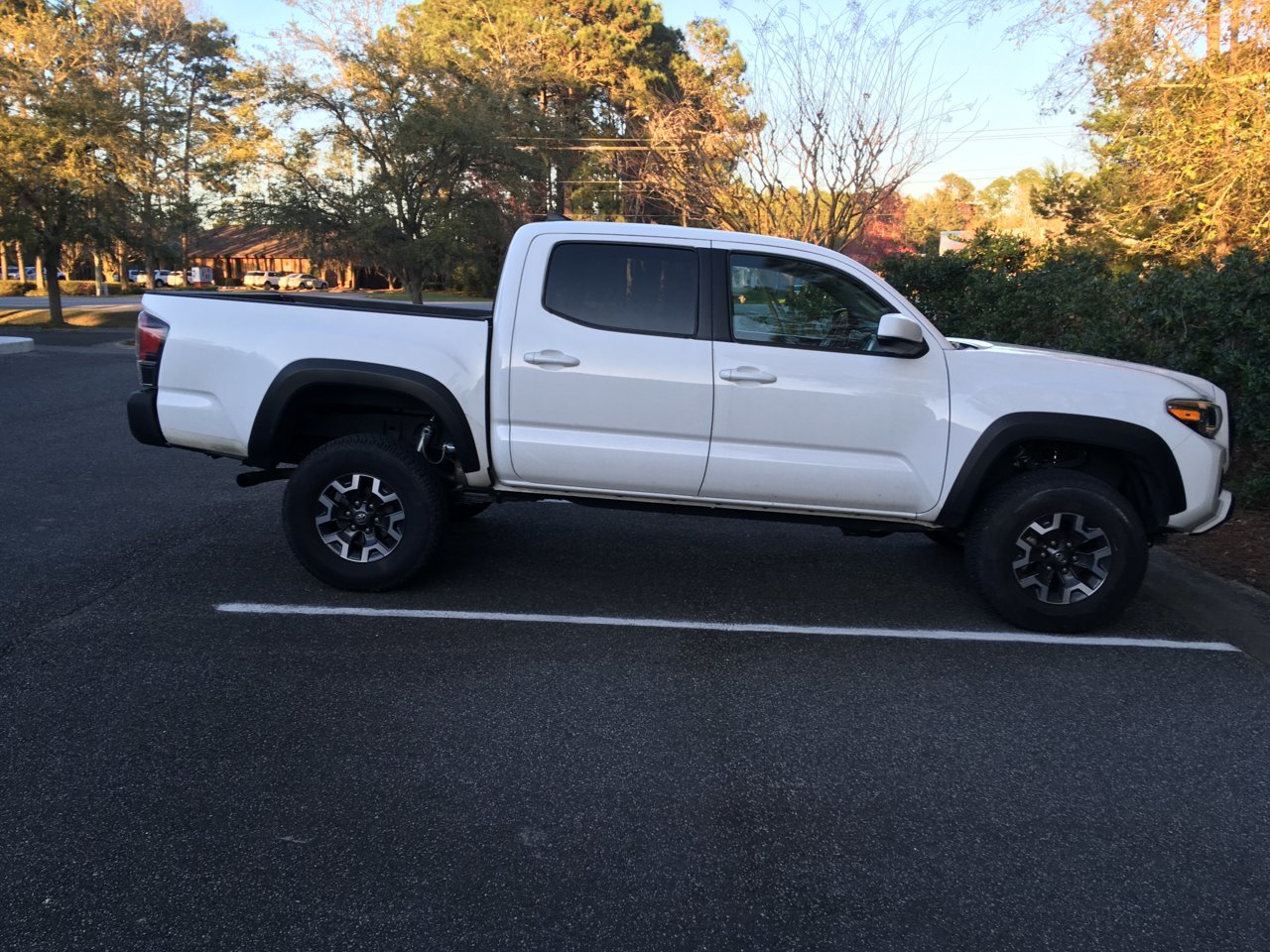

    I have 6112/5160 combo, but front left at stock height. The ride is excellent for over 2 years.
    I wanted more bed capacity and put Deaver Exp stage 1 springs in rear. I had no clue what 2 inch lift really brings. With empty bed, it measures close to max 5160 travel and I had mid 20 mph vibration. With load of 400lb, no vibration at all as bed to ground sunk about 3/4 inch. The Deavers ride very nice but I didn’t want to shim. I put less lift Icon springs on and have no vibration.
    I’ve got a set of Deaver stage1 with a thousand miles on ‘‘em if you want to raise that rear. :)

    Deavers rear, stock height front:
