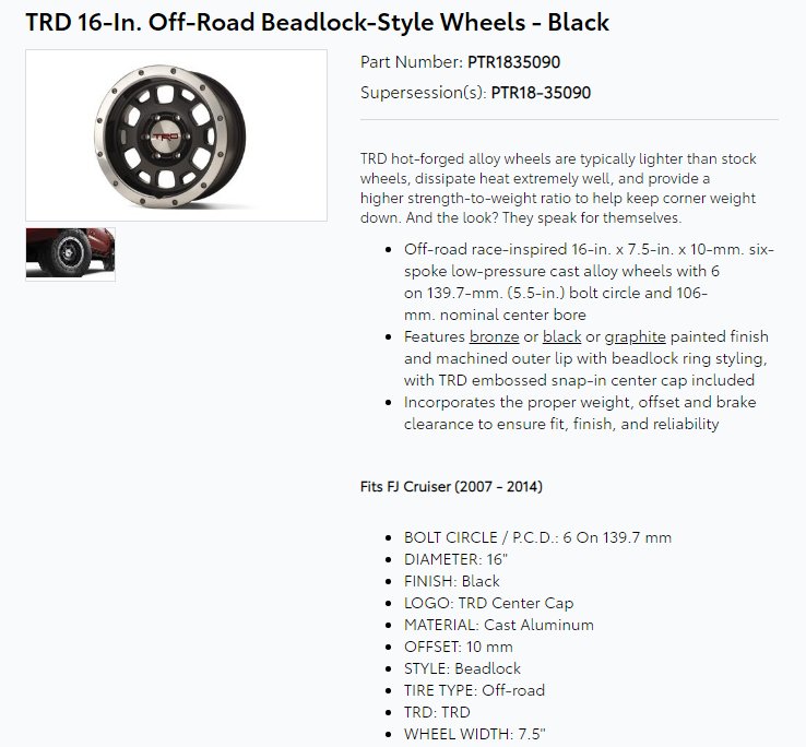

    Hello all,
    I'm currently stuck trying to find the correct lug nuts for a replacement set of TRD Baja Wheels (PTR18-35090-BR).
    I initially bought the recommended Toyota TRD lug nuts (PTR27-35100) for the set, but was told that they only got 4 turns on the stud and that was not enough to be secure. I ended up using the lug nuts that the shop recommended but long story short; they were too wide for the lug holes and essentially mushroomed the wheels into the studs. I had to take them to another shop to get them taken off and my studs replaced. :annoyed:
    I have seen many users here running these wheels on their 3rd gens so I would think that my 2020 should be no different. Can anyone shed some light on the lug nuts they used for this set up and if it got enough turns to secure it to the truck (I think the recommendation from the shop was 6-7 turns)?

    Thanks for looking that up. I did find that spec too and those are the ones I originally purchased, but for some reason they only got 4 full turns on the stud so the shop said they were not safe to use. That is why this is all so confusing to me. I'm starting to wonder if somehow my studs are shorter than they should be?

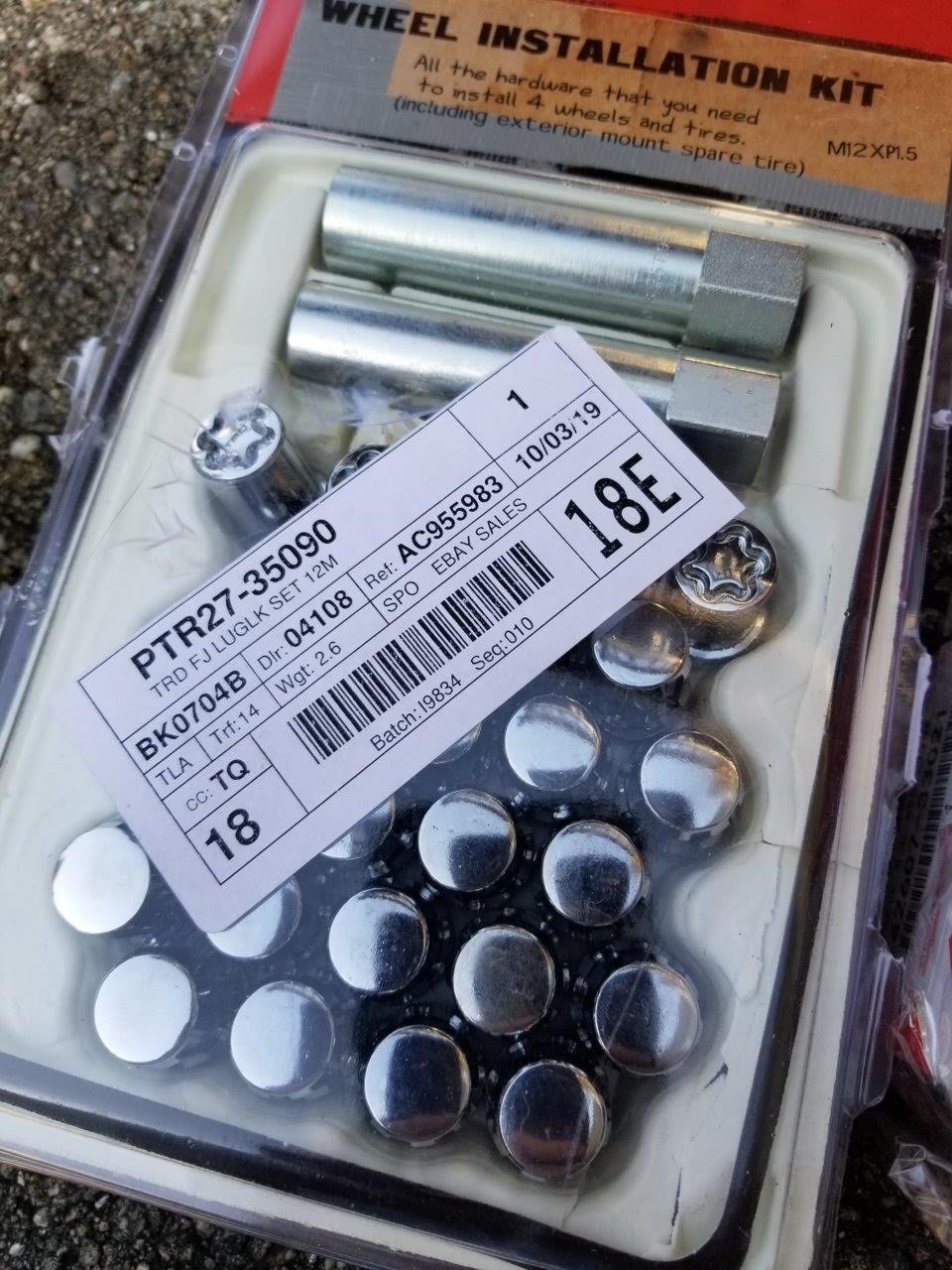

    Thanks for tagging them, I have actually messaged @RobP62 in the past to see what he is running but they seem to be the same exact ones as the PTR27-35100 trd lugs. I guess I should ask him how many turns he gets with those lugs if he even remembers.

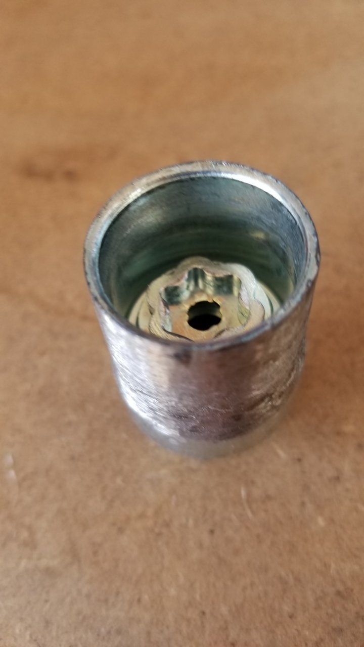

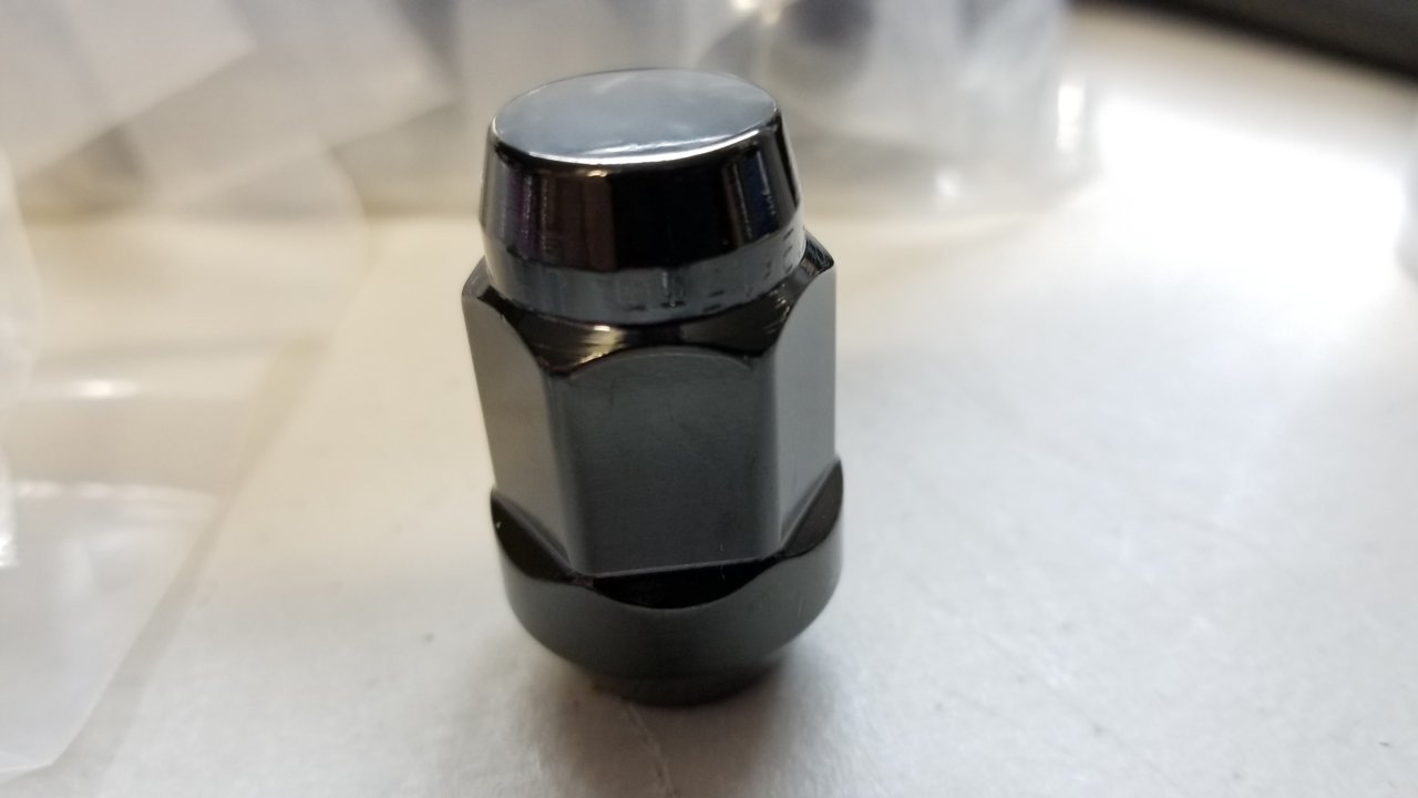

    I'm running McGard black chrome acorn style and their locks. The locks come with a key (socket) that I had to grind down to get it to fit in the wheel holes.
    These are what I bought
    https://www.amazon.com/dp/B000COS0H4/ref=cm_sw_r_cp_apa_i_-LKJFb2B6EBPB
    https://www.amazon.com/dp/B00DIX1PNC/ref=cm_sw_r_cp_apa_i_HLKJFbM2TYX6V
    This is what @Unchained 5150 used
    I know for a fact I get more than 4 full rotations of the lug nuts.

    Thanks for the pictures, definitely helps! I'll definitely be trying these out. Weird how they have an FJ lug set and a Tacoma lug set but according to your post @Unchained 5150 was able to use the FJ ones.

    Well, because they are interchangeable, and because these wheels were OEM on the 2007 - 2014 FJ Cruiser.

    Are those the same lugs as the pic I posted that you sent me when I bought your wheels Rick?

    Yes I didn't even catch it that that pic was actually from my wall.

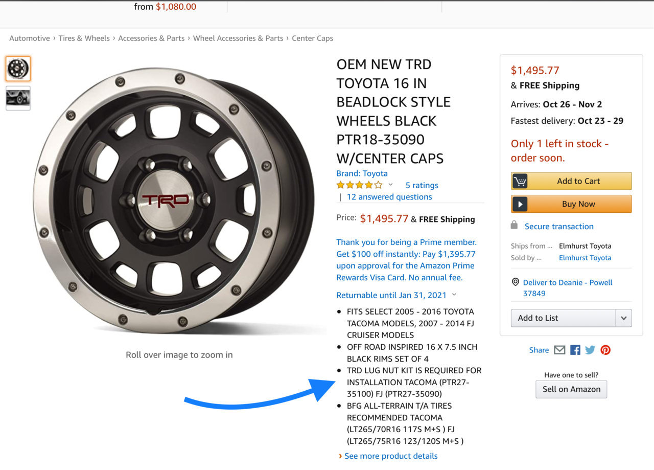

    This is a great example of the three main types of lug nuts.
    Page 1 of this document lists the part Toyota part number for the lug nuts required for these wheels.
    http://toyotaparts.sparkstoyota.com/install/PTR18-35090-BRinst.pdf
    Under "Additional Items Required For Installation"
    P/N PTR27-35100 (I believe this is what @Unchained 5150 posted above) which if you don't care they are chrome, these are laser engraved which is nice.
    https://parts.toyota.com/p/Toyota__Tacoma/TRD-Wheel-Installation-Kit/69529139/PTR2735100.html
