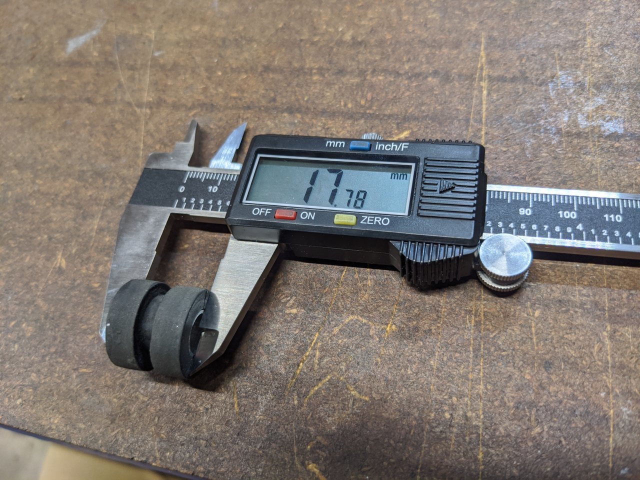

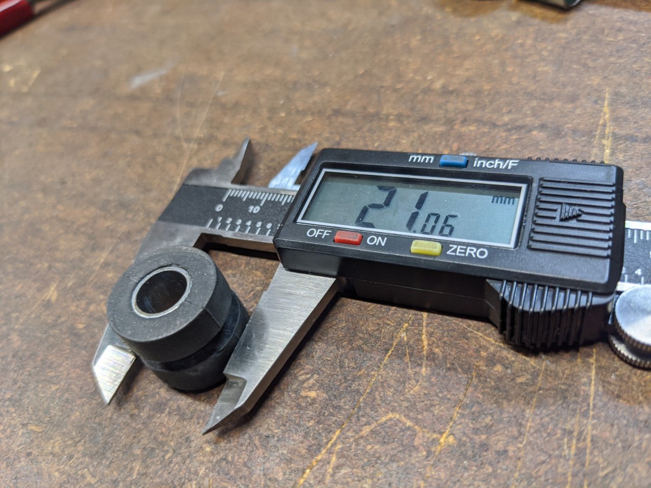

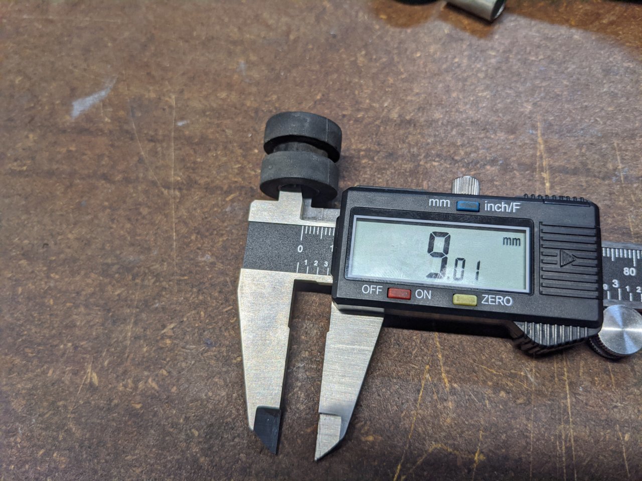

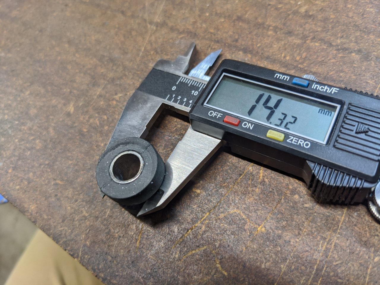

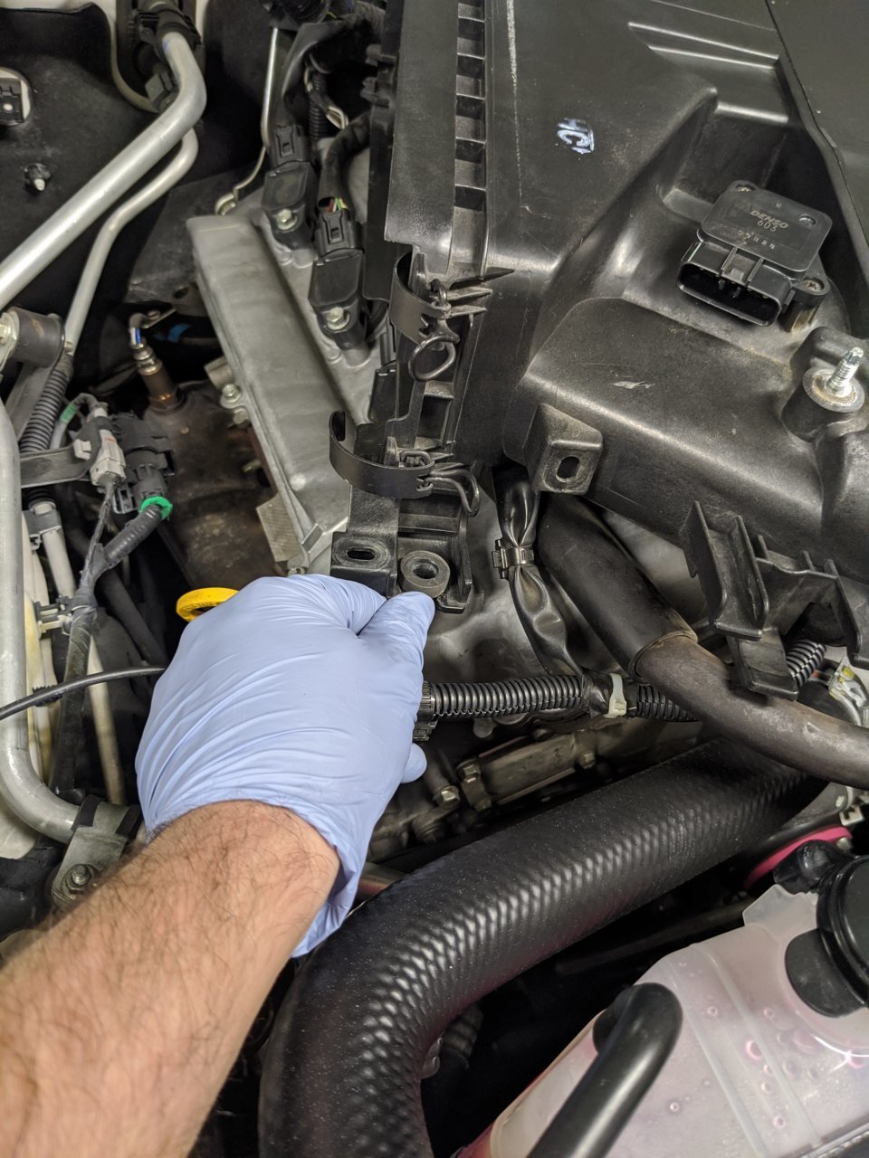

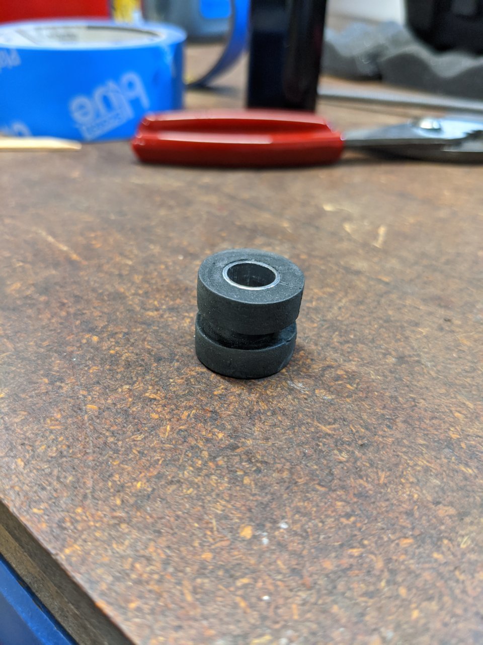

    2010 air box that sits on top of the engine. Two 10mm bolts hold the box on through a sleeved rubber grommet. One of the grommets got destroyed due to a seized bolt so I need a replacement. I couldn't find anything on OEM fische. Anyone able to help me locate this part?

    Update:
    -Toyota said I have to buy the whole air intake assembly
    -NAPA couldn't find the part
    -No Tacoma's in local junkyards
    If anyone is parting a truck out or have an air box lying around, let me know and maybe we can work something out.

    Yup, got a couple grommets stacked for the interim. It doesn't secure it as well since the attaceny point is an open crescent shaped hole and it can still slide out. Good enough for the time being though. Thanks!

    I was able to rig something up for the time being. Thanks @GHOST SHIP, sure enough there was a rubber grommet in the plumbing section as part of a kit. It's smaller but has the same inner diameter.
