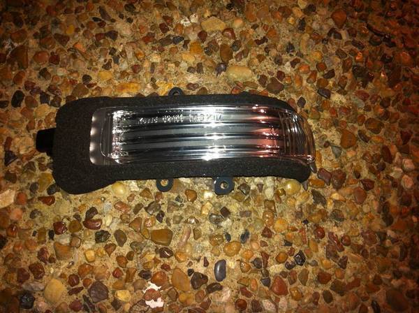

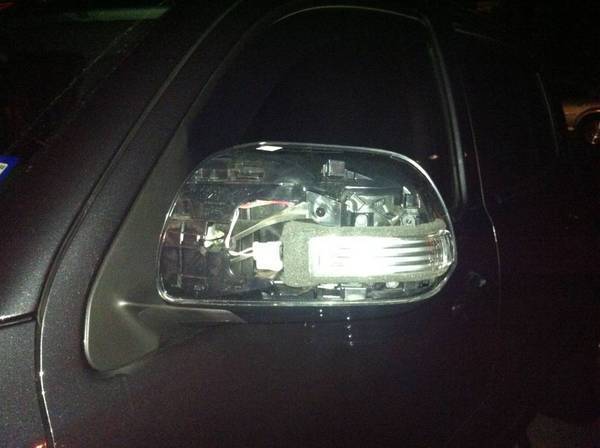

    Yep. this is the answer.
    And to answer the OP's question, you cannot change the bulbs. Once you pop of the painted piece cover on the front side of the mirror, there are two screws that remove the clear lens piece that has the LED's housed in it and a wire plug running to it. THERE IS NO WAY TO CHANGE THE BULBS, they are completely encased in the clear piece. You can only unplug and unmount the clear piece but that is all. Works great for me because I just want to smoke out these pieces with a smoke film.
    PAINTED PLASTIC PIECE REMOVED (by popping it off)
    CLEAR BLINKER PIECE REMOVED
    NO WAY TO CHANGE BULBS, ONLY A PLUG THERE
