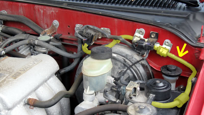

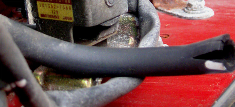

    I have a hose under the hood that I need to replace as one end is frayed and will not stay on permanently. First image below it is highlighted in yellow (connects to something with the vacuum?). Just need to know what its called in order to get a replacement. 2nd picture is just a closeup of the end of the hose.

    I cant remember what thats called, but you can take it to a hardware, or auto parts store, and match the hose up with a replacement.

    X2, if you go to the dealer and buy that exact hose you will get shafted. Just go to your local auto parts store and match the i.d. and length and get them to cut it for you. They usually have rolls of hose in the back and charge by length...

    That's your charcoal canister to VSV for EGR connector hose.
